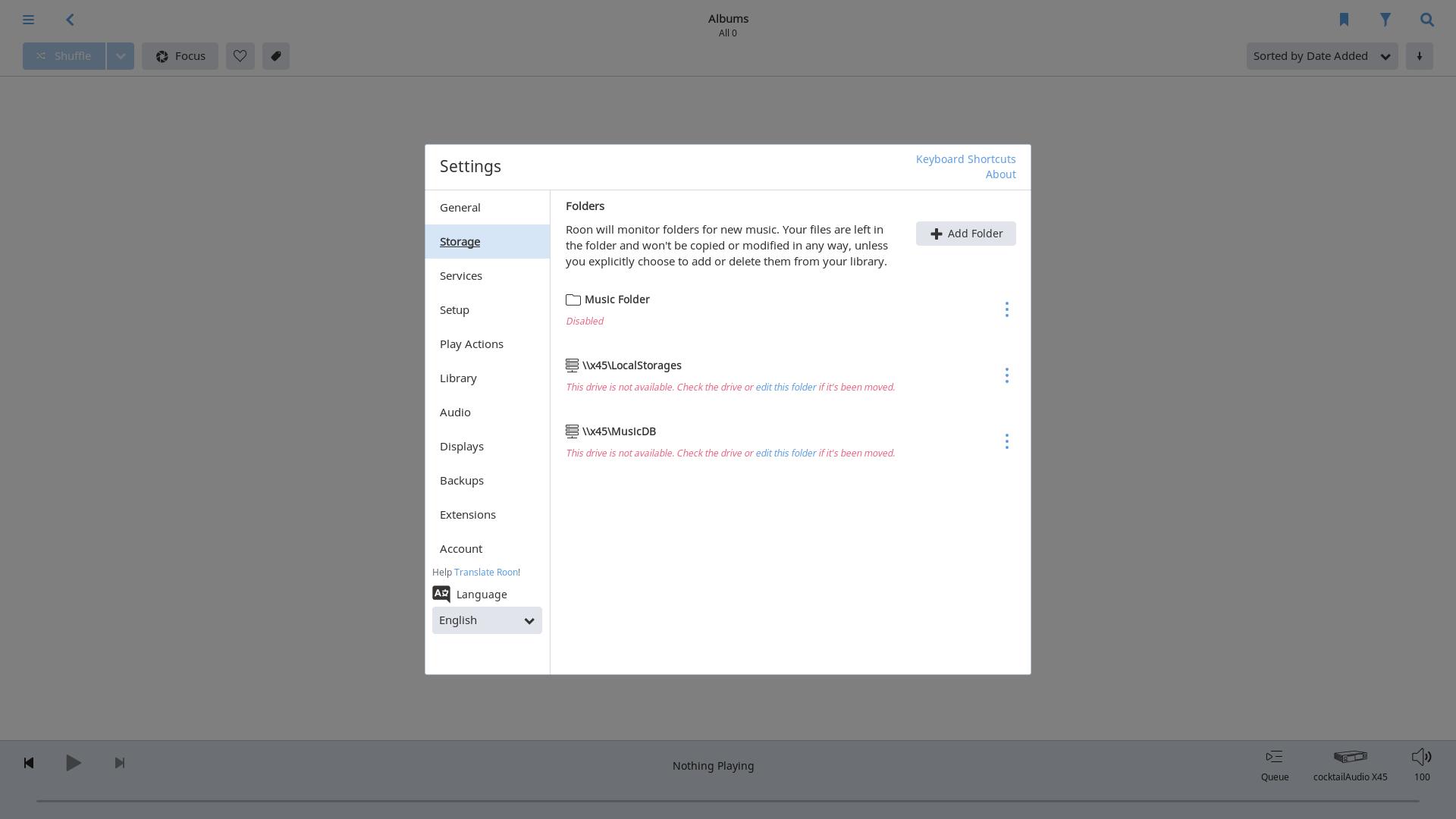

Can you share a screenshot of Settings > Storage?
I’m happy to do that but don’t know how to take a screenshot. I said I was hopeless at this! I have to go out for half an hour or so, but I’ll try to research it and send you something when I get back. If you have canned instructions on how to take a screenshot, those would be gratefully received! In answer to Neil’s question, I did reboot the storage device as well. I didn’t unplug them, and can do that now before I leave.

Here it is.
Thanks for this, Ian. The good news is that it’s clear why Roon can’t see your music files. We now need to understand what’s going on. But first I need to do a little reading up on the cocktailAudio X45.
In the meantime, please confirm that your music is stored on the cocktailAudio X45. I’d also like you to see if you can access the music files directly from your Mac. To do this, open Finder and click on Go > Network in the menu bar. Is there an entry for “x45”? What happens when you click on this?
