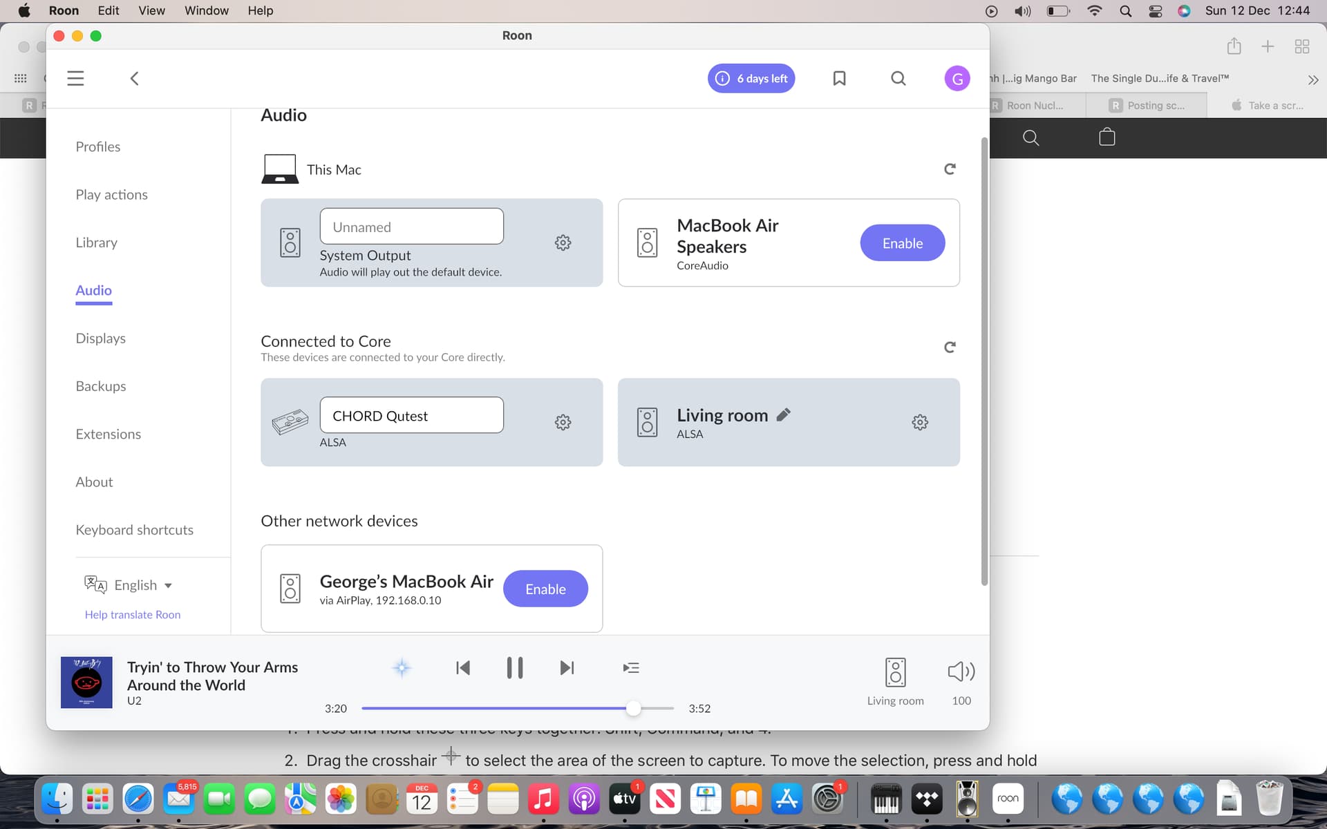

This is what I see when I open the settings/ Audio
Disable the zone named living room, that looks like it is maybe the HDMI output.
Then disable the new chord qutest zone , disconnect the chord.
Reconnect the chord and then enable whichever new audio zone pops up in settings.
So you have currently enabled 2 zones, one called Living Room and another called Chord Qutest.
The name might not relate to the real dac connected!
In the bottom right of the app you are controlling / playing to living room.
You can change zone and try playing to the zone called ā€œChord Qutestā€, but clicking on the bottom right loudspeaker icon. Try playing something to that and see what happens.
You can see where the output is going in detail by clicking on the white light spot on the lower left of the screen next to the track name. That will show you the complete signal path in roon.
Thanks to all who gave advice. I now have the sound back. As suggested, I disabled the qutest HDMI box, and have disconnected it from my setup. The nucleus is again connected directly to the amp as before. Ill stop experimenting until I know what I’m doing. Thanks again.
