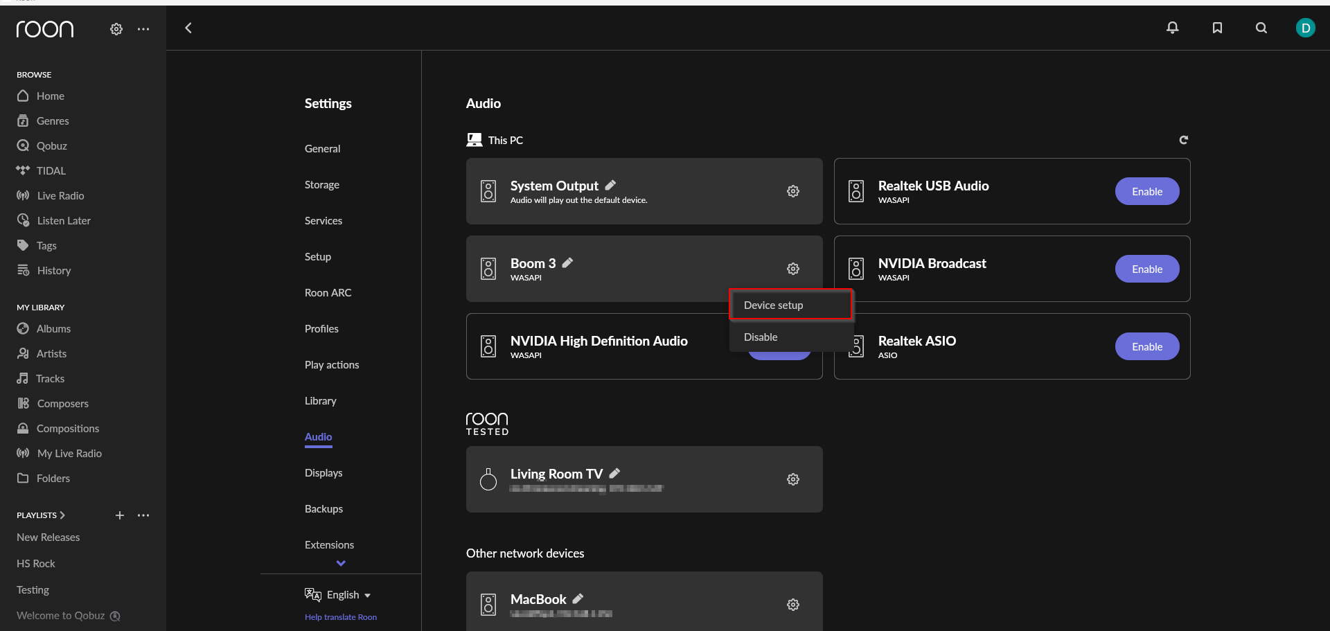

  1. First off, make sure you’ve toggled on Compatibility Mode for these Airplay Zones by clicking “Device Setup” in Settings → Audio for each HomePod listed under the Airplay tab.

I apologize but I’m not following, is “Device Setup” in iOS or Roon?

This will be in the Roon app’s Audio settings.

I went into “Device Settings” for all three devices. Living Room, Bedroom, & Basement, and changed them so that Compatibility is now set to “YES”.
