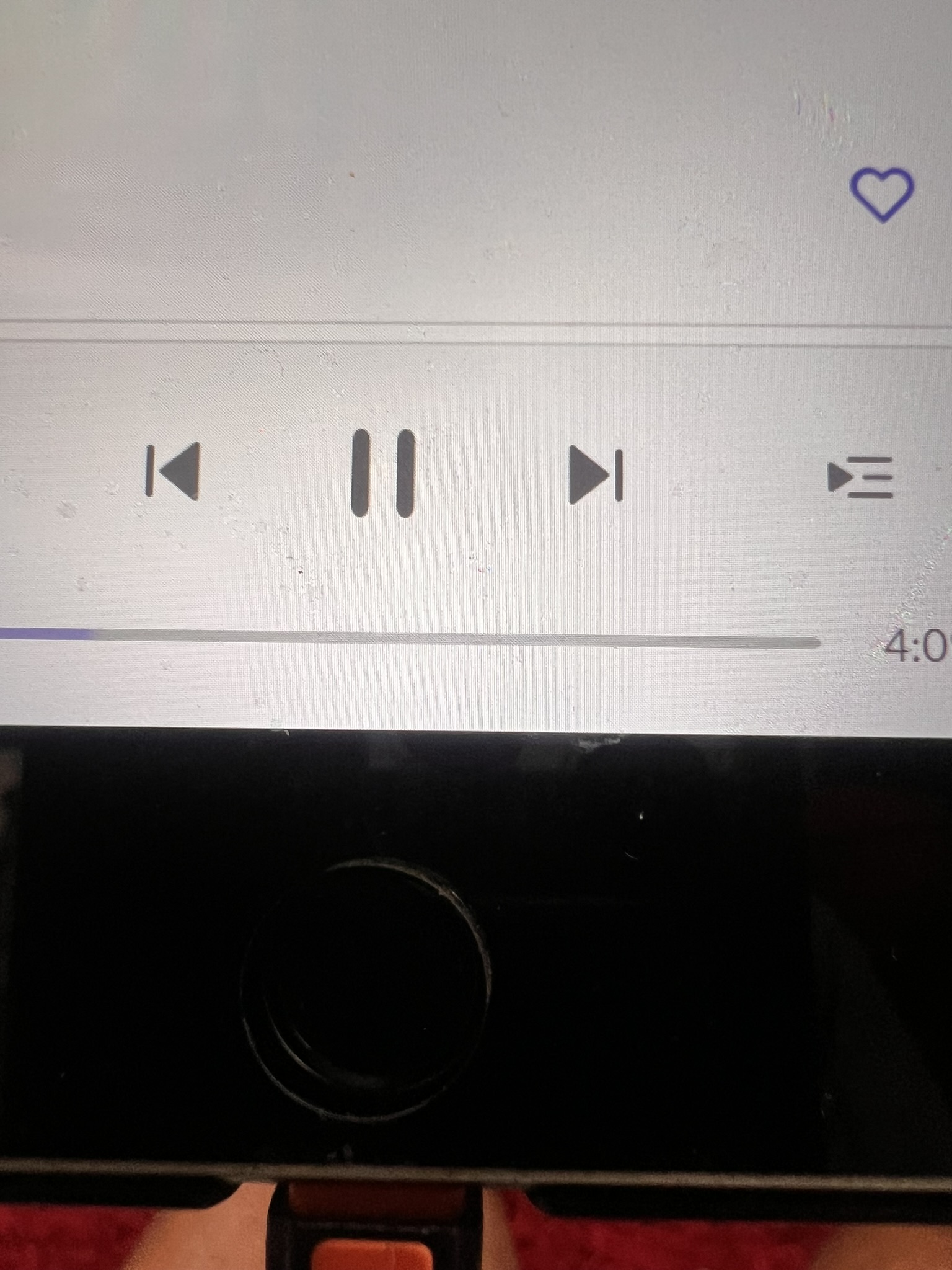

· When I first tried to install unit
· Nucleus one on the question I left a picture of bottom the song playing where it shows the length of the song that line buffers from left to right
I am a HIFI rose 130 when try roon I get digital noise I thought it me. Took to friend he also the roon nucleus unit would not plat at his either. I believe the unit is defective. I am requesting a return ticket & a new unit.
I have Ethernet going to roon Ethernet going to HIFI rose. I see the however they do not play together

Just to clarify a few details so we can assist better:
  • When you visited your friend, did you bring the HiFi Rose RS130 or the Roon Nucleus One, or both?
  • What audio formats (e.g. FLAC, DSD, MQA) are affected by the digital noise?
  • Is any DSP processing or MUSE feature enabled in Roon for this zone?
  • Could you please share a screenshot of the Signal Path (click the small glowing dot next to the track progress bar while something is playing) so we can better understand how Roon is sending the audio?
With this information, we’ll be able to determine if the issue is hardware-related or something that can be resolved through settings.

We’ve been working behind the scenes with our RMA team to respond to our case, but we’re going to need the information that my colleague @vadim requested above in order to proceed.
Based on the videos you provided over email, we don’t suspect a broken physical component is the problem here. This type of audible artifact generally points to a transcoding or driver problem with this particular Zone. This is something you can resolve in the Device Setup page or by adjusting the settings in their driver or endpoint.
Please try to:
  1. reproduce the digital disortion with another Zone, like computer or phone speakers. Does this only occur with the Rose?
  2. Disable all DSP in MUSE
  3. Play tracks of different file formats and sample rates
Afterwards, please share a screenshot of the Signal Path here.
Please also ensure you’ve read through our Audio Setup guide here.
