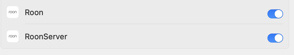

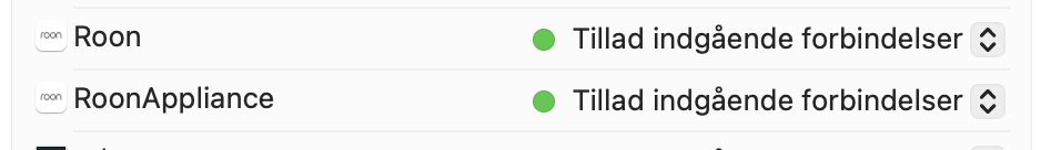

However, Sequoia has been known to police local network connections with some changes to network permissions defaults. In Mac System Settings, navigate to Private & Security → Local Network and verify Roon is toggled On. Also check that Roon is permitted to connect in the MacOS Firewall.

I can’t get it to work anymore I checked what you asked me to. See attached files. Mac just updated to 15.01 that didn’t help either. Are you sure there are no errors in roon.dmg ver. 2.0 (Build 1462)?

Try toggling the Roon and RoonServer entries off and back on in Private & Security → Local Network. Then reboot the Mac. This seems to have helped in some cases.
Hello again
It helped - it is not necessary to restart the MAC, you can just go into Privacy & Security, turn Roon & RoonServer off and on :slight_smile: Is there anything I can do now that we have found out why it didn’t start up? so it will work properly again?
