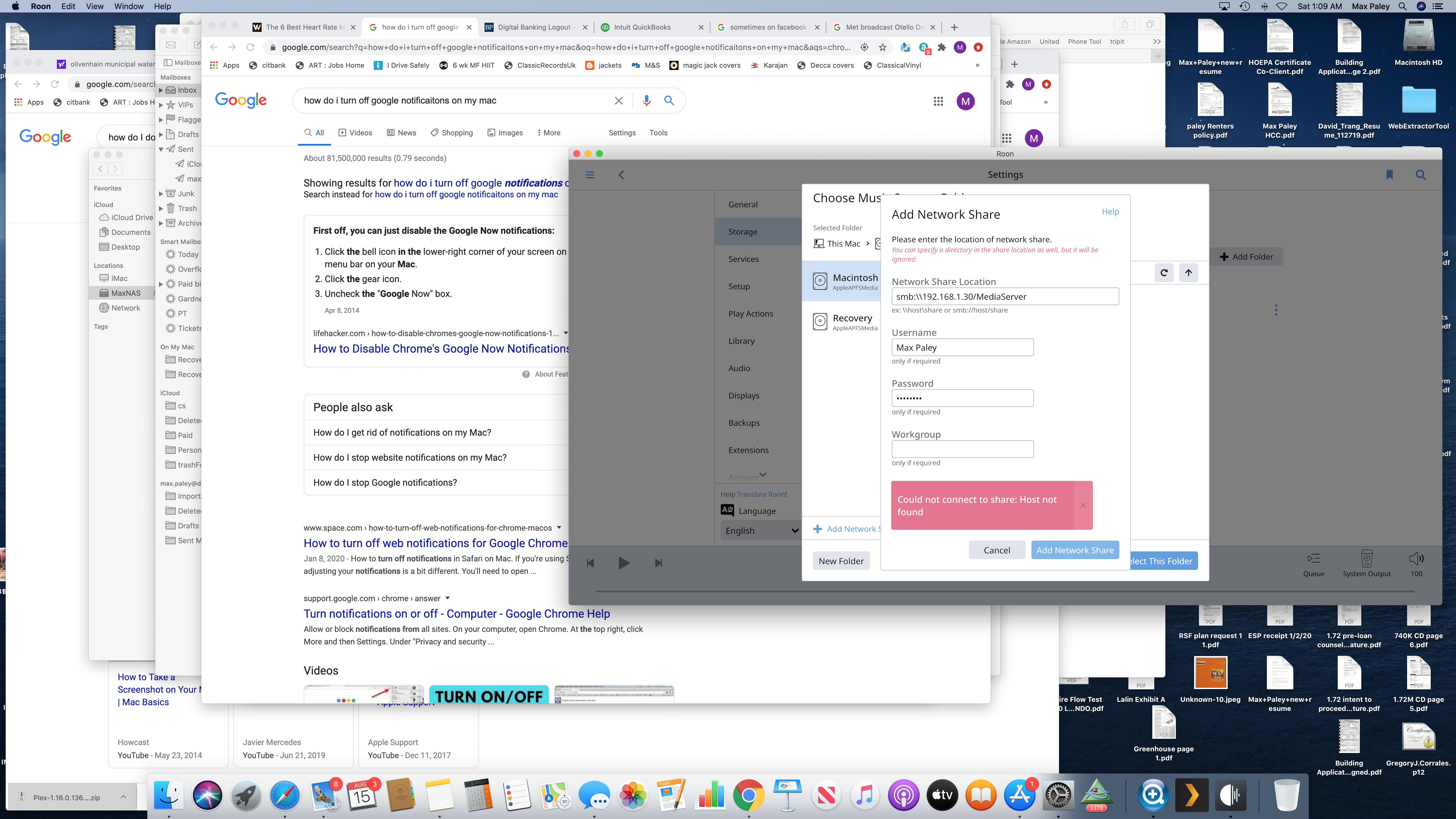

Had signed up for free trial a few months ago but couldn’t use it at all because I couldn’t connect to my NAS drive where all my music is. New network, new location, few months later, wanted to try again. It says my free trial is expired, which I never could use. Took leap of faith and bought annual subscription. Trying to set it up, same old damn problem. I type in valid credentials for path and use to connect to the NAS drive and it comes back saying “not authorized.” I can log in directly with these credentials but not via Roon. Roon doesn’t allow me a way to browse from the mounted volume level as other upnps do so I can’t get to my music. Need either a way to get to my NAS drive or need subscription cancelled.

Please post screenshots, one of your Finder/Explorer viewing your music folder on the NAS and one where we can see how you set up Storage locations in Roon.

Tried logging in as “Max Paley” and “Admin”. Both passwords are one-word with only a-z, A-Z and 0-9 and I can log into both on other apps with these credentials.

Use only forward slashes in the server path, and use it’s ip address rather than MaxNas?
And set guest access on that folder to read only. Then try again (without user credentials)
I also use a Synology. Get rid of the “SMB”, and as Mikael said, use all forward slashes. It should just look like this:
\\192.168.1.30\MediaServer
Assuming that’s where your music is. I see you also have a folder called Music, use that of course if that’s where your music files are located. Also If you haven’t yet, go to your router settings and assign that IP address so it doesn’t change.
Tried it all. All forward slashes logging in as Max Paley (which I now set to Read Only for that folder on the NAS) and Admin. Using the forward slashes only made it take longer and instead of “unknown host” it now, after a bit, comes back consistently with “There was an unexpected error”

That implies that the host was found but the credentials are wrong. Use admin instead of Admin. You should use backslashes as @QuinnT suggests too. Also, drop the full path and simply use \\maxnas (possibly \\maxnas.local) or \\192.168.1.30. If that works in Roon you can browse to the correct folder.
Thanks, Martin. Tried all that and also tried admin with lower case (although I log directly into the NAS as “Admin”. All yielded “unexpected error”
