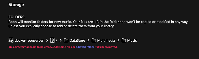

I have a lot of music stored on my NAS (/mnt/DataStore/Multimedia/Music) and I’m able to add that path in Roon Storage, but as far as Roon in concerned that folder is “empty” (There’s roughly 170Gb/25,000 files).

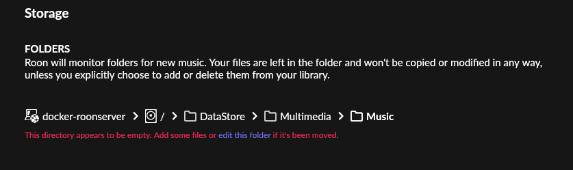

You’re telling Docker to create a volume in the container at “/roon-music” that is a mapping of the host’s /DataStore/Multimedia/Music. So, from within the container, you don’t want to be referencing /DataStore/MultiMedia/Music, you want to be referencing “/roon-music”.
In the picture you shared, you’re trying to find music in DataStore/Multimedia/Music. I’m actually not sure why DataStore is visible but I do know that isn’t where you want to point Roon.

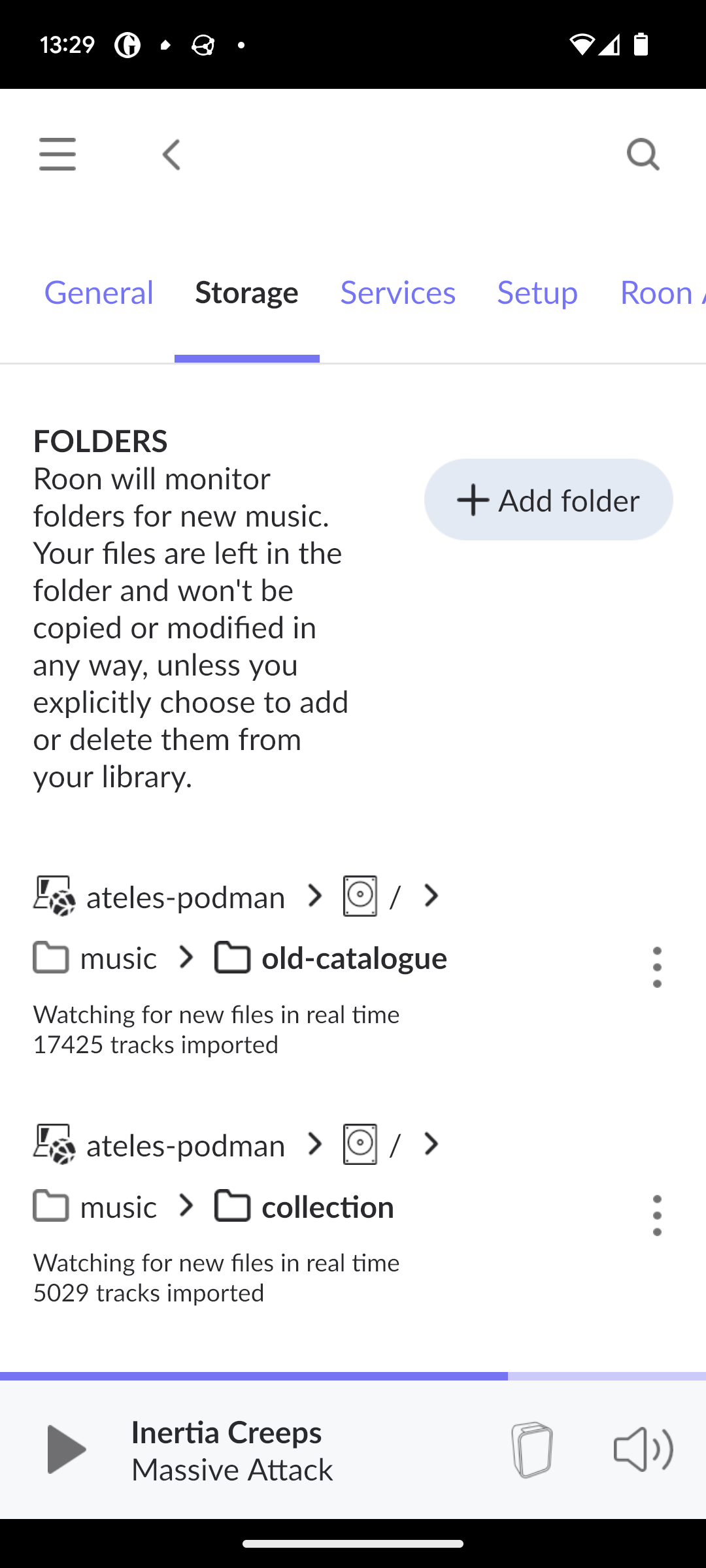

Here’s a picture of my Storage folder in Roon. My server is roonTrinity, the / is the root and “music” is what I mapped my music folder into. From within this setting in Roon, you should navigate up to the root by clicking on the slash in this:
Once you’re looking at the root, you should see roon-music, and that’s what you want to pick. I hope that makes sense.

I’ve gotten Roon pointed to /music like you have shown in your image. Although mine shows the directory to be “empty”. Which tells me I haven’t corrected the “link” (I guess you could call) of the /music to my /DataStore/Multimedia/Music (host music volume).

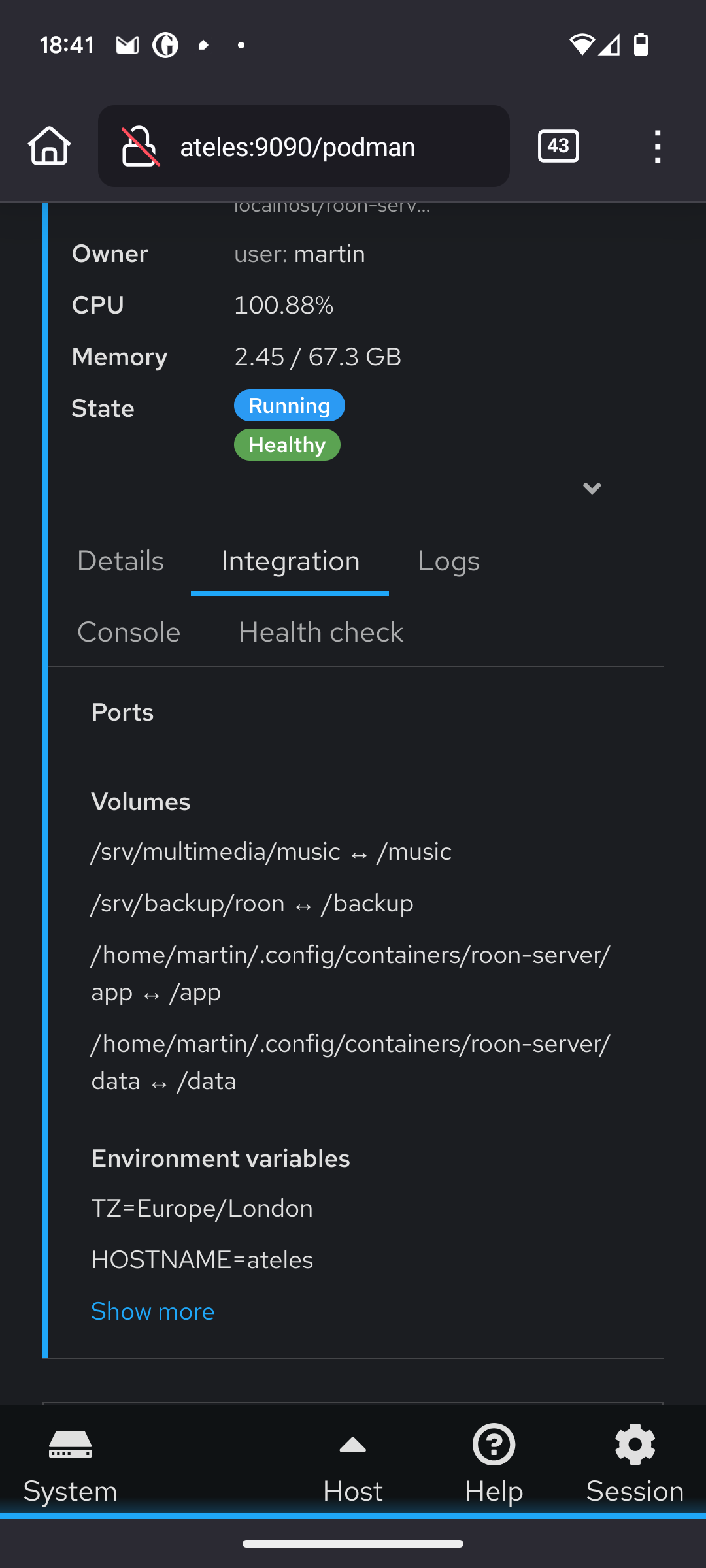

The folders in the container are /app, /data, /backup, and /music, and the form is the same as I posted in the Podman (Docker) run command.
You should map to the local filesystem, e.g., - /mnt/DataStore/Multimedia/Music:/music

IIRC, the template confused me when I setup my container. The roon-* entries would be clearer if real paths were used, or something like <host path>. They are on the host not the container.

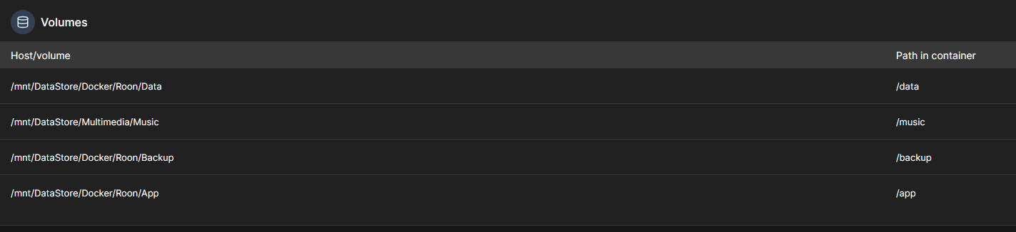

Holy crap… @gTunes and @mjw you are both AMAZING!!! It took a little tweaking to your YAML gTunes. It wouldn’t deploy until I added “/mnt” to the beginning. So it looks like this now
