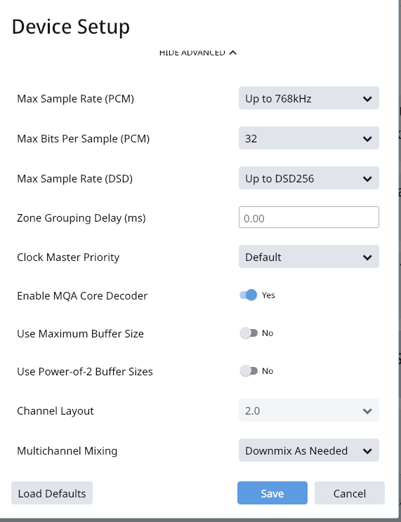

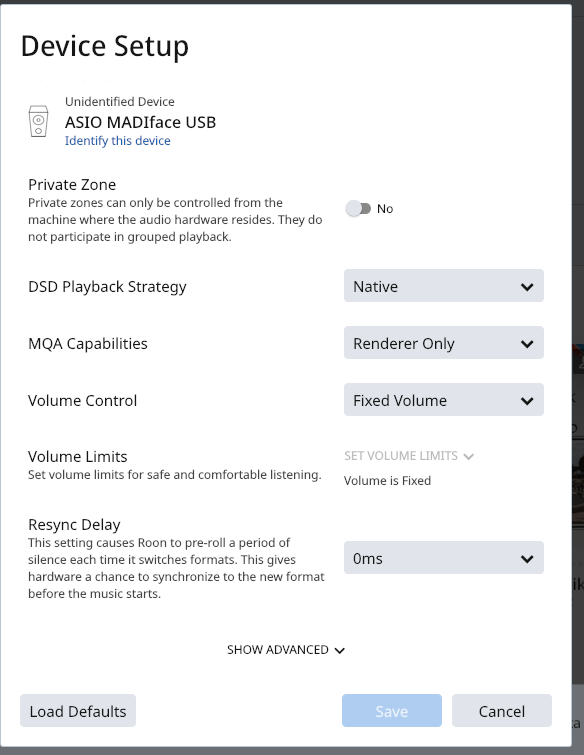

When using ASIO, changing the playback strategy values did not have a positive effect; I used DoP and PCM, and it still resulted in BSODs with the same error message.
