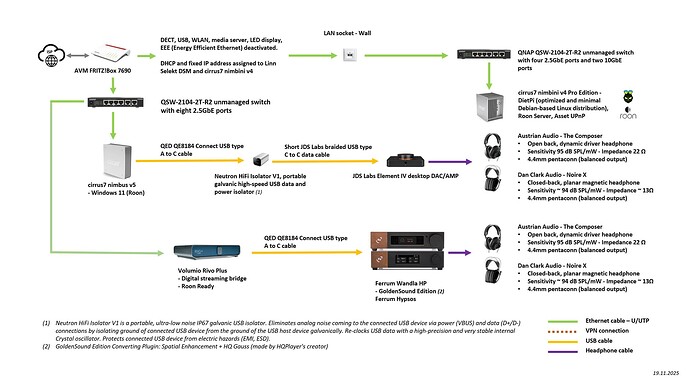

This is how I have conncted Wandla:

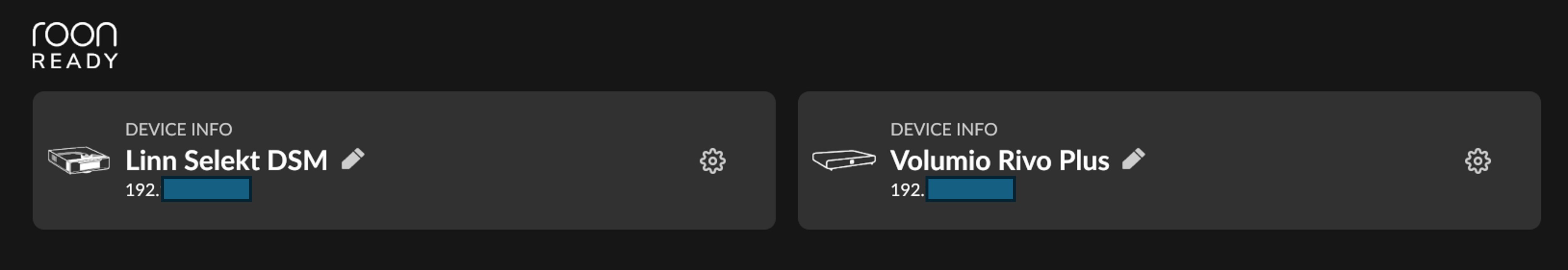

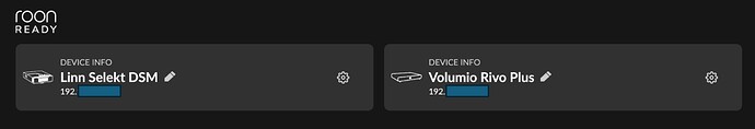

Volumio Rivo Plus is “Roon Ready” and does show up:

Assuming the OP is using a Roon Nucleus One running ROCK (Linux) there shouldn‘t be any drivers needed to make a direct USB connection to WANDLA. Works fine for me.
Possible issues to check for:
  • cable connection, try different usb A - C cable, different USB port on nucleus one
  • Auto input selection of WANDLA: are other devices connected? Try disabling auto input selection in Wandla settings and disconnect all other devices, select USB input
  • auto off function of Wandla: the dac goes into standby after a certain amount of inactiviy (5 min default) but should remain visible in Roon via USB. Check settings and disable for testing purposes.
