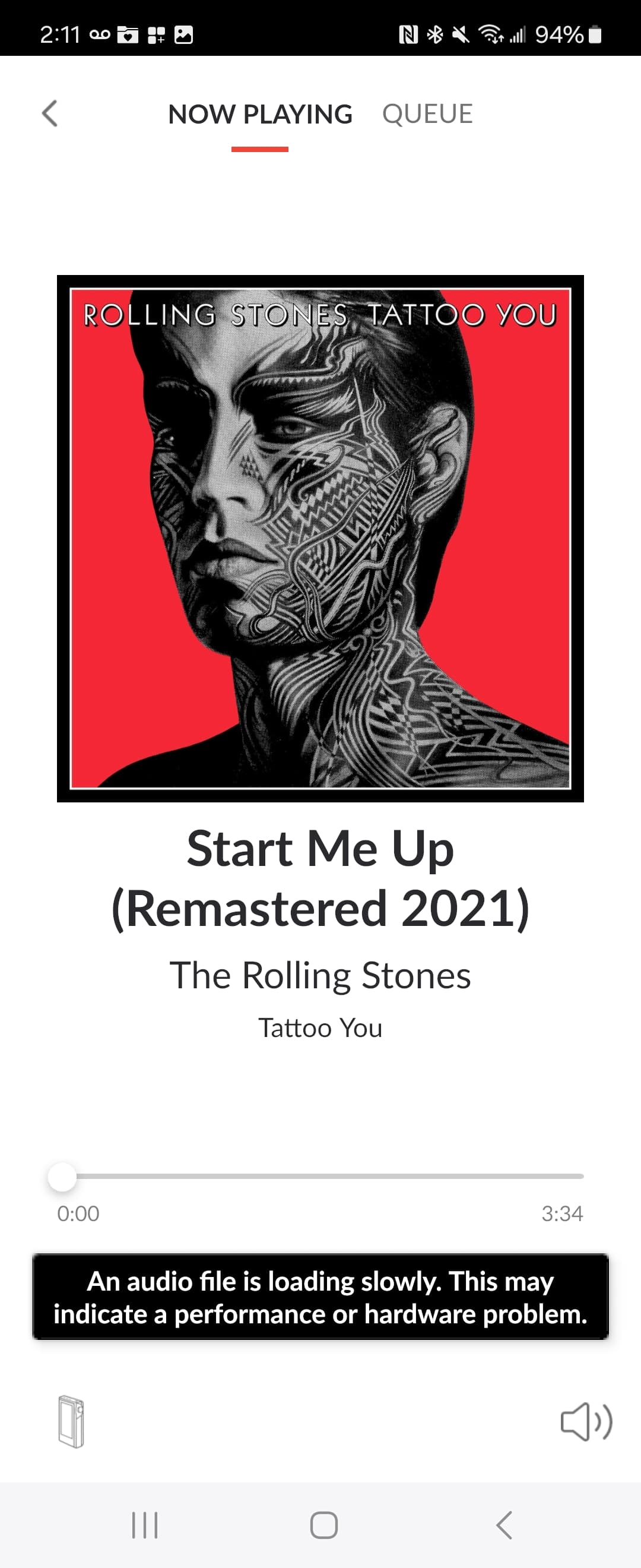

Using A&K Kann Alpha Roon will occasionally stop playing or skip entire tracks with an error that media is loading slowly. It does not present this problem on other endpoints
Connected wirelessly to Xfinity wifi that includes Xfinity pods (extenders)
Hello! To clarify, the AK does show up and is enabled (I don’t know why the AI asks me those questions). It’ll play fine for hours at a time and then suddenly will starting pausing and skipping tracks. It impacts both locally stored files and Tidal/Qobuz files.

Hey @Scott_Seiler,
You are experiencing dropouts and tracks stopping due to poor network connection, here’s a diagnostic snippet:
Warn: [zone Kann Alpha] Track Stopped Due to Slow Media
Info: [audio/env] [zoneplayer -> stream] All streams were disposed
Info: [audio/env] [zoneplayer] All streams were disposed
Info: [zone Kann Alpha] OnPlayFeedback StoppedEndOfMediaUnnatural
More specifically, we’re seeing a potential issue with your network being constrained in some way, potentially throttling the bandwidth or facing latency issues when retrieving audio data.
We see several entries with accessTimeOut:True which can indicate that the connection isn’t retrieving data as expected within the given timeframe, which could be due to an unstable or slow network.
