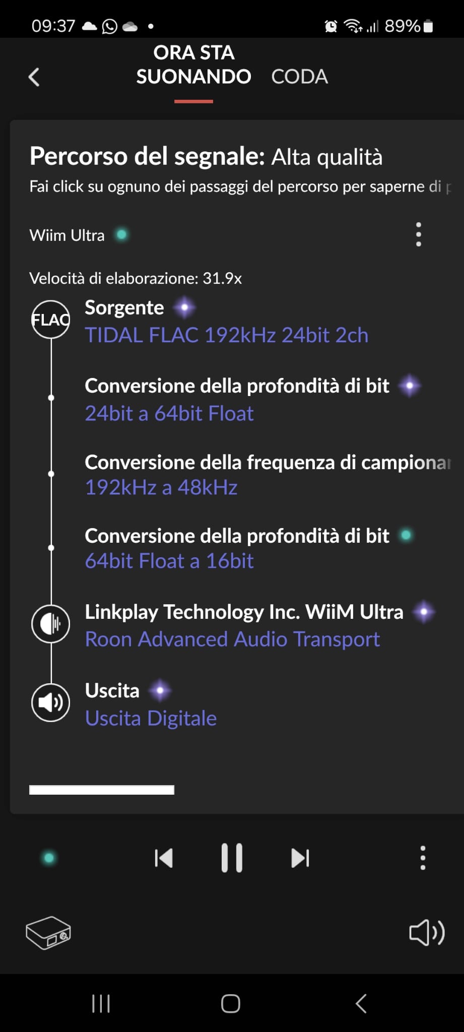

hi, i have had the wiim ultra for a few days, updated and enabled as roon ready. i see in the audio signal path that it continues to downsample the signal to 48khz. i am using it as a streamer on spdif. spdif which on the wiim app is set to 24bit 192khz. when i use tidal connect i can have the maximum bitrate while if i use roon i can’t. why?

Show an image of your signal path to help diagnose the problem.
thanks, but that’s not the problem. Tidal is already set to Max
thanks for the help but that’s not the problem. Tidal is already set to Max

The signal path shows that Roon is doing the conversion. Therefore, please show a screenshot of Device Settings > Advanced. For example:
Well, that’s odd. I’d expect to see Max sample rate here. Whilst S/PDIF is limited to 192 kHz, the DAC, as in my example, may not.
Do you have DSP (Muse) sample rate conversion enabled?
Yes Martin it’s really strange. I have other DACs and I’ve been using Roon for a long time and with all the other devices I have the same options that you showed. With the Ultra instead I have no possibility of changing other parameters, but only those that you see in the photo. I can’t understand what the problem is. The really strange thing is that using the WIIM app if a file is 24/192 it is reproduced as it is without any alteration or downsampling. Oh I almost forgot, I didn’t enable the conversion with MUSE.
