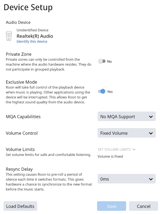

Not suggesting this is the issue but, under MQA compatibility it should read NO MQA Support. And, since you are going out to powered speakers, I would for now, set it to fixed volume and control the volume at the speakers.

I have set the MQA support to “No MQA Support” and changed to fixed volume and tried, still no luck.
You are correct, its showing as “Realtek Digital Output” only. Still Audio is not playing at all.
