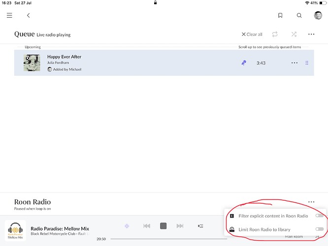

It’s ok for me on iPad. The option, for me, is under the three dots lower right:-

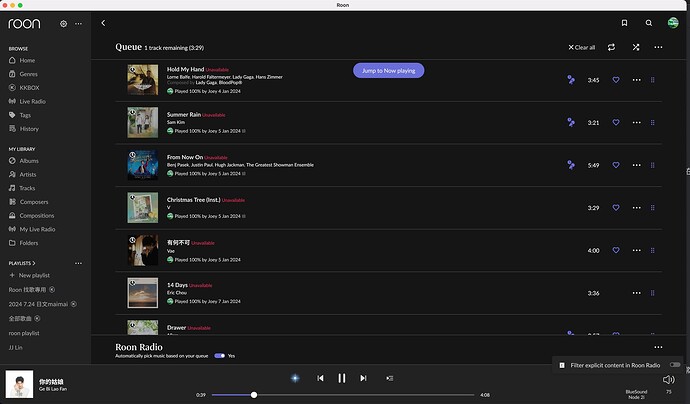

Yeah, it didn’t show here.
I don’t know what’s going on, cause it showed before.
Why are all Qobuz items in your queue unavailable? I notice that Qobuz does not show in Home on your side bar either. Did you log out or cancel? (And if you canceled the service, why are its tracks in your queue?)…
I also notice KKBOX in your sidebar - can you play KKBOX tracks?
And are your local files available and can you play them?
Sorry, I used Qobuz before, but I have stopped the subscription and logout from roon setting.
Here’s the new screenshot.
And I can play all KKBOX tracks without any issue, also able to play local files too.

Thank you for the report. We’ve noticed that you have a very small volume of content stored in your Roon library - only 29 tracks as of this writing.
  1. had you added any content to your Roon library prior to submitting this post? If Roon Radio has no seed content in the library, then there will be no option to limit to library.
  2. if you add additional content to your Roon library form multiple sources (local and other streaming services, if you have any other subscriptions), do you see the option for Limit to Library then appear?
