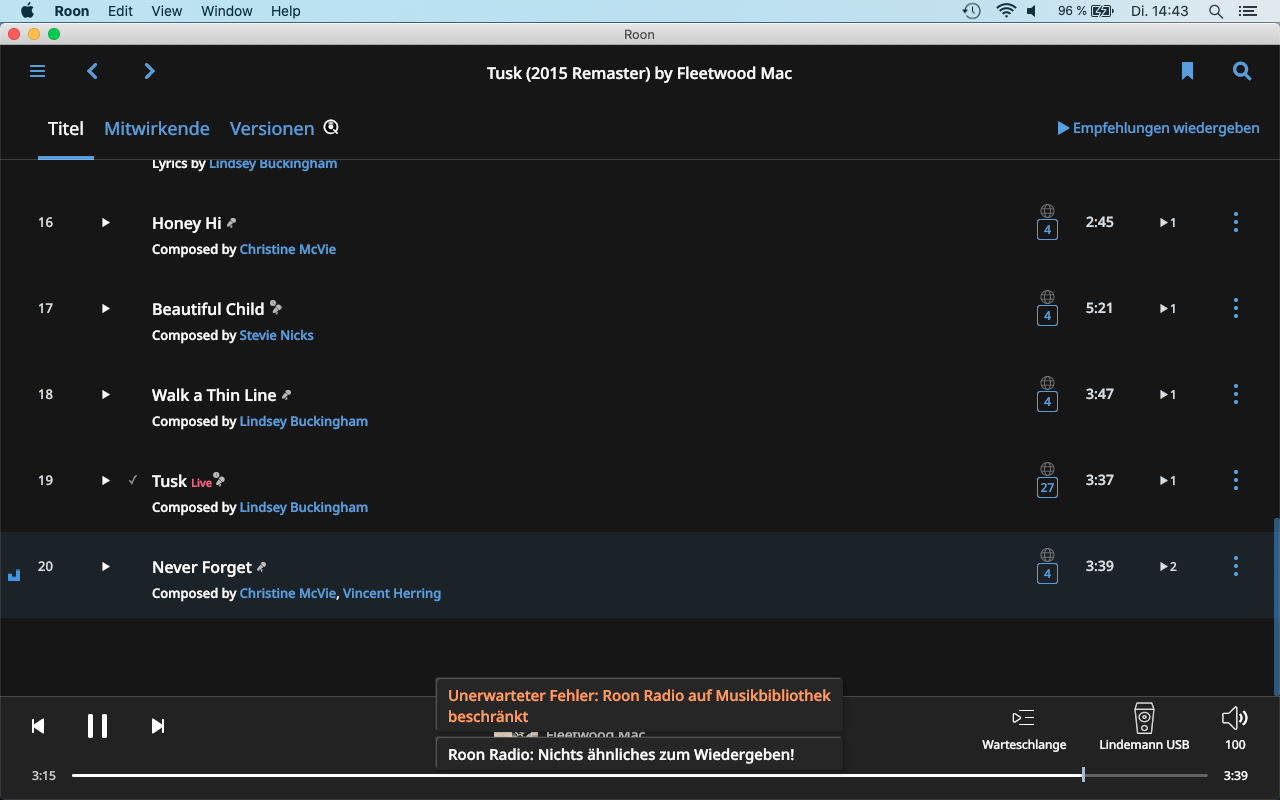

Hello,
until recently I was very happy with Roon, my third music player. But recently Roon Radio only works with my own music files. Nothing happens at the end of the playback from Qobuz. An “unexpected error” is displayed. The error is always present.
I cannot start Roon Radio manually either.
In the community I see similar posts but can’t find a solution to the problem.
I ask for help.

The problem occurs with all artists, after repeated switching on and off and also with the internal speakers.

Slowly I’m really disappointed and angry. Roon radio didn’t work for weeks. It only worked again with the last update. I thought all was well. It was the same for a few weeks. Then it started with dropouts last week and now nothing works anymore. Supposedly I have no connection to the router and I should check my network. Strange that all other applications work perfectly. Does anyone have similar experiences?
Regards Werner
