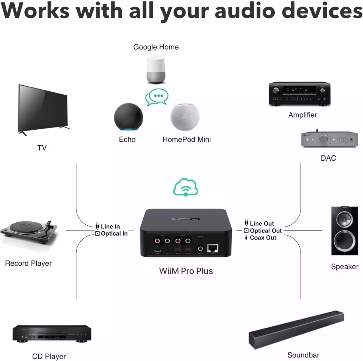

Unfortunately I am not an expert.
But my Raspberry Pi4 is expanded with a DAC.
Would a WiiM Pro Plus replace the DAC?
This image was confusing me as it shows also a DAC.

Regarding the WIM - I donât believe this will control the AVR any differently than your raspberry p with the installed dac.

Thanks for trying to explain me. As I said: I am not an expert and I still do not understand.
Actually my Raspberry Pi is connected to my Denon AVR. Is then the AVR acting as DAC?
The WiiM Pro Plus is not bad as it already includes the Streamer plus anaog in if you need that.
On the other side a Raspberry Pi plus the Topping D50 III delivers more fidelity and you also can use the Raspberry for Roon Extensions.

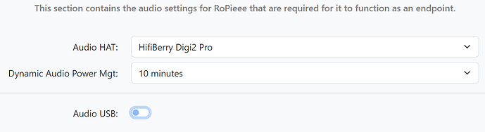

Which software did you run on the Pi?
ropieee (https://ropieee.org/)
And how is the AVR connected? USB or Ethernet?
