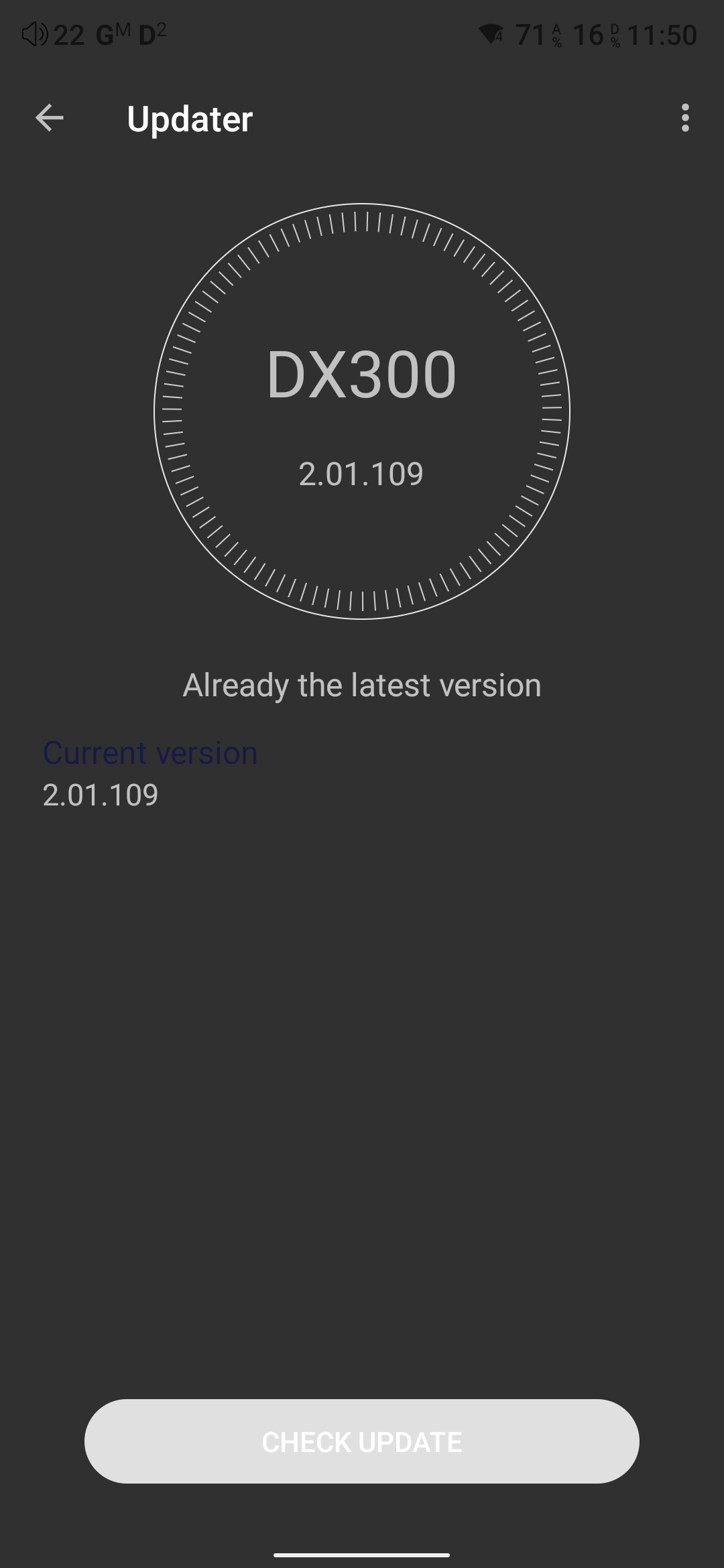

Thanks for getting back to me. All these comments apply to the iBasso DX300 with it’s latest firmware version installed (2.01.109) over Android 11. I have tried clearing caches, and reinstalled the Core too. I have about 4500 tracks in my library.

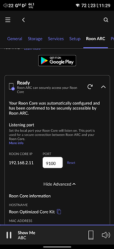

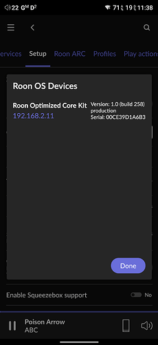

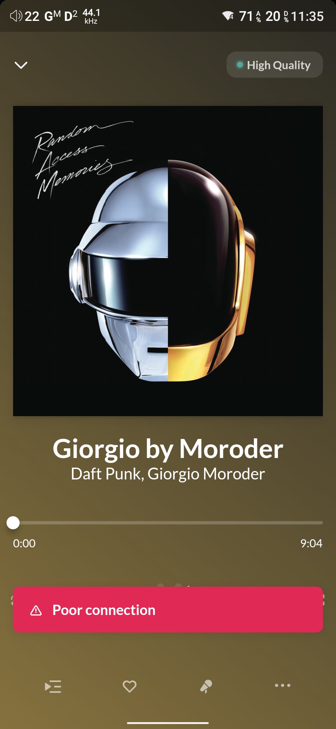

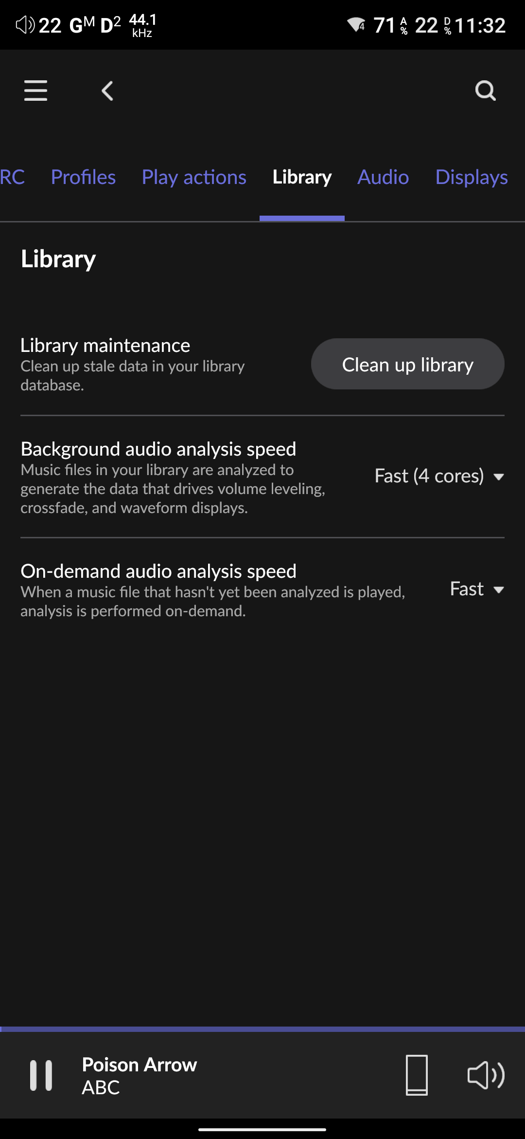

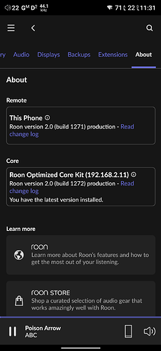

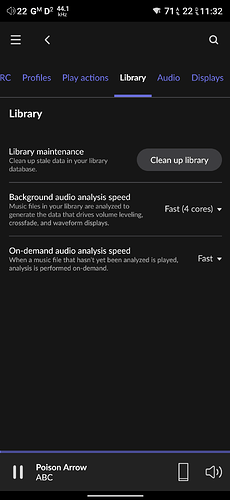

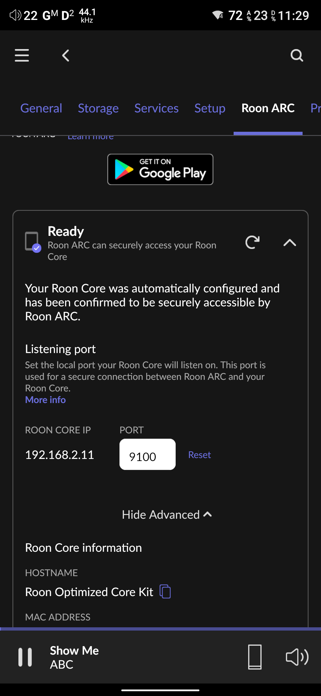

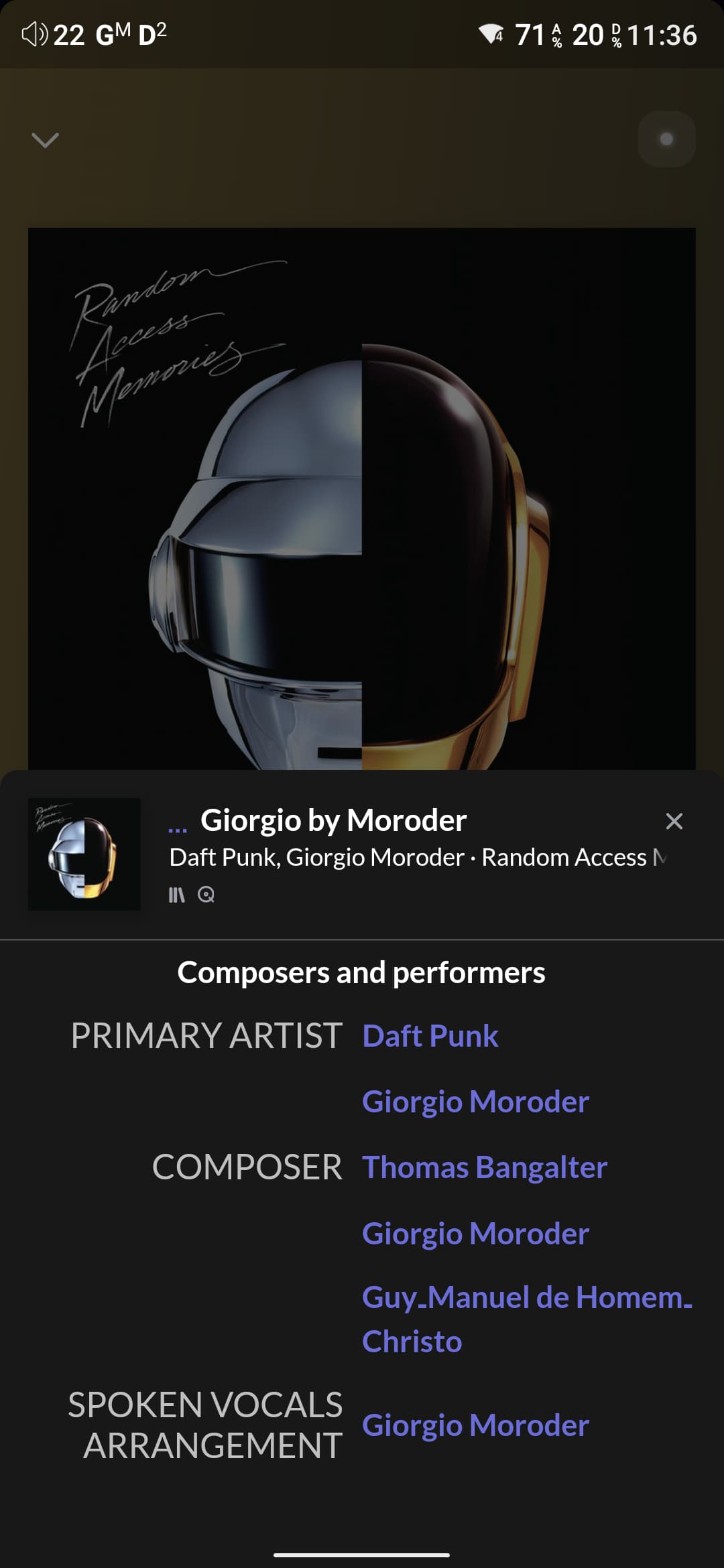

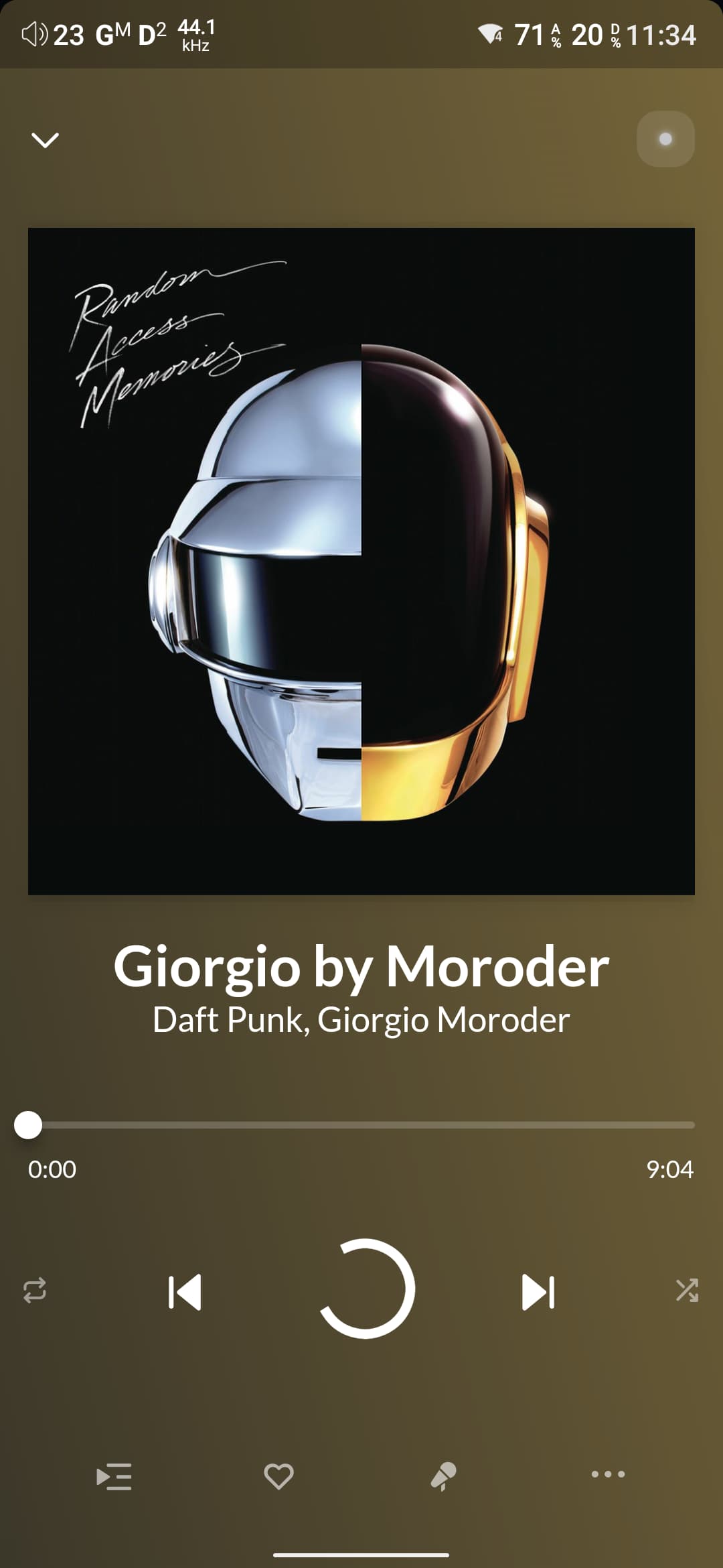

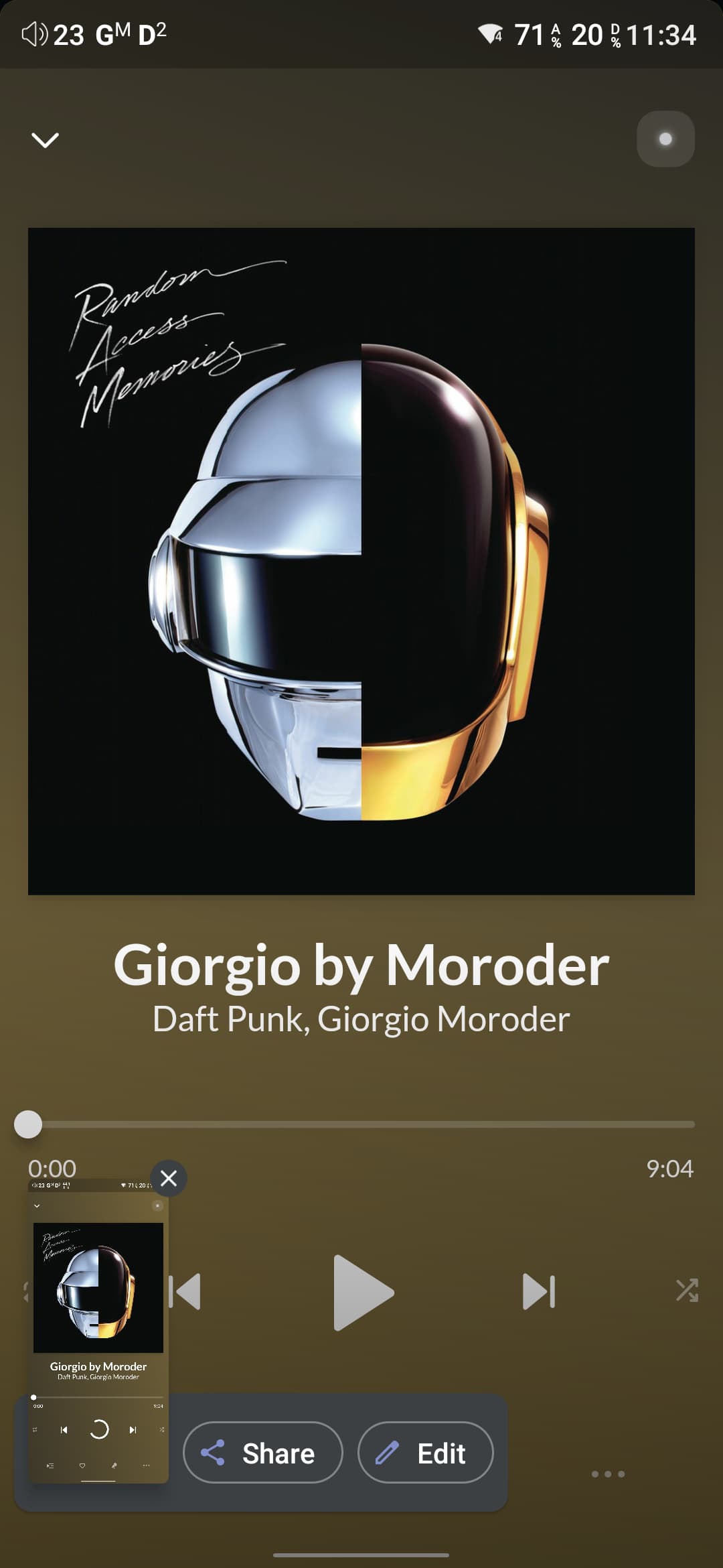

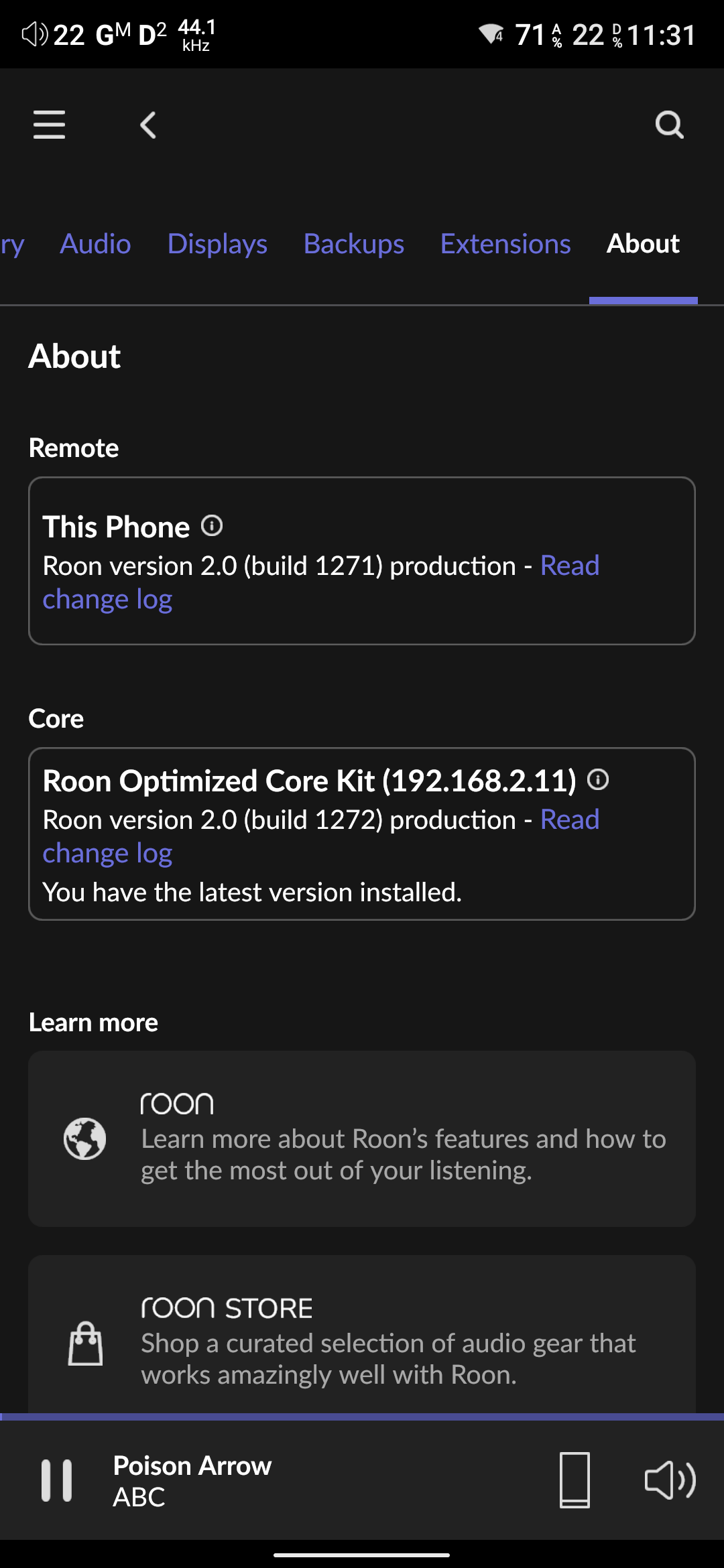

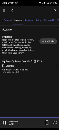

I grabbed a bunch of screenshots, but while looking at them, it doesn’t really tell the story…
From the Arc screenshots you can see the spinning wheel. From Roon, play doesn’t work, it seats there… Skipping next or back does the same, the tune queues up properly but won’t play. I tried playing albums from my library and streaming from Qobuz and Tidal subscriptions, cached or not, nothing would play from neither Roon or ARC.
I managed to screengrab an error message saying in red “Poor Connection”.
I have an healthy and perfectly working WiFi network from an Assus RT-AC88U dual band router connected to a fiber modem. All operation are being done from about 10 feet from the router. I tried both 2.4GHz and 5GHz.

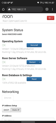

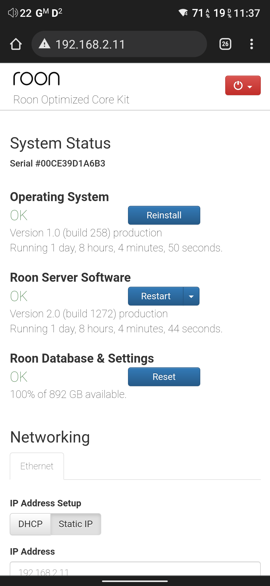

I installed Roon ROCK on a mini PC bought from Amazon:
MeLE Quieter3C WiFi 6 Fanless Mini PC Win11 Pro Celeron N5105 Mini Desktop Computer 8GB 128GB Micro PC 4K HDMI.
My library is installed on a SAMSUNG 980 SSD 1TB PCle 3.0x4, NVMe M.2 2280.
This combo as been working rock solid so far and I am happy with my setup.

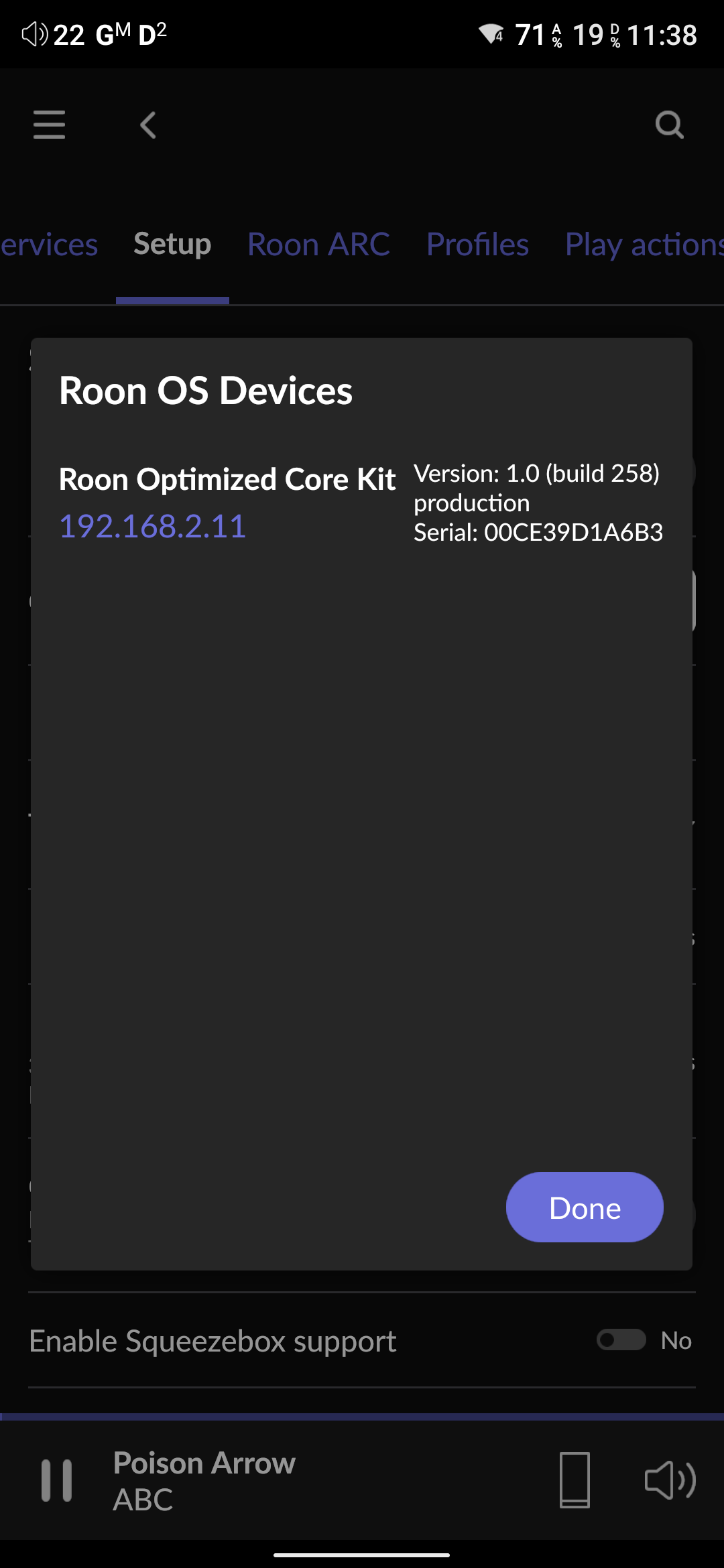

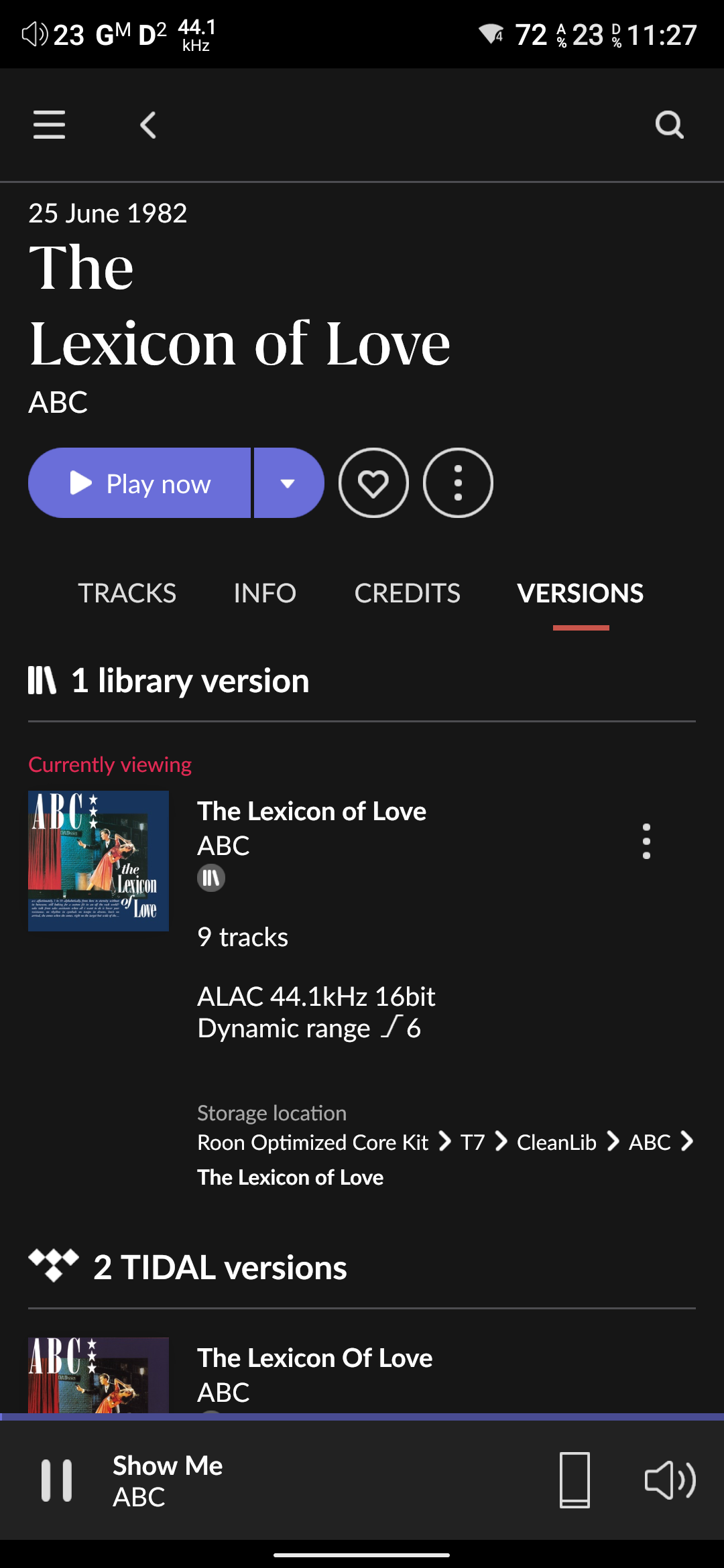

Hi Ben,
Some more screengrabs from the DX300…
Fred.
…and even some more screengrabs from the DX300…
Fred.

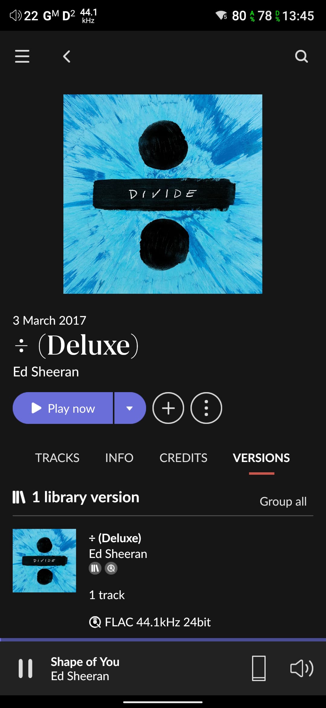

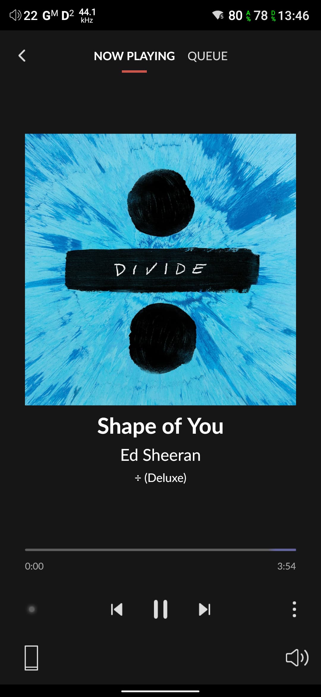

Hi Ben,

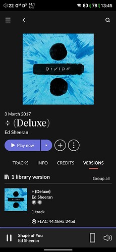

Here’s a screen shot of one track as an exemple:
Tried to play at 13:45 PST:
Ed Sheeran “Shape of You” from album Divide. Qobuz, 44.1kHz.
