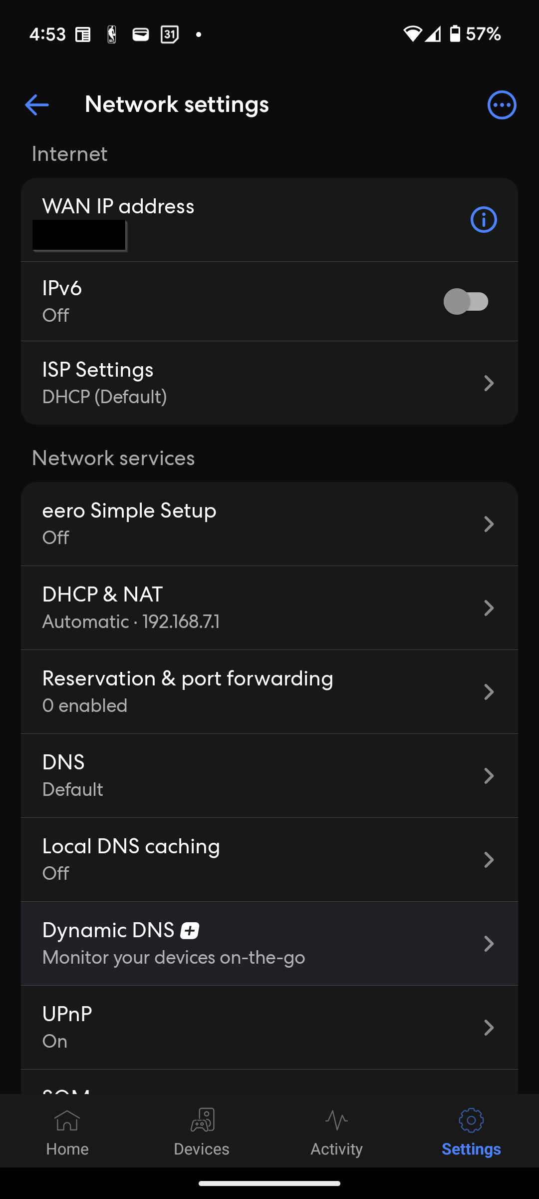

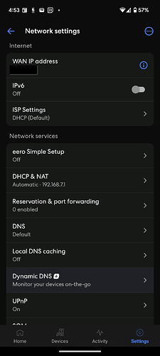

I edited your screenshot to hide your WAN IP address. I assume this screenshot is from the router not the extender. Is that correct?
Is this meant to say 192.168.7.1? If so then your router and extender are in the same subnet now which is good. Has there been any improvement with your remotes being able to connect with your server?
Hi @daniel.
That screenshot you edited (thank you!) is from the eero app on my phone, not the router, which I understand to be the primary Xfinity box which brings service into my home.
And yes, 192.168.7.1 - sorry for the mistype earlier. This IP is showing in the eero app as the IPv4 address under the primary eero Pro device.

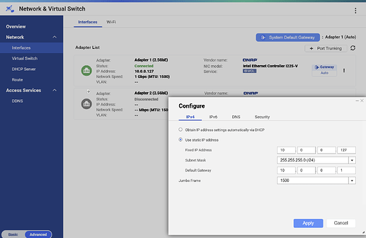

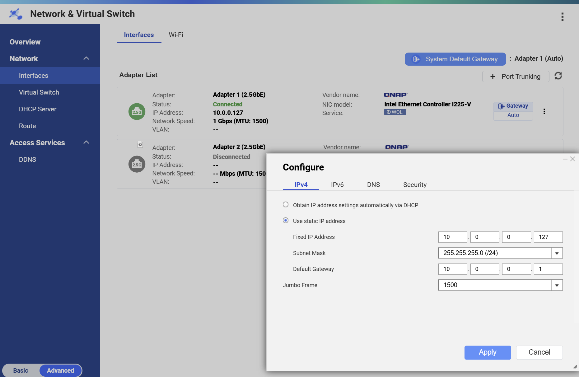

Here’s what I see:
Do I just brazenly change the entry of the Fixed IP Address to 192.168.7.151 and hit apply? Or are there deeper level things to configure?
If it is so easy (that’d be great!), I assume the url from which I reach the QNAP would simply change from http://10.0.0.127/ to specifically http://192.168.7.151/? I’d like to confirm that before trying anything, since I fear losing access to the NAS in this process.

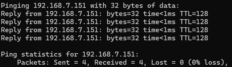

Regarding your caveat specifying “as long as that specific IP isn’t being used by another device,” I did my best to determine if another device is using that address. Google guided me to ping it via CMD prompt, which I did, finding this:
I’m all thumbs here, but it would appear that in pinging that IP there was, in fact, a device using it? I honestly don’t know for sure. Can you help me understand if 192.168.7.151 is or isn’t available for the task we’re trying to complete?
Assuming (hopefully) it is free to use (if not, please advise next steps), will I change the QNAP Fixed IP Address to 192.168.7.151 and also switch the Default Gateway from 10.0.0.1 to 192.168.7.1? Or should I leave Default Gateway alone? FYI, I reach my Xfinity modem via 10.0.0.1 currently.
