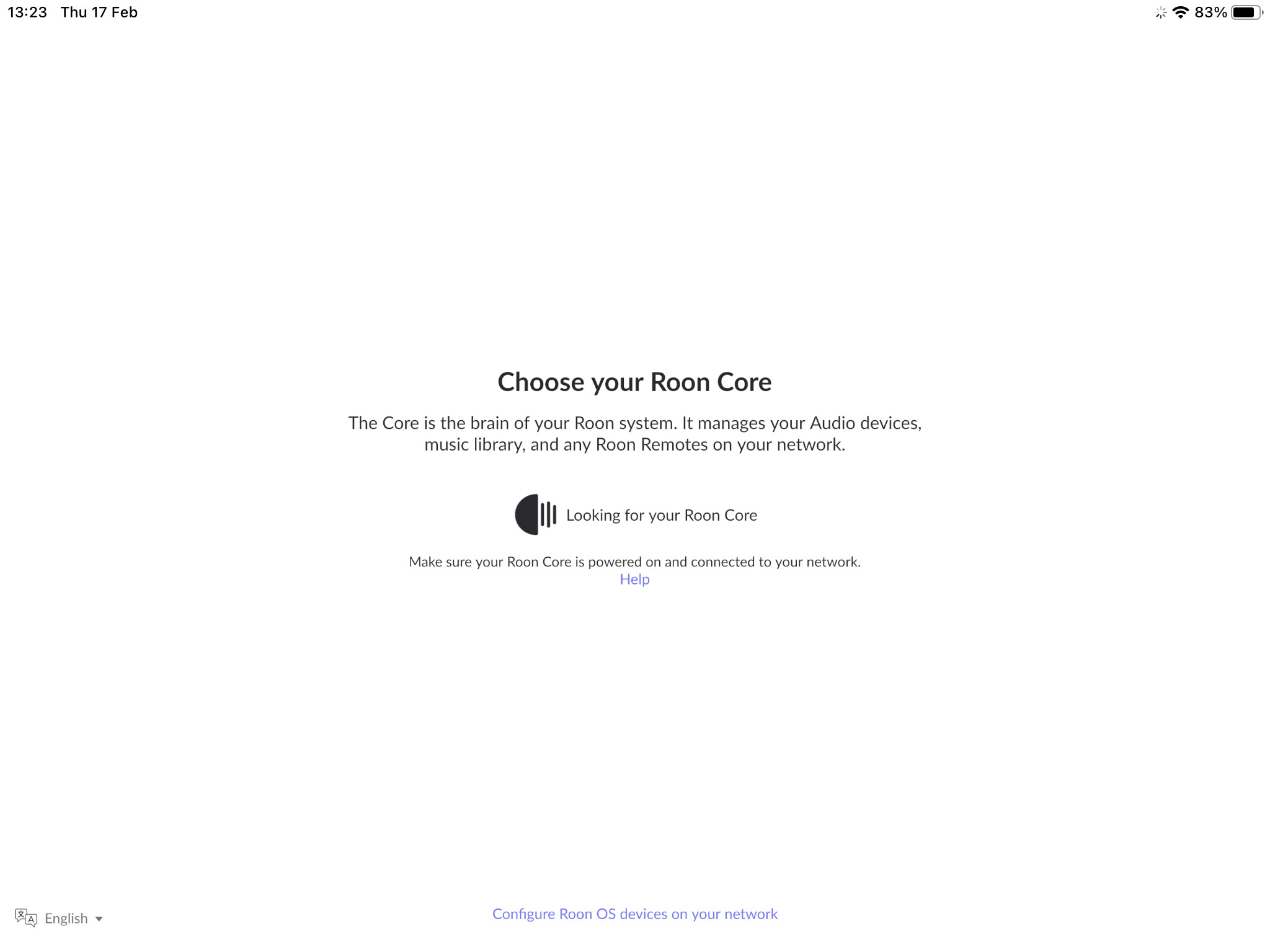

After installing The latest Roon core software update via the iPad Pro Roon Remote (1.8 (build 903) stable) this morning, I can no longer connect to my Roon core with the Roon Remote on my iPad.
On the Roon Remote app it just continually searches for my core.
Nothing has changed in my set up since I updated this morning. All the connections are still connected, and the Sonictransporter is still connected, switched on and available on the sonicorbiter web interface.
I have tried deleting the Room Remote app on my iPad and reinstalling it, but still the problem persists.
This problem only started straight after the latest update was installed 1.8 (903).

I have just downloaded Roon on my Mac mini to see if that Connects as a remote as a test, but that can’t connect to the core as a remote either.
So whatever has happened, Happened after the latest Roon core update, and two different remotes cannot connect anymore.
Any help is greatly appreciated.
Okay I managed to find a similar problem on the Internet after a long search.
Uninstalling the Roon core app on the sonictransporter and reinstalling it got it reconnected, then I restored from back up and everything seems to be working now hopefully.
