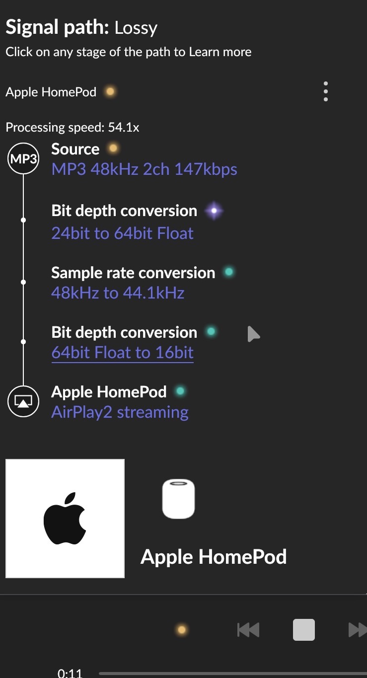

· Issues with Roon Rock Airplay after HomePod OS27 update
· No Sound after HomePod OS 27 upgrade: RoonServer v2.71 (build 1683), RoonOS 2.1 (build 271)
Target: AudioAccessory6,1 (HomePod) on homePodOS 27
Log line: [airplay/clientV2] [192.168.100.120] SETUP failed: 400 Bad Request, trying airplay1 fallback for shairport-sync
Symptom: AirPlay 1 fallback session sustains but produces no audio on OS 27.
