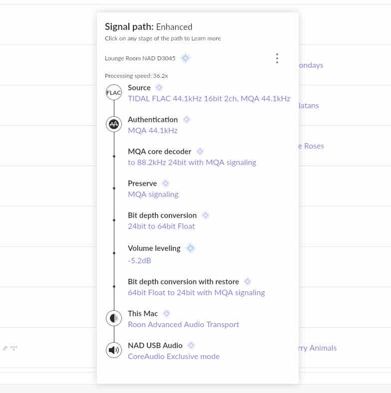

My guess is that this may be because you are probably using System Output on the Mac Mini, and not the USB device directly. MacOS’s sound mixer is destroying your MQA data.
What’s your signal path look like when playing?

The signal path indicates CoreAudio Exclusive mode is being used - so it’s not at output stage that the MQA data is being lost.

As for the Mac Mini’s signal path, I wanted to see if something else was taking out the MQA… screenshots are probably best

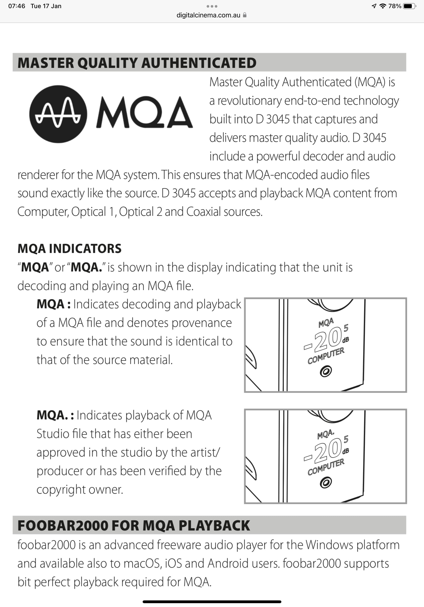

Is the D3045 a full MQA decoder/renderer or just a renderer as that could affect why MQA not working if Roons MQA isn’t active as it’s off by default.
The manual doesn’t specify, but, reading it I think it is a full decoder/renderer.
Yes - it is a full decoder/renderer.
Can you you show a screen grab of Roons signal path when playing MQA to the amp, also of the device settings and it’s advanced settings.
Here is the signal path when playing a MQA track using the Mac Mini as the audio source (no MQA indication on the amplifier):
The amplifier indicates MQA when playing the same track, using the fourth USB port on the NUC as the audio source.

Your DAC should be showing MQA 2nd decode (the “render”). Roon is taking care of your first decode in that case.
Does the DAC you are using indicate when only the render is happening, or does the light mean the first core decode is happening?
This is the manual information:
The MQA indicator used to show when receiving a MQA stream from the Mac Mini, when the Mac Mini was the Roon Core. The MQA indicator does show when receiving a MQA stream from the NUC Roon Core.
So that tells me the MQA indicator will show when either decode and render or render only is taking place.
