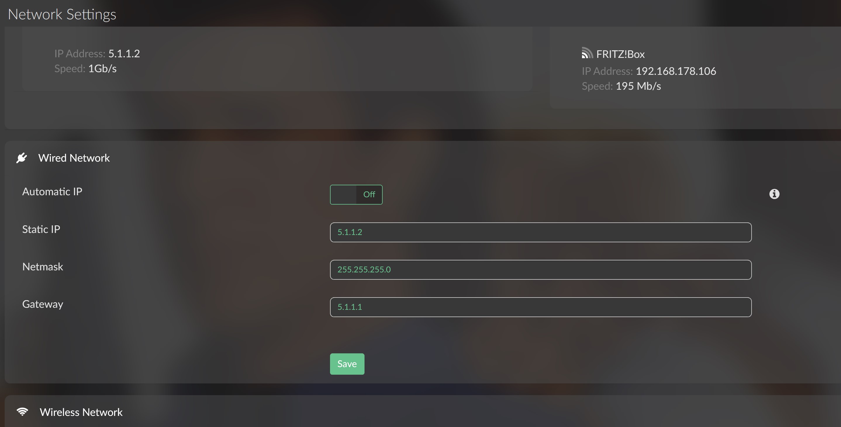

Could it be that Roon remote doesn’t always show the correct IP however (see screenshot)? Today it showed several times a switch between 192.168.178.106 and 5.1.1.2 but the Roon logs for the whole day does not show any connection to 192…, only to 5.1… Rivo ss -tupn via ssh did also show “volumioraatd” connection only via 5.1…
This would make the issue much less severe, though there are definitely cases, also in the logs, where the connection swaps.

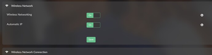

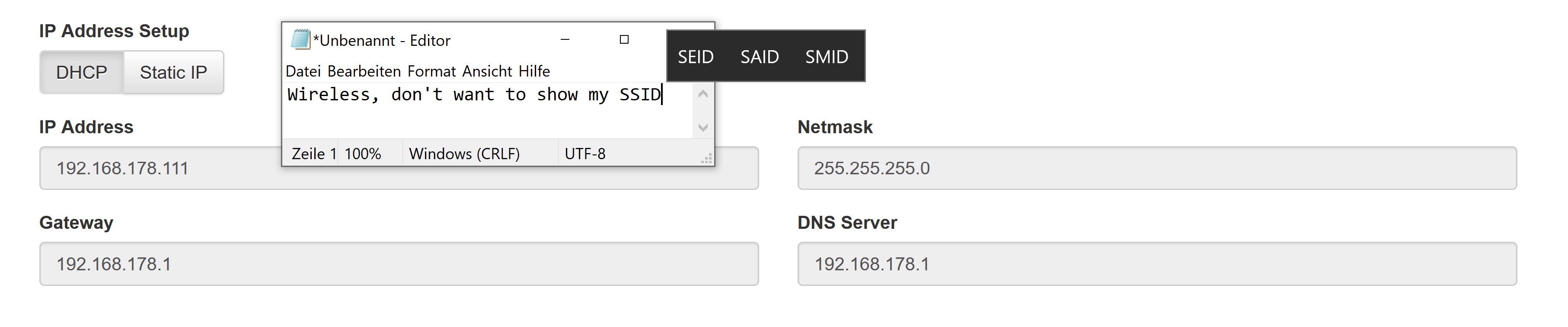

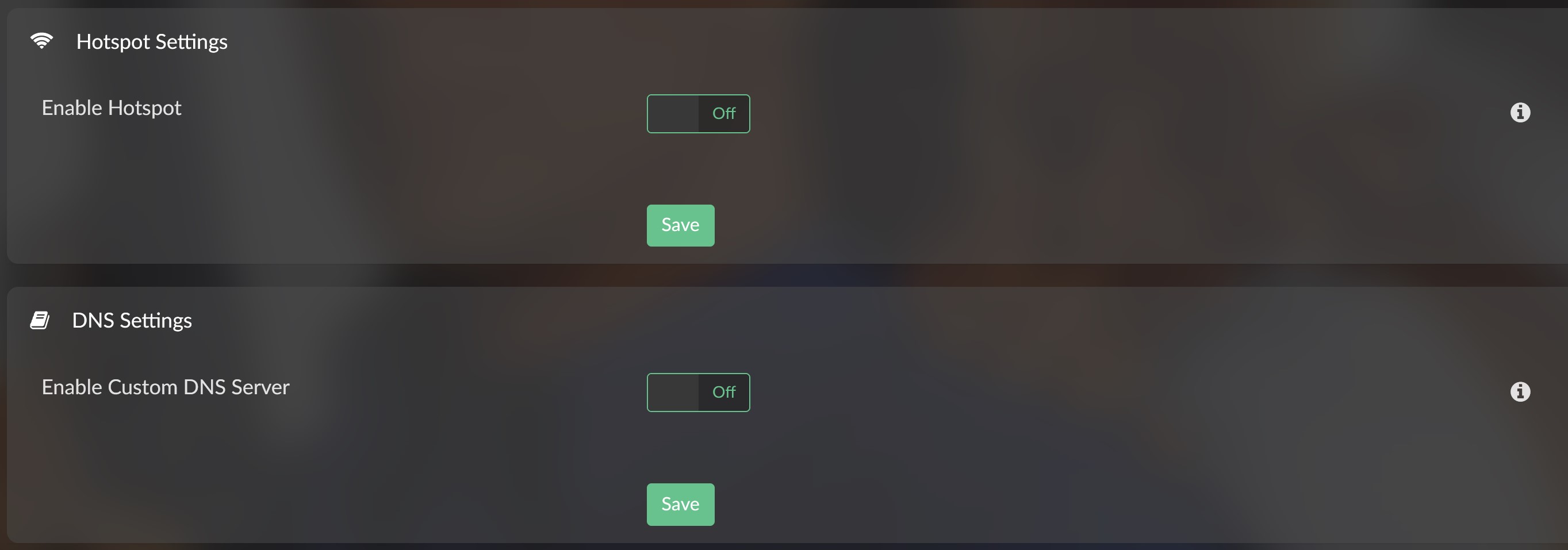

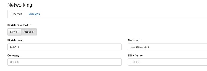

PS: Some screenshots of Roon and Rivo network settings:
