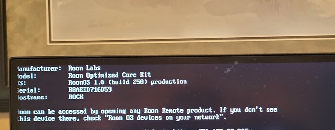

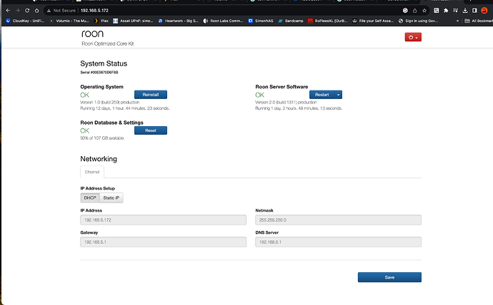

I finally got the image on the NUC and the address to the web UI. What do I do now? I tried the address on another NUC and can’t get in to the Roon UI. Both are connected on ethernet to the same network. I also need to get the codecs, and a backup I have saved on an external hard drive.

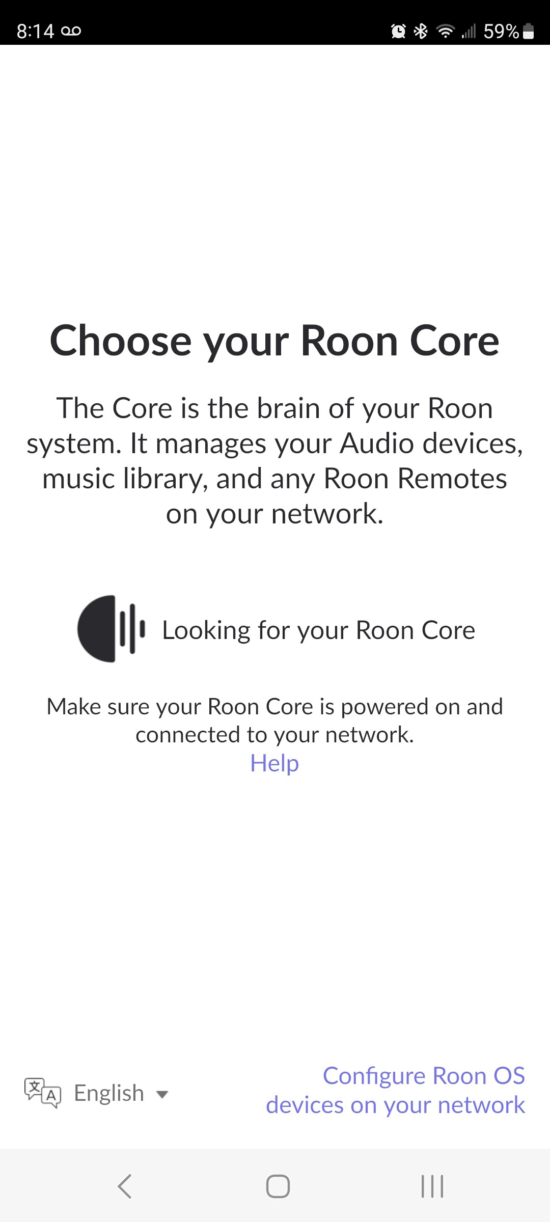

I tried to access remotely on a android phone and a chromebook and it just searches. How do I shutoff the nuc running ROCK? It gives me the http address to connect to but I still cant get on. Im about to give up which sucks because I have a lifetime membership.

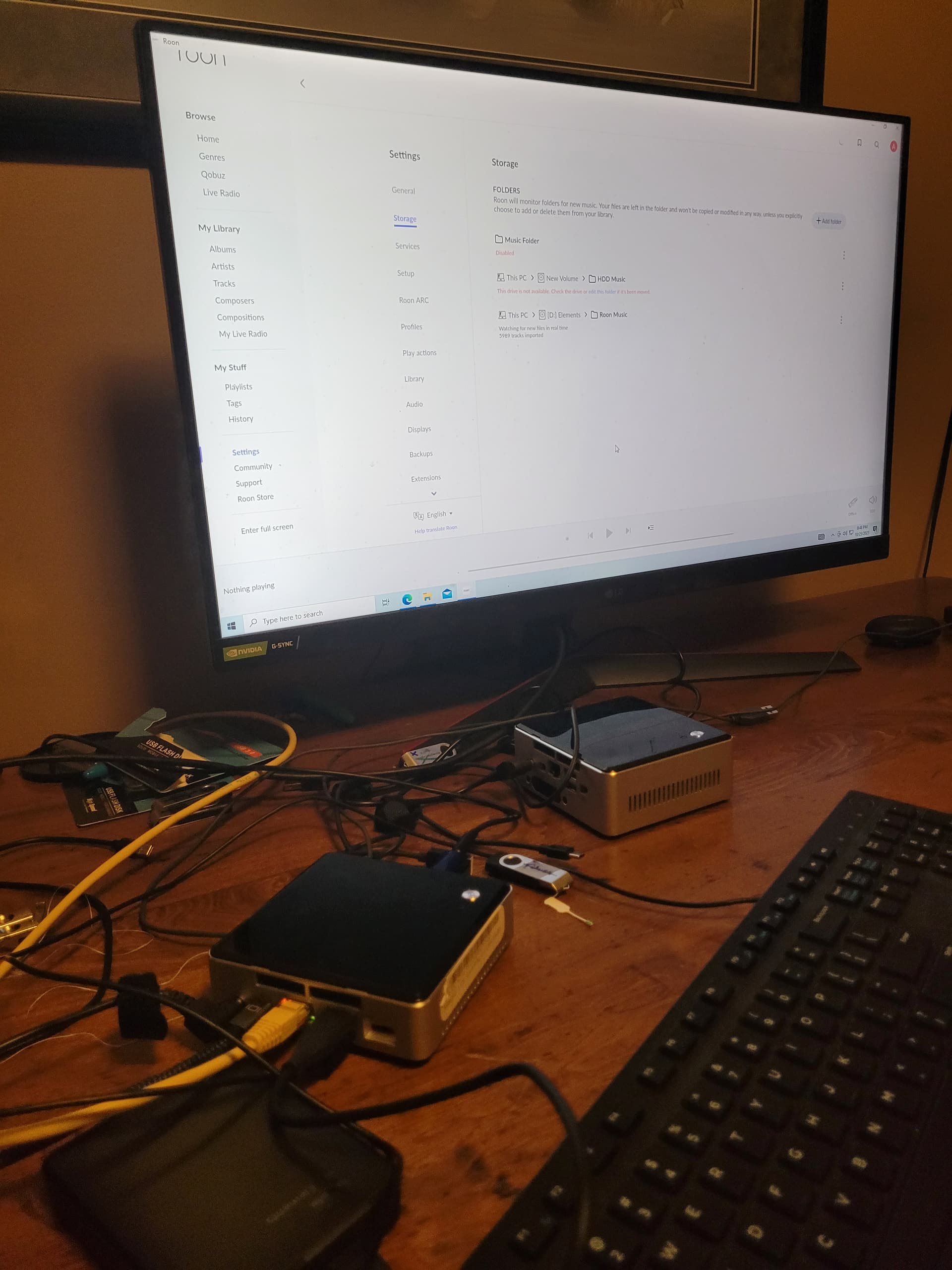

I got the backup working and its currently scanning the audio files on my connected usb HD. I’m still not understanding why I setup the other Nuc with ROCK if the other Nuc is running the core.
I want to move one of these NUC’s to another room to run with a DAC and amp/speakers but then I will need to run the External HD there as well and kind of defeats the purpose. I know I’m coming off like an idiot but I’m just not understanding how ROCK integrates.

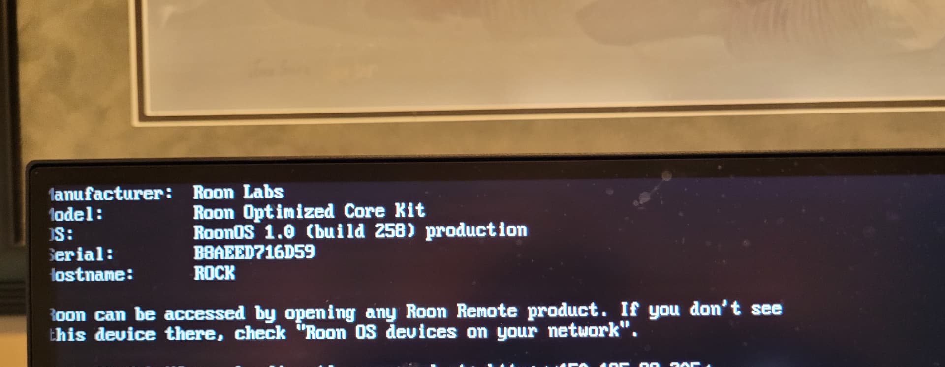

My main problem is I can’t connect to the IP address given on the NUC screen. See the screenshot above.
After I couldn’t connect to the UI via the IP address given (It’s cutoff in the screenshot) after setting up ROCK I installed Roon on the other NUC and restored a backup. Am I correct in saying that the NUC running ROCK is just a dummy computer? I can’t access any other programs on that NUC. The only way I can even shut it down is by holding down the power button.
I also downloaded fing to try and locate the IP address but for some reason the only devices detected was the NUC I was running it off of (the one I put the core on) and my router.

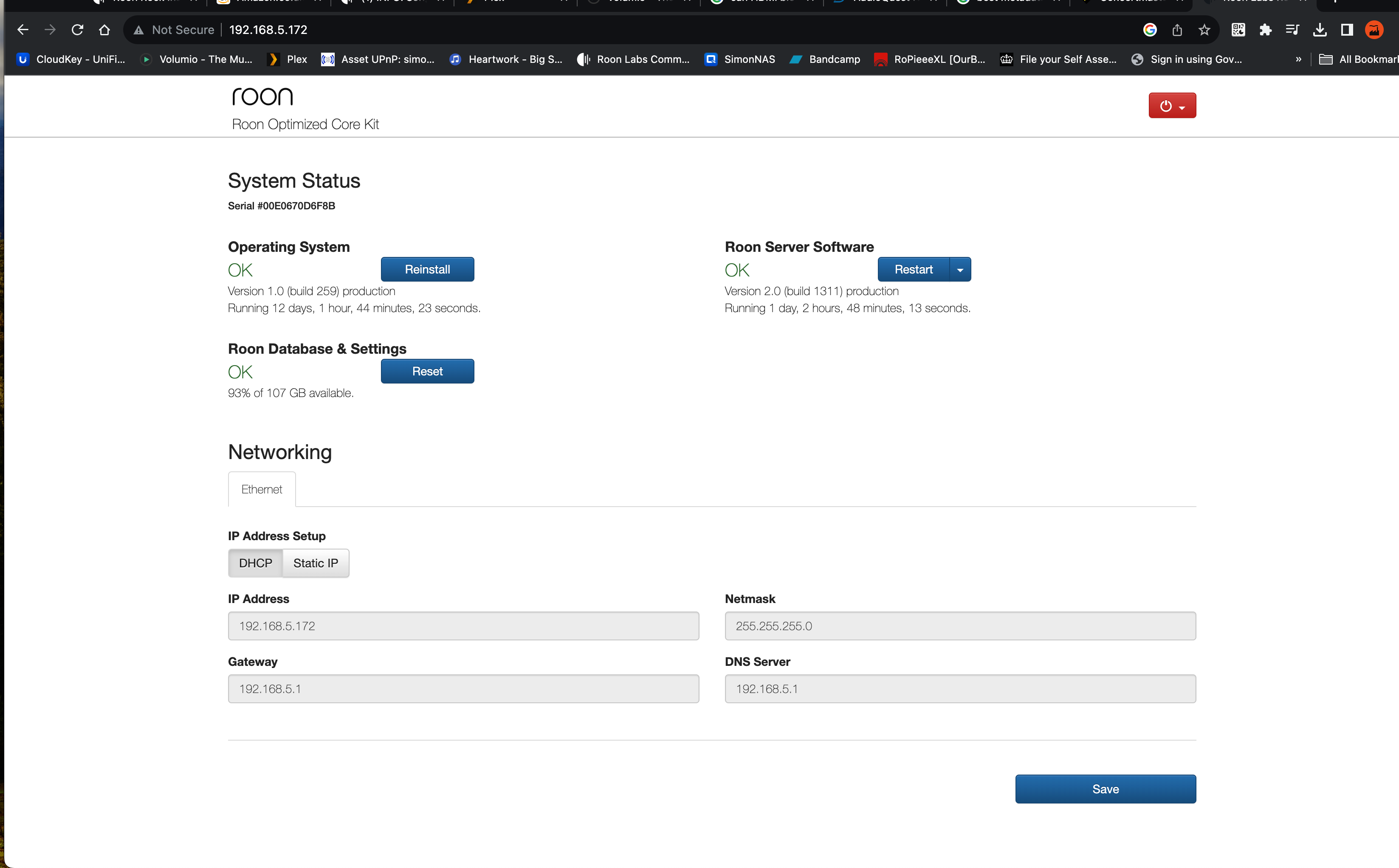

To connect to Rocks webui on either your core or endpoint just type in \\devicesipaddress ( don’t use its host name \\rock as they are both the same and it will only connect to one and you won’t know which). Rock has very few options as it just doesn’t need any more to run Roon.

You need Roon remote running on your phone, tablet or a spare windows pc or Mac. Configure this to connect to the new Rock core. Click on the help link and then choose select a new core of its not seeing it. It should show up connect to it. If it says you need to deauthorise a previous core do so.
If you can’t connect to it. Verify it’s got a valid network ip address. Plug hdmi in to tv or monitor and check the output of the screen it should show the ip address at the bottom.

I understand now that either the ROCK or the Windows NUC can be used as a core. My problem is after setting up ROCK I can’t Access the UI with the supplied IP address, on top of that I can’t connect to the core I setup on my Windows NUC via remotes(I have disabled the firewall and tried with 2 different remotes) I have an understanding of Roon as I had it running fine for close to 2 years with a Core and 3 endpoints. I am at a loss why I can’t get anything to work now.

How are you getting rocks ip address and where are you entering it?
After installation. See screenshot above. I followed the directions and entered it in my Core NUC browser.
What core nuc browser? ROCKS webinterface is accessed by a standard web browser on another device.
like below. You image of ROCKs screen didnt show any ip.
What is the windows box you showed above? Is that the old core?
TBH your really not making sense as to what you want to acheive at all. You said your Windows core had failied on you yet you see one above?

Please show the ROCK screen with the IP address it gives you. You know, the screen where you cut off the most relevant part.
Are you saying that, entering that address in a browser, you can’t get to the Web GUI?
If you can get to the Web GUI, then screen print please. If you can get to the Web GUI, then shut down all your other Roons, i.e. the Windows Roon, the endpoint ROCK, and (if you’re using one) the endpoint RPi. Then try to connect to your running ROCK from your Android Remote, as an experiment.
Settle back, take a blow. You seem to be (temporarily) tangled up in your shorts. The fact the ROCK returned an IP address means that it installed successfully.

Thanks Geoff, Looks like I need to figure out my Network connections before I try and configure Roon. This explains why I was having so many issues.
Thanks everyone. For the record I’m not an idiot, well partly because my network was setup incorrectly. Once I properly connected my router I was easily able to find the UI to configure ROCK. Now on to configure the Codecs and get my Rpi with Ropieee running again.
