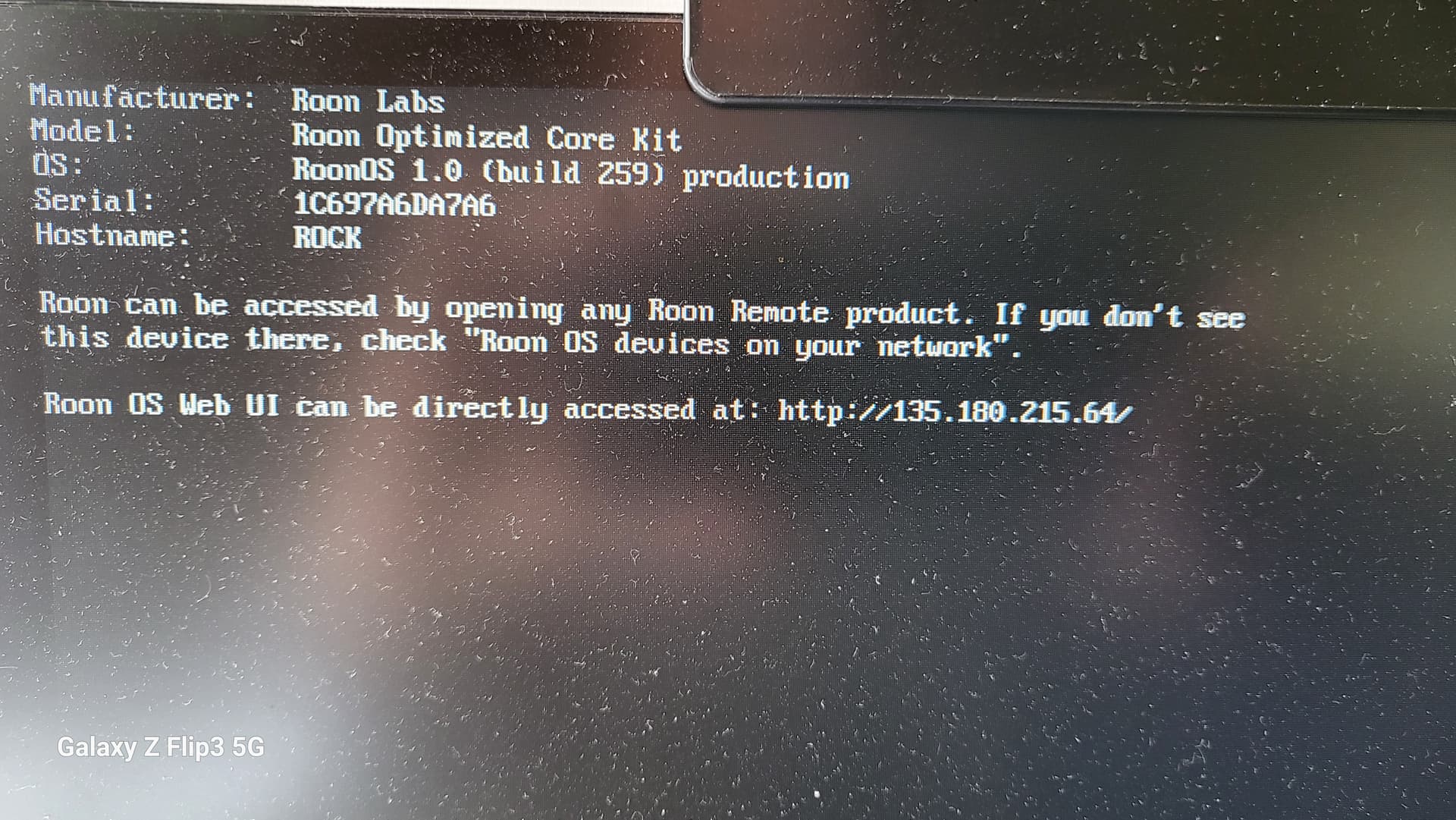

Roon login screen clears my login info wo an error mssg. Main issue my Roon ROCK no longer shows on my network. Nothing changed. I even turned off firewall. I can see info page off 3nd pc fir build etc
NUC i7, TP link decco 6E mesh axe5300. No changes.
Is the IP address in your screenshot the same subnet as the computer or remote you are trying to use to control Roon? If so, you “should” be able to get to the ROCK WebUI by entering that IP into a web browser if your firewall allows it.
It will look like this:
Here’s info on the firewall exception if you need it:
Hello. Yes, got this same ROCK WebUI screen below from another pc (DELL) on same network/subnet so it’s on the same network/Subnet as master NUC ROCK. I turned off all the firewalls on the pc and deactivated Avast.
I tried all the options on that Roon Opt Core Kit screen incl power down/up via red.
Network does not list NUC ROCK.
Note: Everything was fine a week ago, then access started getting sporadic. Nothing on network changed.
Tried to logon on the original Remote iPad and this Dell desktop, accepts my logon/pwd, but clears screen as if I didn’t enter anything. No error mssgs.
Thanks for any help. Do I need to wipe out my NUC Roon ROCK server and start again? My database is assocated with my Roon logon so I won’t lose any favorites, lists, etc?

Thanks for your message. That 135.XXX.YYY.ZZZ IP address looks very peculiar, I would try to see where this is coming from, as the rest of your devices are on a 192.XXX.YYY.ZZZ subnet. Has there been any software updates to the Deco? If you connect the ROCK to the main router and not a satellite, does it then function?

Can you post what the IP is of one of the machines on your network? like your Dell PC? Or look in the router admin pages for what IPs it has assigned to different devices.
It sure seems like you have multiple subnets going on as the IP from your screenshot shows your Rock is 135.180.215.64 and your gateway is 135.180.212.1. Which means they are on different subnets. The first three sets of numbers (xxx.yyy.zzz.___) need to be the same for the devices to be in the same subnet.
Also, the TP-Link FAQ for your mesh router says it usually has 192.168.0.xxx as default subnet.
How to find your TP-Link Router’s IP address
Did you change this?
All 3 devices can access the Roon Rock NUC’s WebUI using ip addr 135.180.215.64

Wow that is “interesting”, you have at least five different subnets using at least three different gateways. As has been said, the Roon server will only work if it is on the same subnet as the Roon remote and endpoints. Which is NOT the case according to your information. So you need to sort that out.
The VPN is not helping you here. Can you disable it for now for troubleshooting?
The only address that makes sense is the one for the Ipad.
Where is the Roon server device plugged into?
Do you have an ISP modem? Or are you on fiber with no modem and are only using your own router?
Like @Mike_O_Neill said maybe try restarting the whole network starting at the ISP modem or router.
If this does not work you could go into your router and assign IP reservation for the NUC to get it to the “base” subnet of the router (which I suspect is the 192.168.68.xx) and change its gateway to the 192.168.68.1.
BTW, you can access the webUI because you are using a browser to navigate manually to its address. This is a separate issue to the server being able to communicate with endpoints and remotes.

Nuc Roon Rock 135.180.215.64
Ipad pro 192.168.68.85
Cell 192 168.68.74
I never changed the Roon Rock NUC ip nor do i know how to.
So, something more than likely changed (maybe in the background?) that resulted in your NUC getting assigned an IP that no longer works for you is my guess.
If all the remotes you were using are on the 192.168.68.XXX subnet, then, in my mind, there are two ways try to address this.
The first, and my recommended way, is to get into your router and set-up an “IP reservation” for the NUC using 192.168.68.(whatever IP is open) so that the NUC is on the same subnet as your remote devices. I am not familiar with TP-link Decco, but they have instructions for how to do the reservation on their site:
The second way is to go to the NUC webUI and change the setting to Static IP (from its current setting of DHCP) and change the IP to the same subnet (again the 192.168.68.whatever IP is open). It would also be advisable to change the gateway, Netmask, and DNS server to match what your IPAD or cell are using.
To do the second method on the webUI page for ROCK change the networking to “Static” and enter the address, gateway, netmask, and DNS server, once you apply the change and reboot the NUC you “should” be able to control it with you remotes. Alos, the webUi would be accessed at the new address of course.
The reason the first method is preferable is that, if there was ever an issue with the network/router/change of ISP/etc. you can replace the router and redo the reservation (with whatever would work for the new setup) and the NUC would not care as it is still in DHCP ( a dynamic method of assigning IP addresses where the device asks for any available IP instead of demanding a specific one. You control what available to the device on the router side.)
If you were to set the NUC to static and ever had to change the router (like get a new ISP, or just upgrade it to a newer one) you might have to jump through some hoops to either reset the network on the NUC or remember the IP you assigned and then assign in the new router. This also assume the new router would use the same subnet as the old one.
Sorry if that got a little long but thought you might want to know a little more about it.
