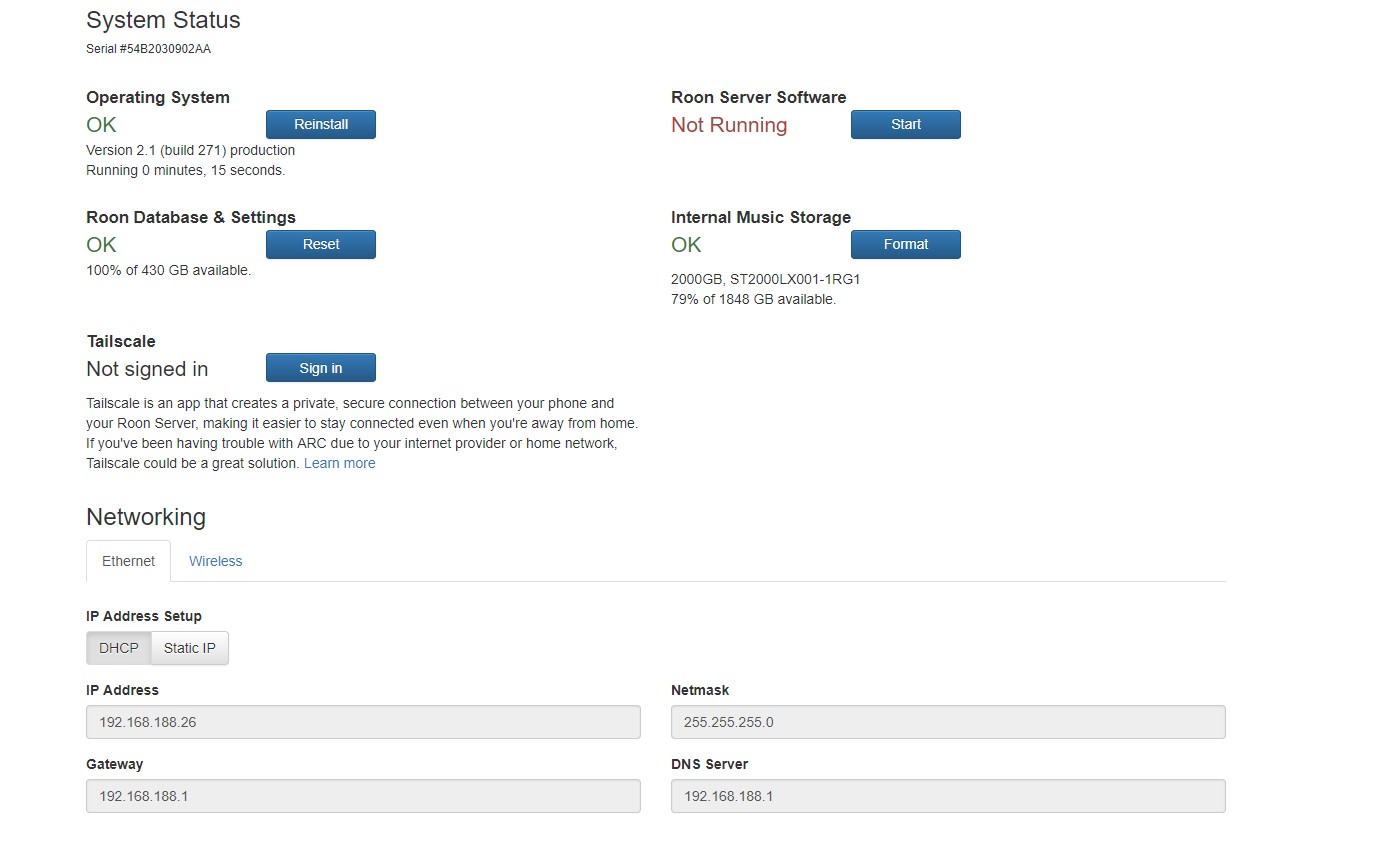

Thanks for the screenshot, that’s very helpful. Good news first: your system, Roon database, and internal music storage are all showing OK and intact, nothing appears to have been wiped by the recovery process.
The actual issue is narrower than it first looked: Roon Server Software itself shows “Not Running.” Could you please click the Start button next to it, if you haven’t already? If you have already tried this, could you please let us know exactly what happens, does it start and then flip back to “Not Running” after a moment, does it stay on “Not Running” the whole time with no visible change, or does any error message appear?
Please also let us know if you’ve tried clicking Operating System reinstall yet at all?

I tried to restart but i always get the following message.
Restart Error
Roon Server could not be successfully restarted. Please try rebooting, or contact support.
I have tried rebooting. No avail.
Reinstall server software: no avail
