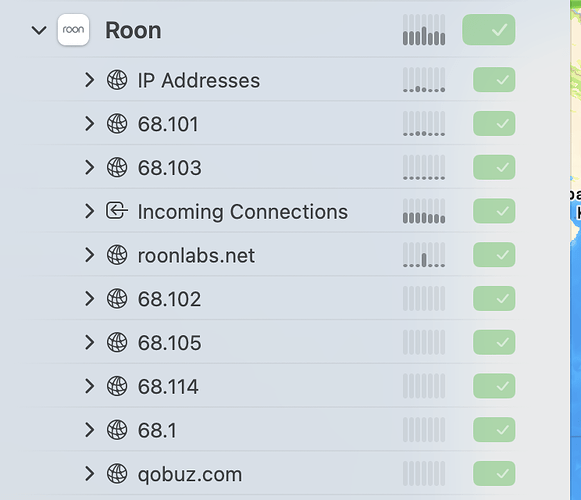

I did run Little Snitch just to see what it does call and it seems all standard.
The vast majority of pings are to local devices. A few to some Cloudflare and Google servers - but nothing out of the ordinary.
The only interesting observation of was the frequency its calling devices and getting incoming requests from devices in my local network - I guess just getting state of the endpoints. But it is very frequent:
