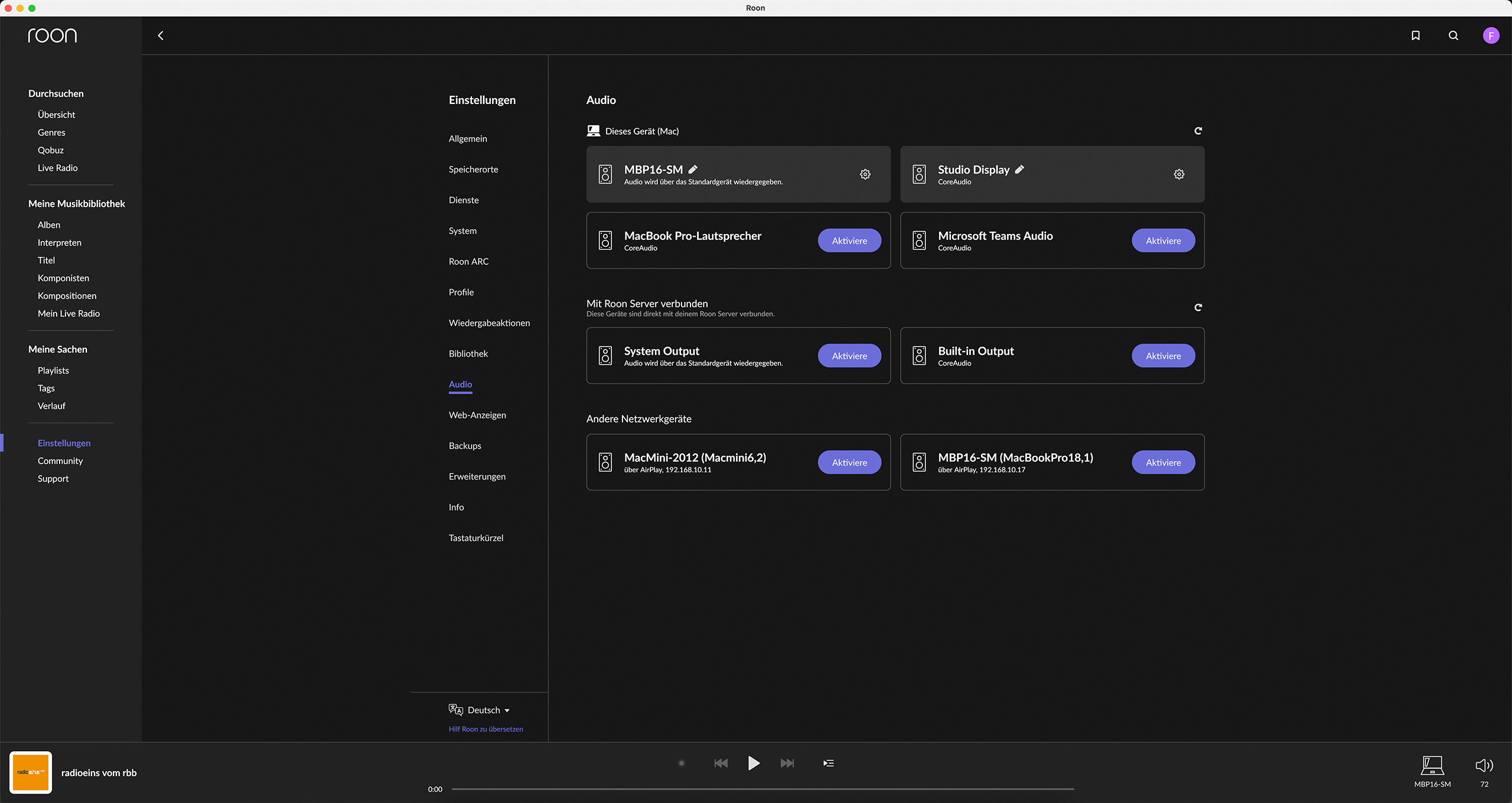

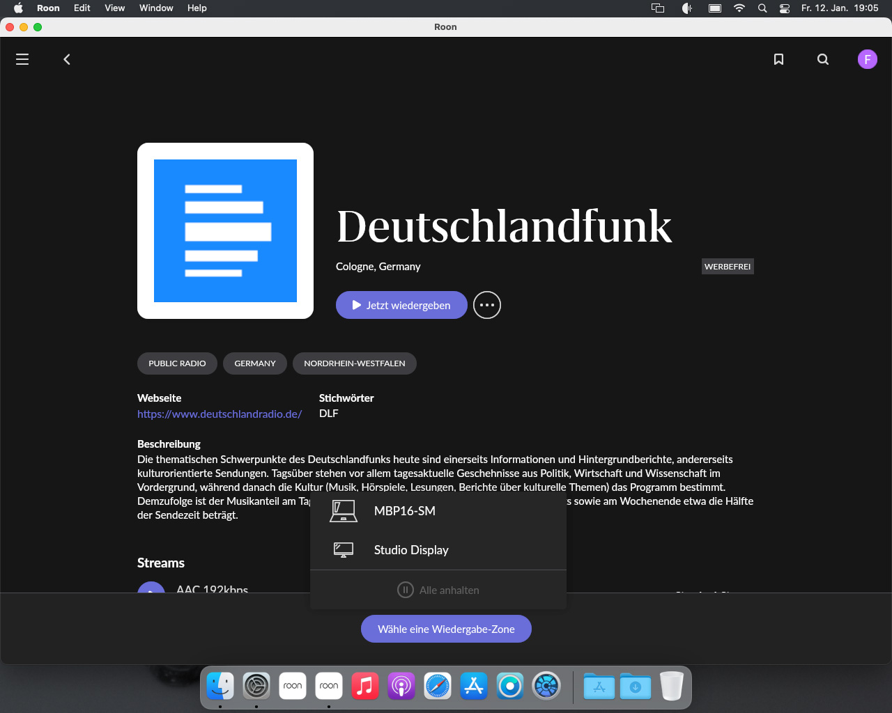

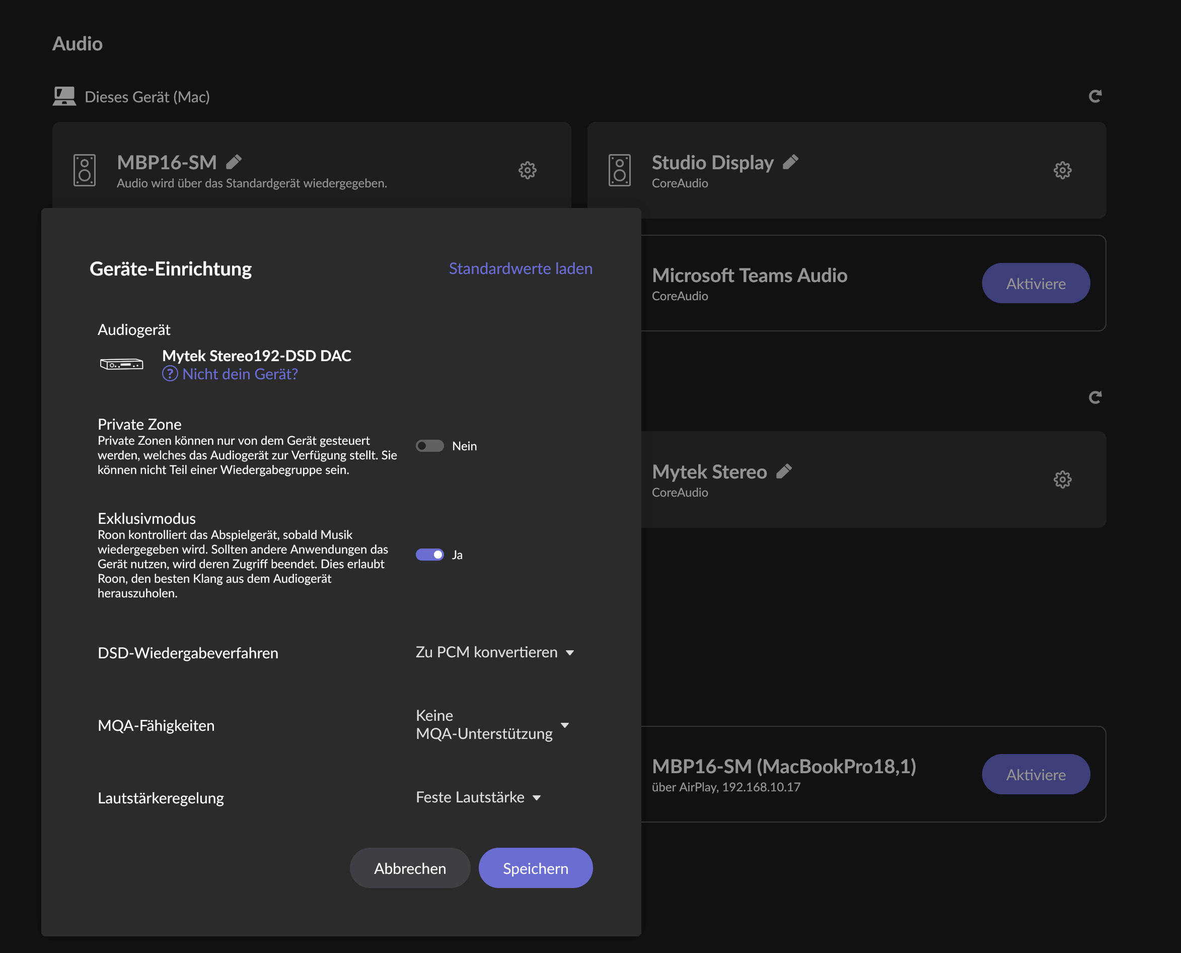

Everytime I turn the Mytek on, Roon Server cannot recognize it.
I’m forced to restart Roon Server.

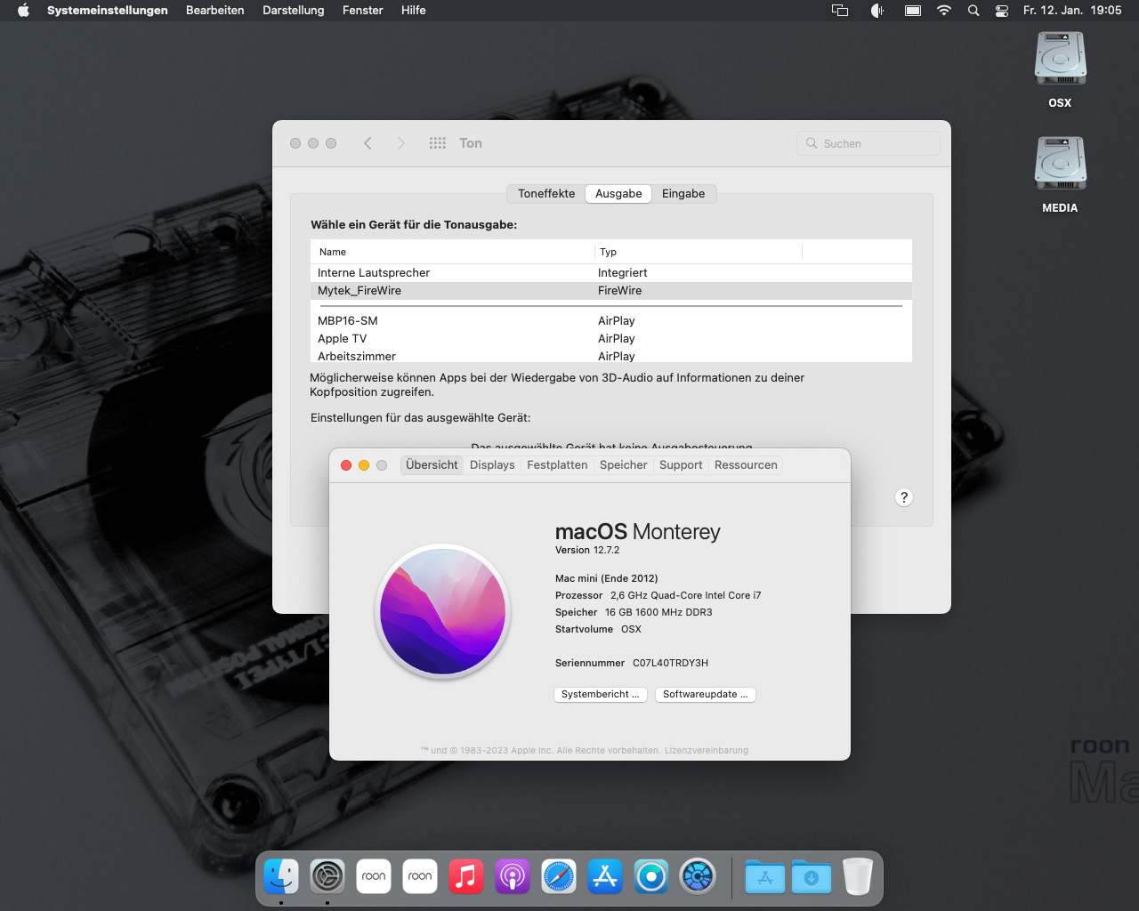

The OS has no problems to see the Mytek, it is only Roon Server…
Hi @Steffen_Meier,
Thank you for your patience while we worked through the queue. Please provide a screenshot of the audio settings in Roon and we will be able to troubleshoot further.
Hello Daniel,
thank you for getting back to me.

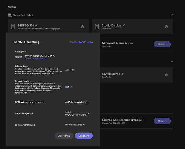

I tried different settings for the Mytek Device (exclusiv Mode on/off etc.)
but the behavior doesn’t change.
It was flawless untill one roon update in late 2023.
Best Regards. Steffen

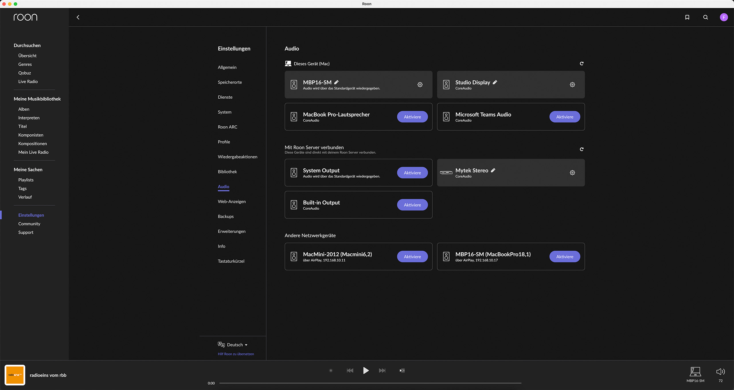

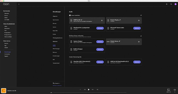

Hi @Steffen_Meier,
Thanks for the screenshots. Try opening the terminal and typing sudo killall coreuadiod this will restart your CoreAudio. That should hopefully fix the issue.

I know that the Mytek is not USB class compliant -
thats why I use it only with Firewire.
The device has no USB connection and a USB Driver is not installed.
(Myteks USB-Driver does not support MacOS since El Capitan)
My impression is, that after powering the Mytek on, it will take some time (15 Minutes) until the server (sometimes) recognize it.
It seems that the Firewire Port and/or Core Audio + a connected Firewire Device is not overseen by roon server?

Two other options are 1. 1. Delete all DSP for the Mytek FireWire Zone. There’s a trace showing the Mytek disconnect from RAAT right after it loads the DSP configuration.
2. If that doesn’t work you can generate a new RAATServer instance on your device by following these instructions, but please be aware that this will reset your Roon Settings → Audio Tab to factory settings and I would advise making a backup of any custom DSP settings you have:
