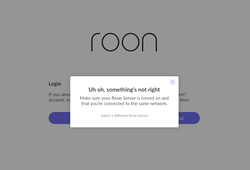

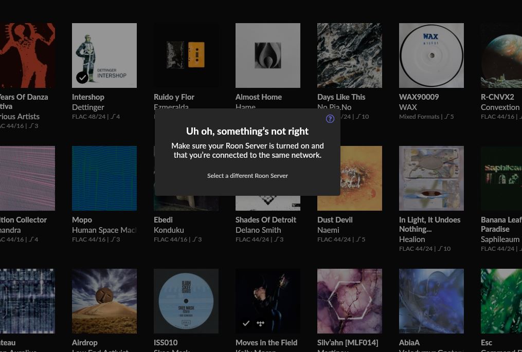

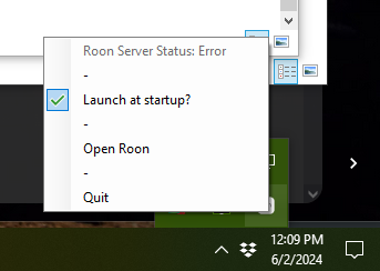

I'm running Roon Server and App on a Windows 10 Pro PC and last week the app only demonstrates the loading icon, followed by "Waiting for your Roon Server". Roon server tray icon shows Roon Server Status: Error.
I have reinstalled Roon 3 times, it will briefly load, then will say "Uh oh, something's not right. Make sure your Roon Server is turned on and that you're connected to the same network" despite it being on the same PC, and checking the Tray Icon again will reveal Roon Server Status: Error.

RoonServerTray
I reviewed the settings on Windows Firewall after reinstallation and the Roon applications (raatserver.exe, roon.exe, and roonappliance.exe) are all still permitted to access the network. Interestingly, RoonServer is no longer on the list of possible applications to choose from on Windows Defender Firewall.
