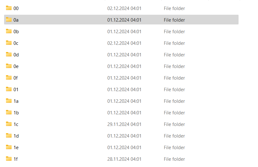

Many thanks. This sounds like the solution for me. I will give it a try. One question: the backup is in a separate shared folder in the 1522+ and looks like a folder with cryptic numerical name as shown in the attached image. So when I do a fresh install of the server, I will be just pointing there and the install creates a new database in the SSD (assuming I fixed or replaced the damaged one already)?

Typical backup file looks like this (similar to yours)
when you open it, it looks like this
pick a file that goes back a few days to avoid loading a corrupted file again.
Or simply try to point to the top folder and see what happens. It cant do anything bad.

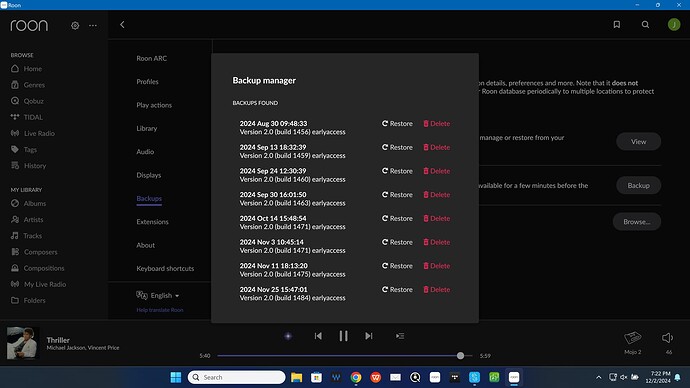

My backup files look like this. I think you’re in a level or two too deep.
Sure looks that way from the Roon GUI. With a new Roon installation you do not have this history and you have to go and look for the file location on your computer. Mine resides on a shared drive on my NAS with a backup copy on a USB disc.
Click on “Select fhis Folder” when you get to the RoonBackups. Don’t click on RoonBackups.
Note: Don’t get confused by my path. I made a folder called “Roon Backup” (in purple above), but the Roon created folder is RoonBackups where the arrow is pointed.

Yes, on a new installation you will have a history of one backup if you have made one. They are in the RoonBackups folder created by Roon when you do the first backup. Access it by clicking on Select this folder.
