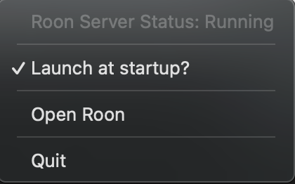

When RoonServer is open and visible in the menu bar on your Mac, what do you see under “Launch at Startup?”
Screenshot 2025-01-22 at 12.13.30 PM
I’d also verify that Roon is a login list item in Settings → General.
Please let us know if this helps.
Hi @connor thanks for the suggestions. I confirmed that Roon still has local network access, that the Launch at Startup? option is still checked, and that Roon is a login list. When I restart my computer, it works fine. The issue seems to be if I need to quit/restart the Roon server for one reason or another. I’m not able to restart it without restarting the entire computer.
