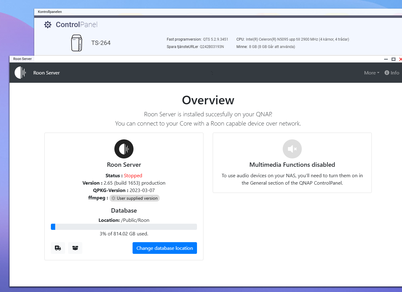

Tell us what's going on · After updating to the latest software, Roon server wont start. It is running on a Qnap TS-264
Tell us about your home network · Unify Cloud Gateway Ultra
The Roon Server package no longer works, please switch to the official Docker image to run Roon Server on your NAS. See also:

You’ve essentially migrated your RoonServer from the QNAP bare metal installation to the container.
You’ll need to restore a Backup of the original database to the new server; this will bring back your library, saved settings, play history, etc.
Here’s an article outlining the broader migration process. In your case, you migrated to the docker:
