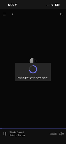

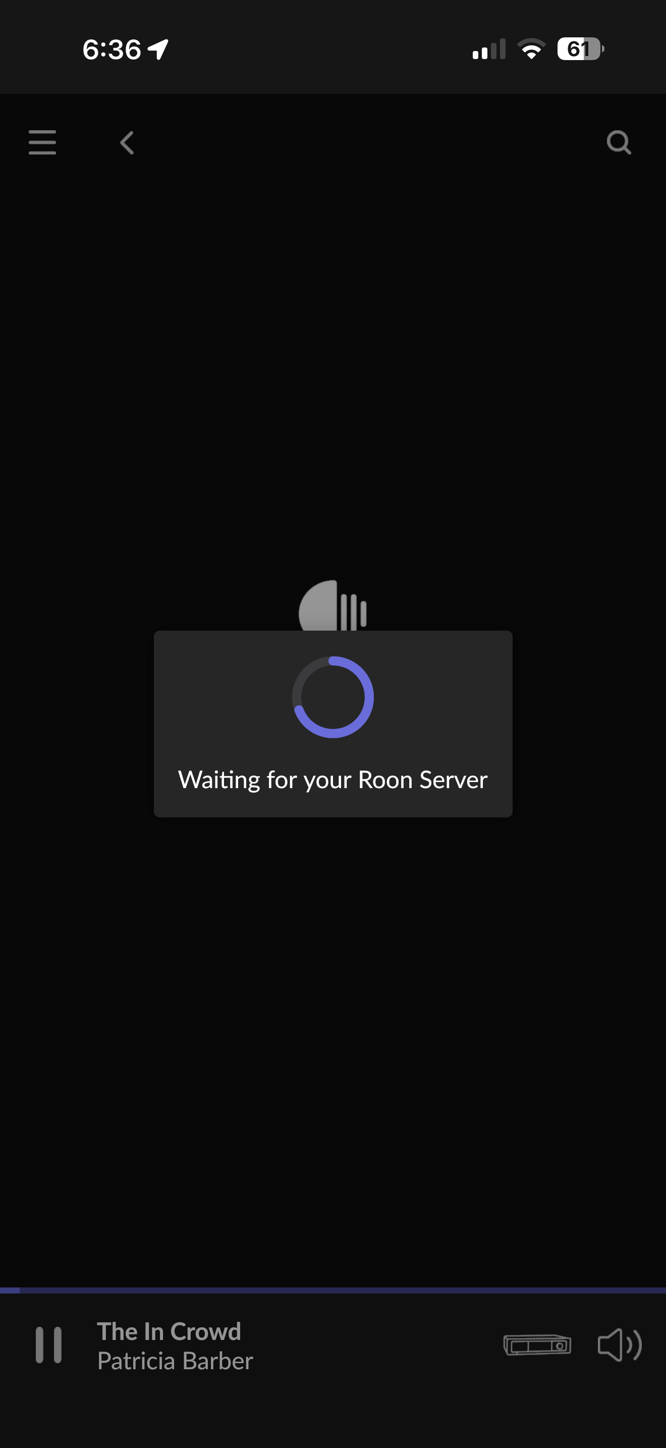

Is Roon Server running?
· "Waiting for your Roon Server"

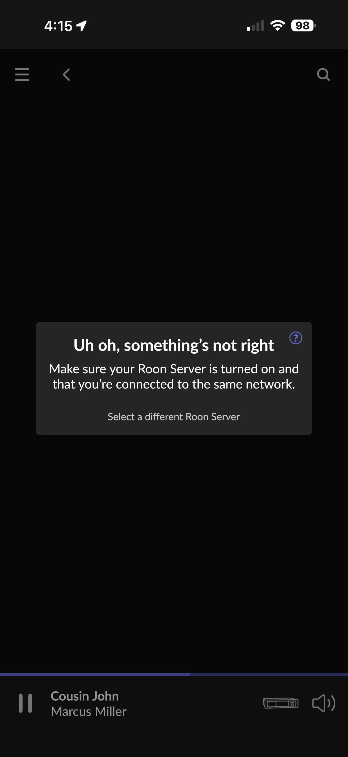

What happens if you press the "Select a different Roon Server" button?

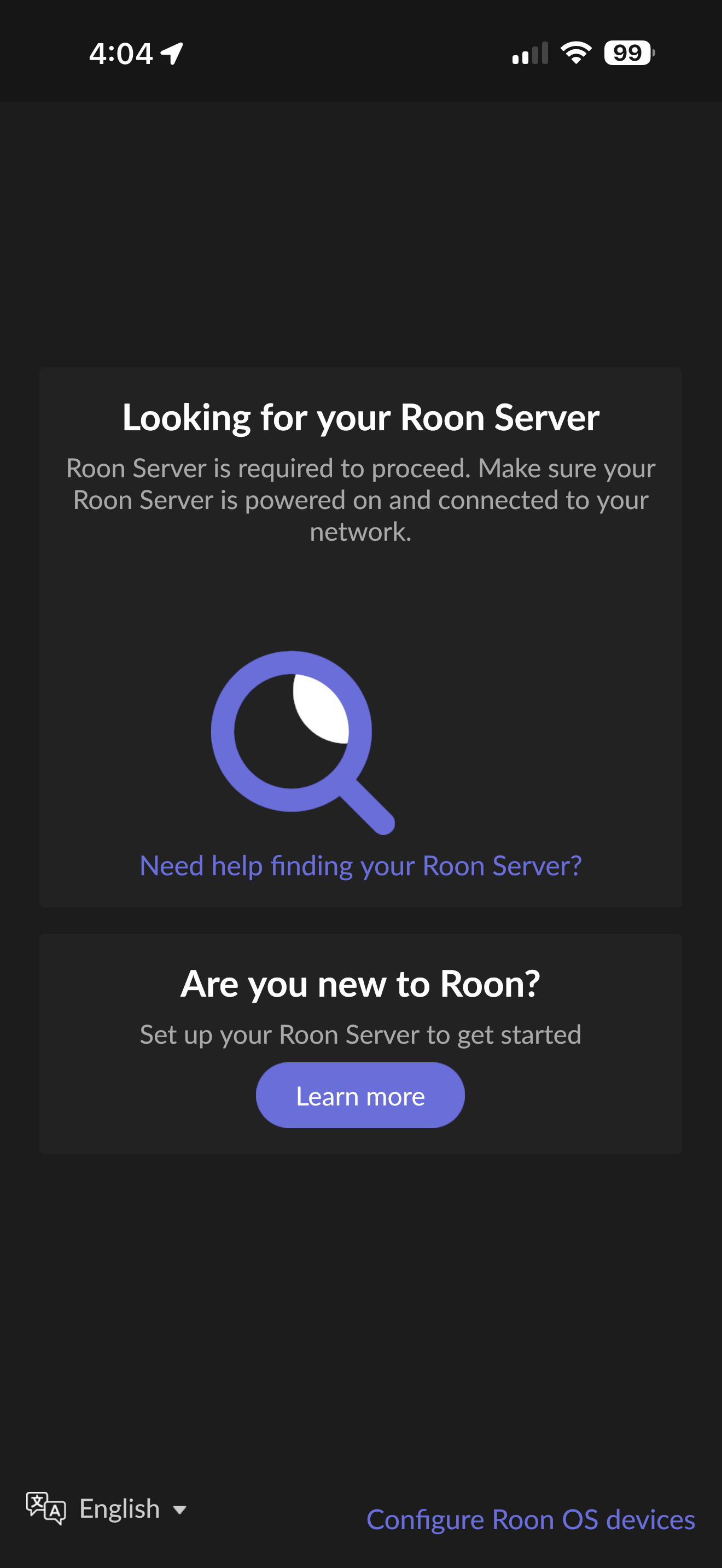

· I don't see Roon Server.
Please try to restart your Roon Server by closing the Roon app in the taskbar or rebooting your Roon Server machine.

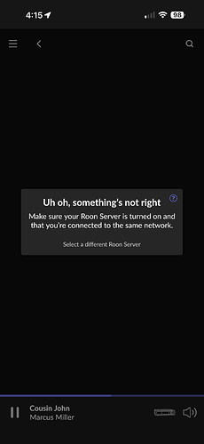

Roon server is not stable following update
Mac OS 15.4.1 running roon server, remote is iOS
Hello @Reese_Gautschi ,
Thank you for reaching out, and sorry to hear about the trouble after the update.
Could you kindly clarify what you mean by “not stable”?
  • Are you experiencing frequent crashes or restarts of the Roon Server?
  • Does the Remote app fail to connect or disconnect intermittently?
  • Are there issues with playback or device discovery?
Any additional details you can provide would help us isolate the issue more efficiently.
Unstable - The server can’t be reached by Roon remote. No devices are available. Song stops in the middle.
