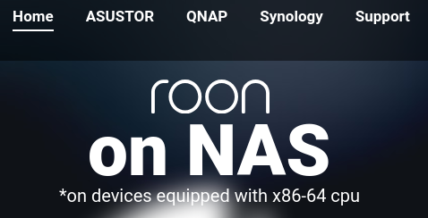

It is right there, several times:
grafik
grafik

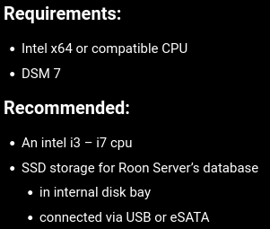

And on Roon Labs’ site:
grafik
