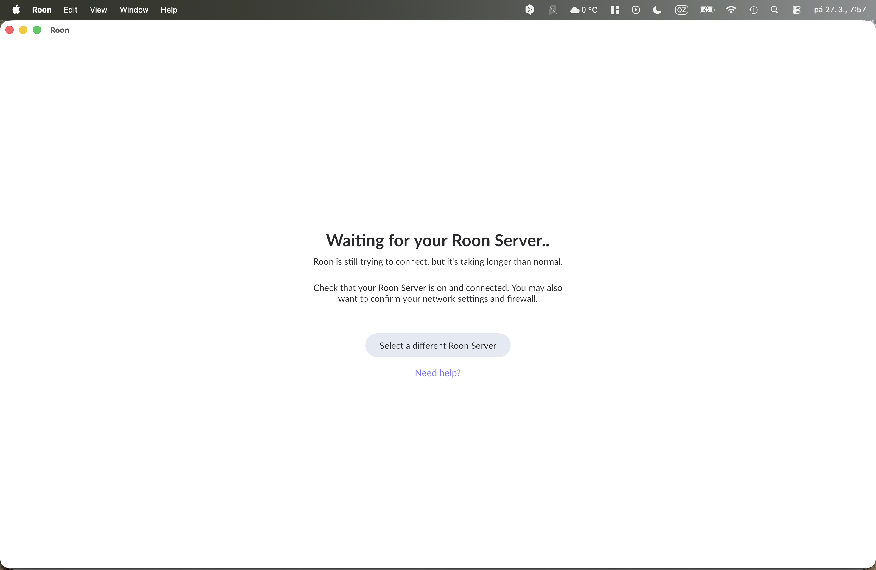

· I have installed Roon on MacBook Air. I use it as my server to play music via MacBoo. By the start up appears" Waiting for your Roon Server..." and Roon does not start.
· I use Wifi router FRITZ!Box 7530JW.
Hello @Petr_Lukes ,
Thanks for reaching out to our support.
It looks like RoonServer is not running on your Mac.
Please execute the following command in terminal to start it :
ROON_APP="$(find /Applications -maxdepth 2 -type d -name 'Roon.app' 2>/dev/null | head -n 1)"; [ -z "$ROON_APP" ] && ROON_APP="$(find /System /Users /Volumes /Applications -type d -name 'Roon.app' 2>/dev/null | head -n 1)"; [ -n "$ROON_APP" ] && open "$ROON_APP/Contents/RoonServer.app" || echo "Roon.app not found"
Let us know please if that has helped.
Thanks.
Solved. Many Thanks!!!

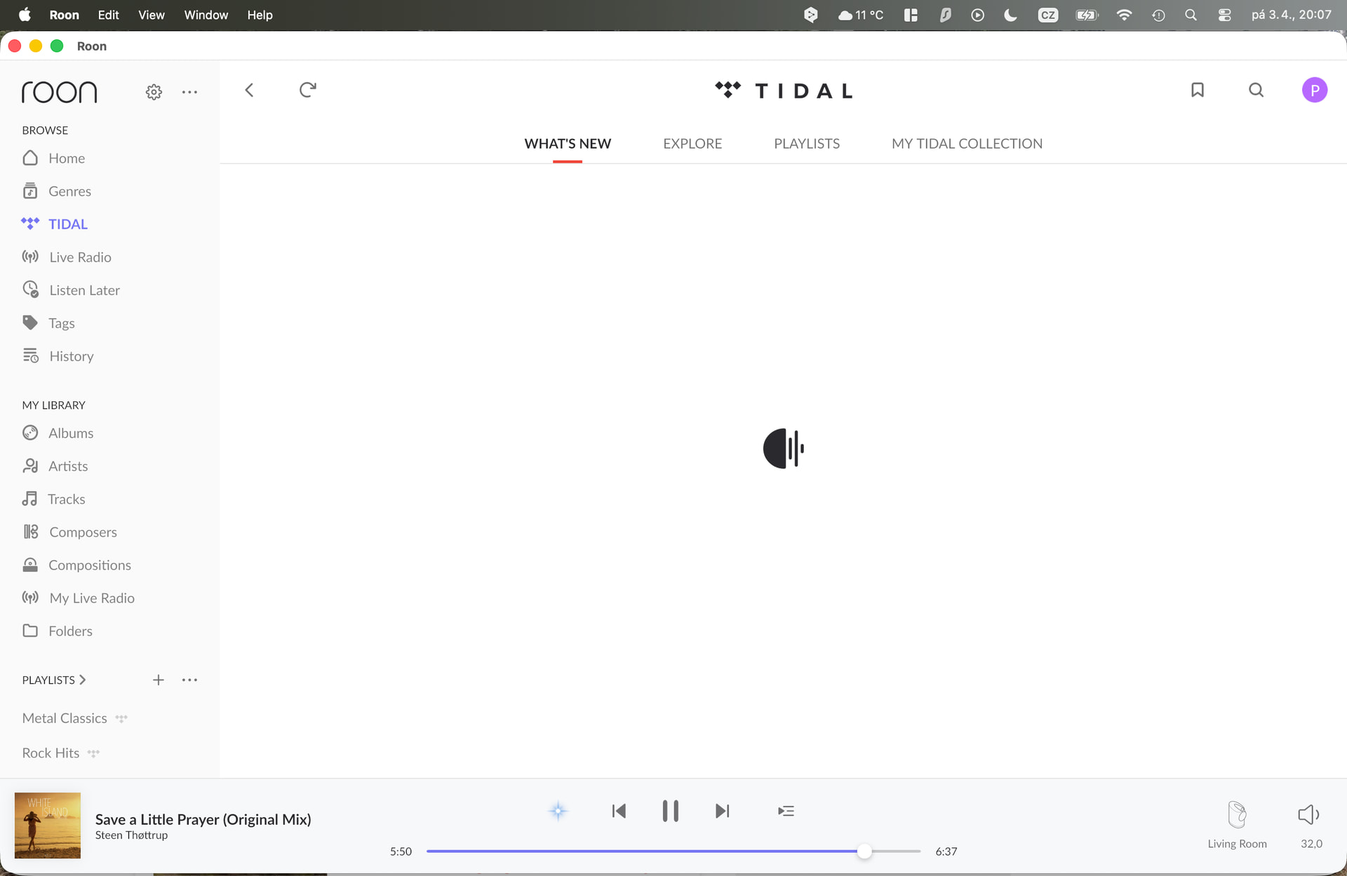

Hi Alex, thank you for support! I found the icon in the folder. If I understand it correctly, I have to now after each restart launch RoonServer as well- right? OK, I can live with that. But unfortunately synchronization with Tidal does not work. I have blank “What’s” new as well as “Playlists”. See my screenshots.
Hello @Petr_Lukes ,
Thanks for getting back to us!
To investigate this issue, could you please bring your Roon Server back online on your MacBook?
This will allow us to pull the diagnostic logs from it.
Also, while waiting for us to review the logs, we recommend that you try signing out of Tidal and then signing back in.
Thanks.
Hi @Petr_Lukes,
Diagnostics have reached out server and we’ve had a chance to inspect logs. Thank you for your patience.
Here’s what we’ve found:
Roon is trying to safely write to its database, but the final step (renaming a temp file into place) is failing because the target path isn’t available. It’s a repeating atomic file move error. This most commonly arises from a disconnected or unstable drive/mount, or a damaged database directory.
Have you recently migrated RoonServer between machines, or restored a Time Machine backup on the current machine? Did you install Roon in a specific, custom location on this Mac?
Do you have both Roon and RoonServer added as login items on this Mac? This can cause the GUI to launch without establishing a connection to the server via the loopback. Try just adding RoonServer to the list of login items.
If you have a reliable, recent Backup, you can try a database refresh on this Macbook:
Let’s try a fresh database and see if your issues persist:
  • Exit out of Roon + RoonServer (from taskbar area)
  • Find the folder that says “Roon Server” (not “Roon”)
  • Delete the “RoonServer” folder
  • Verify if the issue persists on a fresh database before restoring the Backup
We’ll watch for your reply. Thank you!
