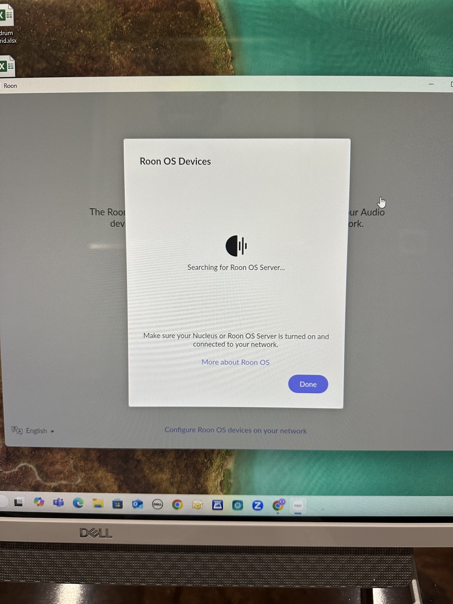

Hi Daniel.
Thanks for the link to the article. I followed the directions and selected configure Roon OS devices and it just gets stuck searching for Roon OS server. I’ve attached a screenshot.
Please advise if there’s something else I need to try.
Thanks

Hey @Bob_OBrien,
Thanks for the follow-up! You can also access the webUI via a web browser:
  1. Typing in the IP Address of the RoonOS Device in a Web Browser
  2. Typing the hostname of the device, for example http://nucleusone
  3. Typing the .local suffix for the device, for example http://nucleusone.local
Are you able to access the webUI with the above?
If that doesn’t yield any results, the best next step would be to hook your Nucleus up to a monitor via HDMI (while still connected to your router) and share a screenshot of what you see. We’ll be monitoring for your reply! :raised_hands:
Hi Benjamin.
I don’t know the IP address of the Nucleus, but I tried options 2 and 3 and and for both I get a site can’t be reached message. I then tried connecting the Nucleus to via HDMI to a monitor with the Nucleus still connected to my router and nothing displays on the monitor. I tried power cycling the Nucleus but still nothing on the monitor.
Thanks for giving that a try @Bob_OBrien!
If nothing displays on the monitor, you may be experiencing a hardware-related failure on the Nucleus. The best next step here is to get in touch with our RMA department directly, as they’re in charge of all hardware-related Nucleus issues. To do so, open the Typeform link below and select ‘Other’ followed by 'This issue is related to a physical component".
