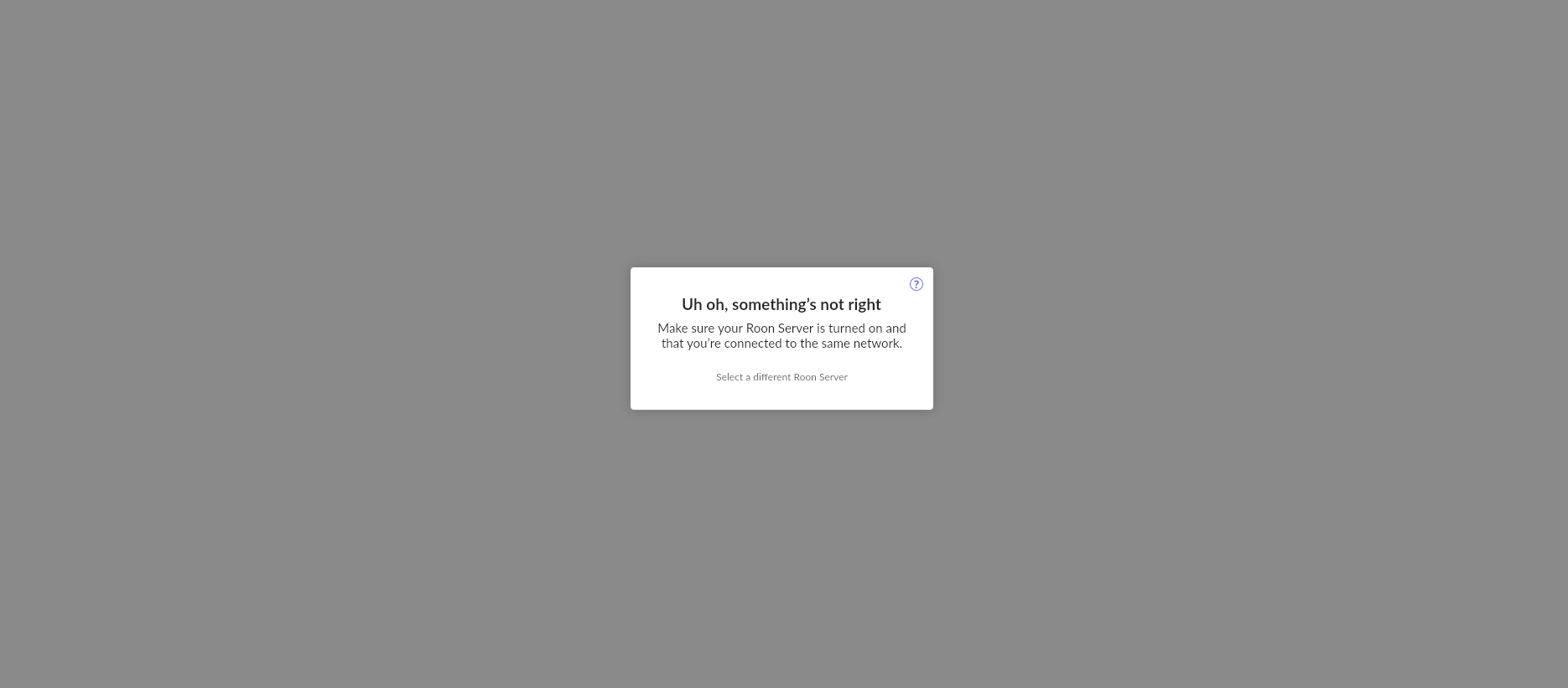

After applying the update my Roon isn’t working. I’ve brought it back to default state and just wanted to start over. I remove the 3 Roon folders in the ~/library/, and I also move all my music and their folders to the Pictures folder. So now when I start the app i have to configure it all over (fine). Login with my subscription, choose the music folder on the drive (no music currently in there). After I get in and it’s a clean slate, I start to move about 3 folders into the Music folder to add it to the library, then Roon just borks… Now this music folder is on a installed separate SSD installed inside my 2014 Mac mini.

Catalina 10.15.7, if I add a SINGLE file to the Roon library folder (I only have FLACs), it immediately crashes the the app and says something went wrong, looking for core.
