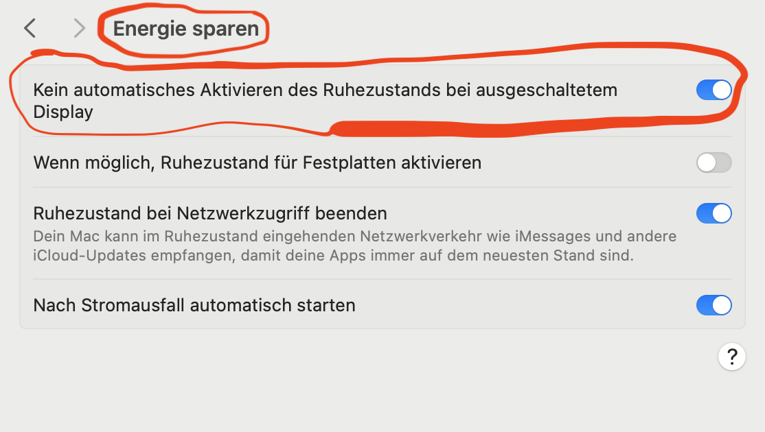

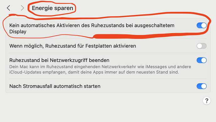

I am relatively new to this. I also use a headless M1 Mac with Sonoma. My audio devices have also suddenly disappeared. My power meter (power outlet) also showed that the Mac went into sleep mode. I then studied the sparse “energy settings” in the “system settings” and set the following: “No automatic activation of sleep mode when display is off” is activated.
Since then, everything has worked for me without interruption.

Hi,
Shame on me.
I thought to have everything done to keep the Mac mini Always on.
Havent´t seen that the Mac went into sleep, cause Power Led is on when in Sleep mode.
Should have known this, cause I own a Mac Studio as well.
I forgot to mark this setting with a cross.
Many thx for your immediate response.
