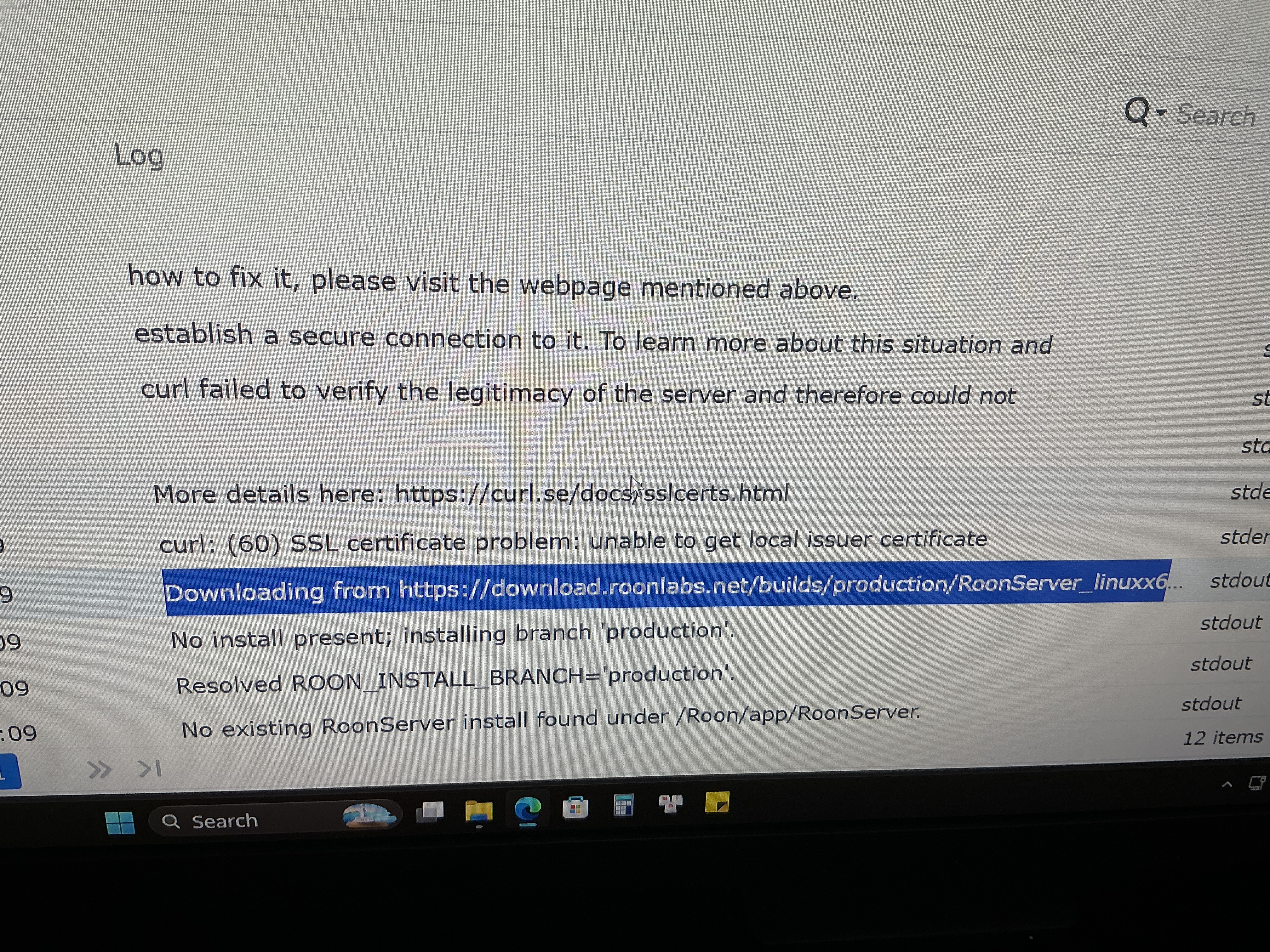

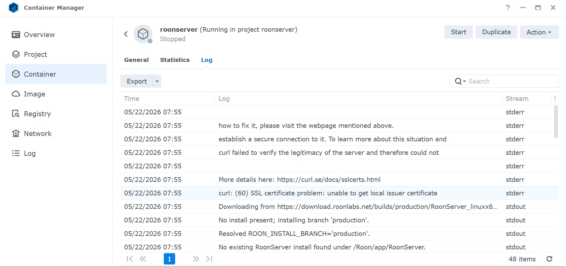

I use Xpenology DSM 7.3-86009 update 3 (up to date). Install Roon server by Docker as official guided fron Roonlabs. Roon docker start then stop immediately. Log from roon server: curl: (60) SSL certificate problem: unable to get local issuer certificate. Downloading from https://download.roonlabs.net./ …/RoonServer_linuxx64….
If I download above link on laptop, tar into Roon folder on NAS, Roon server can start but can not login by official account. Welcome back screen then loop login. Can not use.

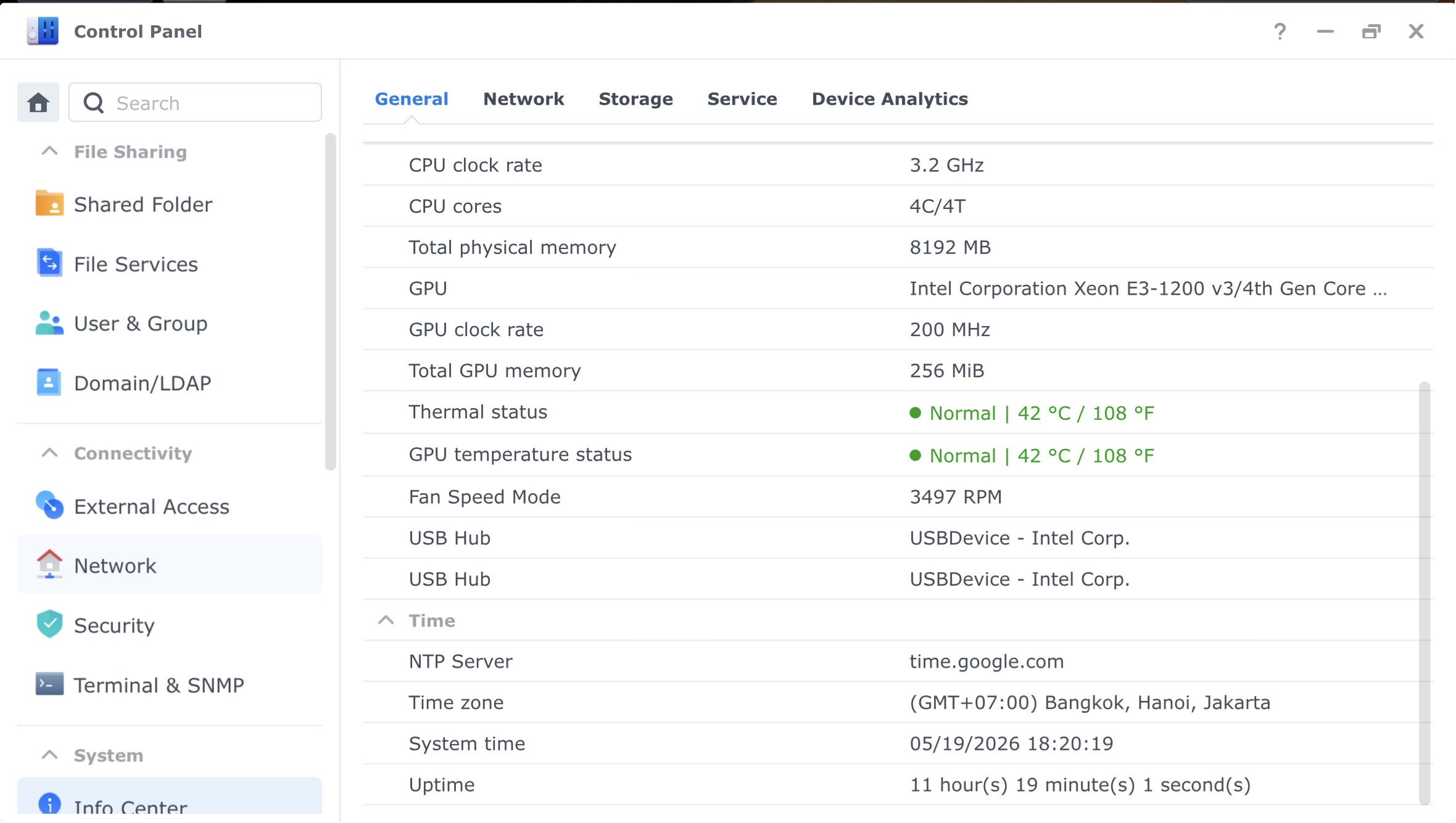

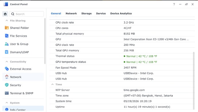

Fix the Time and Date Settings
SSL handshakes will immediately fail if your server’s internal clock is out of sync by even a couple of minutes.
  • Open your DSM Control Panel > Regional Options > Time.
  • Ensure your Xpenology build is set to Synchronize with a NTP server (like time.google.com or time.nist.gov) and that your time zone is perfectly accurate.
I configured my NAS using NTP server before install Roon as attach picture.

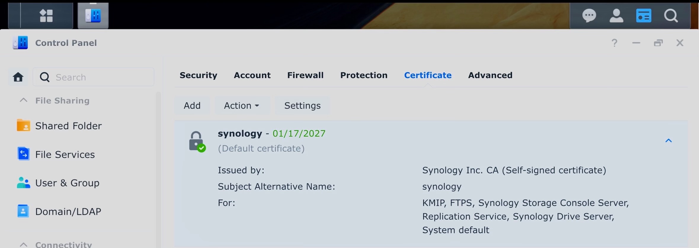

Hello,
Please try following this guide and check your SSL cert’s expiration date, and if it is still valid.
It is not work. Attach is my cert.
And I try to off firewall. But it is same
error

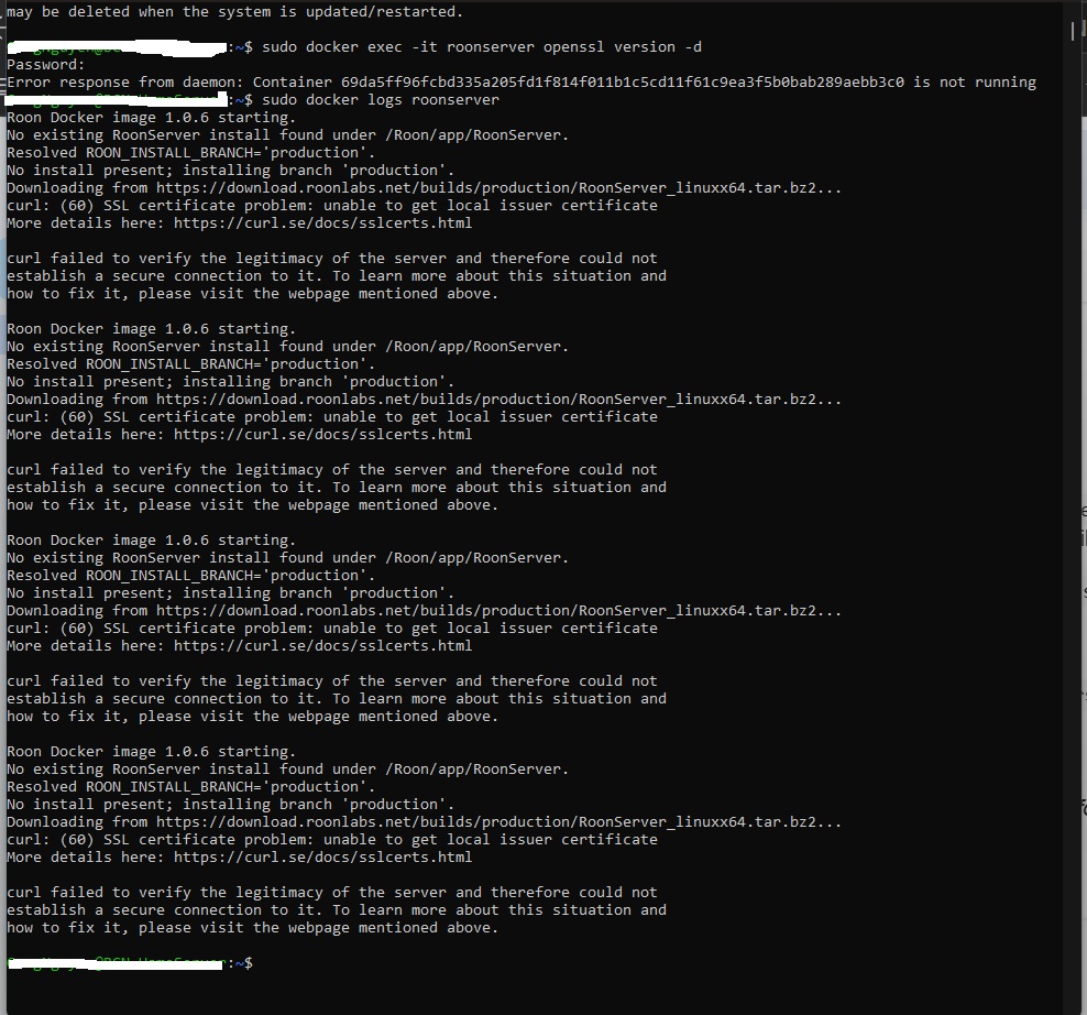

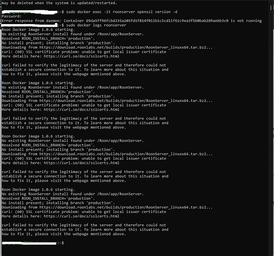

Dear Vadim,
Attach the log files as you requested. I don’t find a log file from Roon. Maybe the installation is not completed as curl (60) error.

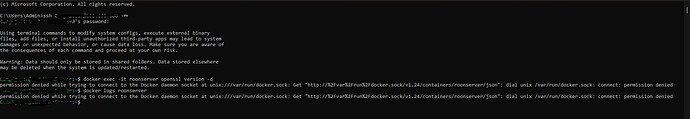

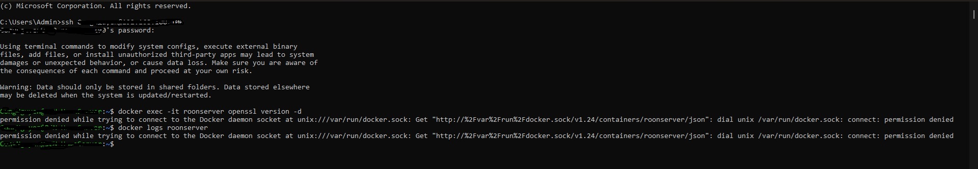

Hello @nguyenbc1973,
Thank you for providing that screenshot!
The permission denied while trying to connect to the Docker daemon socket error in your terminal indicates that the account you are using for your SSH session does not have the required administrative privileges to interact with Docker. This is a standard security restriction on DSM/Linux systems.
To successfully run those commands, you will need to use sudo (Super User DO) to grant the command administrative rights.
Please try running these exact commands instead:
  1. sudo docker exec -it roonserver openssl version -d
  2. sudo docker logs roonserver
(Note: When you run a sudo command, it will prompt you for your NAS password. As you type the password, the screen will remain completely blank for security reasons—just type it in and press Enter).
Once you have the output from these corrected commands, please share it here so we can see exactly what is happening inside the container’s environment!
Dear Vadim,
It is same as above mentioned on begin. Nothing in Roon directory caused by it did not download installer from your side. Once again, if I download the tar file, then tar into Roon directory, it starts then stop immediately.
