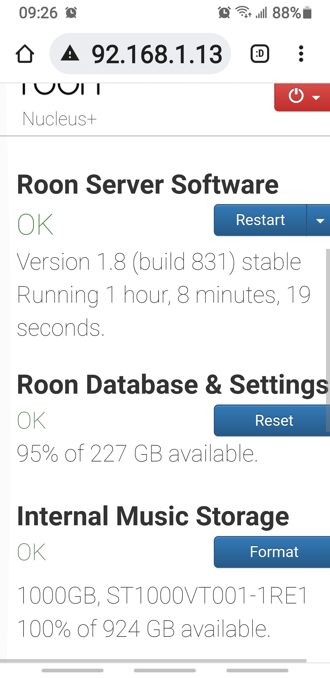

My server software keeps resetting itself in Nucleus+ constantly interrupting P/B, and when I’m not listening as well.
Please refer to attachments. I have rebooted all too.
UPDATE
Awoke this morning and found overnight the server software reset itself again (see attached)

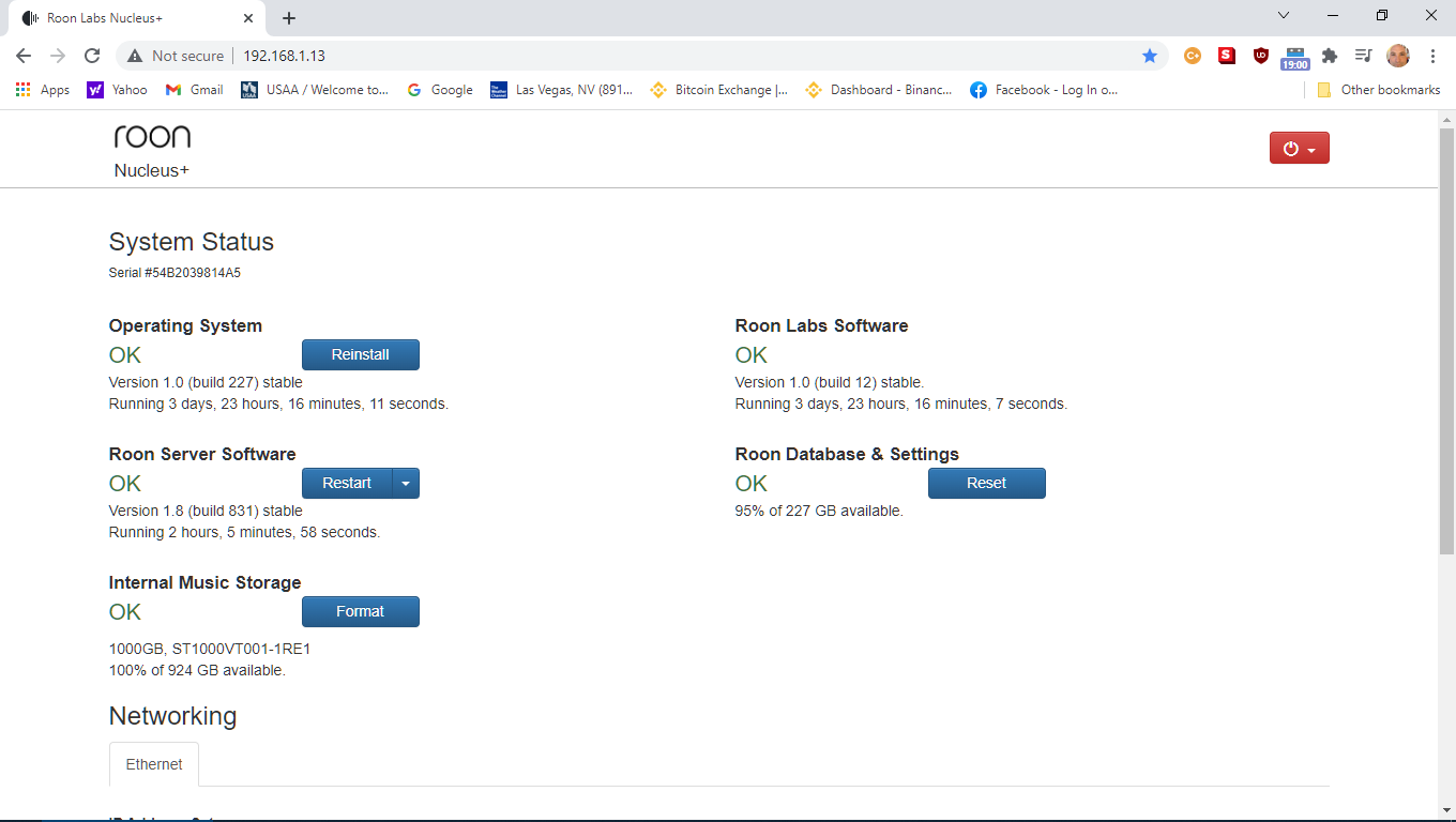

This has been an ongoing issue since day 1. I’ve gone as far as replacing the NucleusPlus as well. Please review these same past issues as well
Just some more information
This always seems to occur when the database reaches 96% now at 95% or when the database capability is about to make a change.
