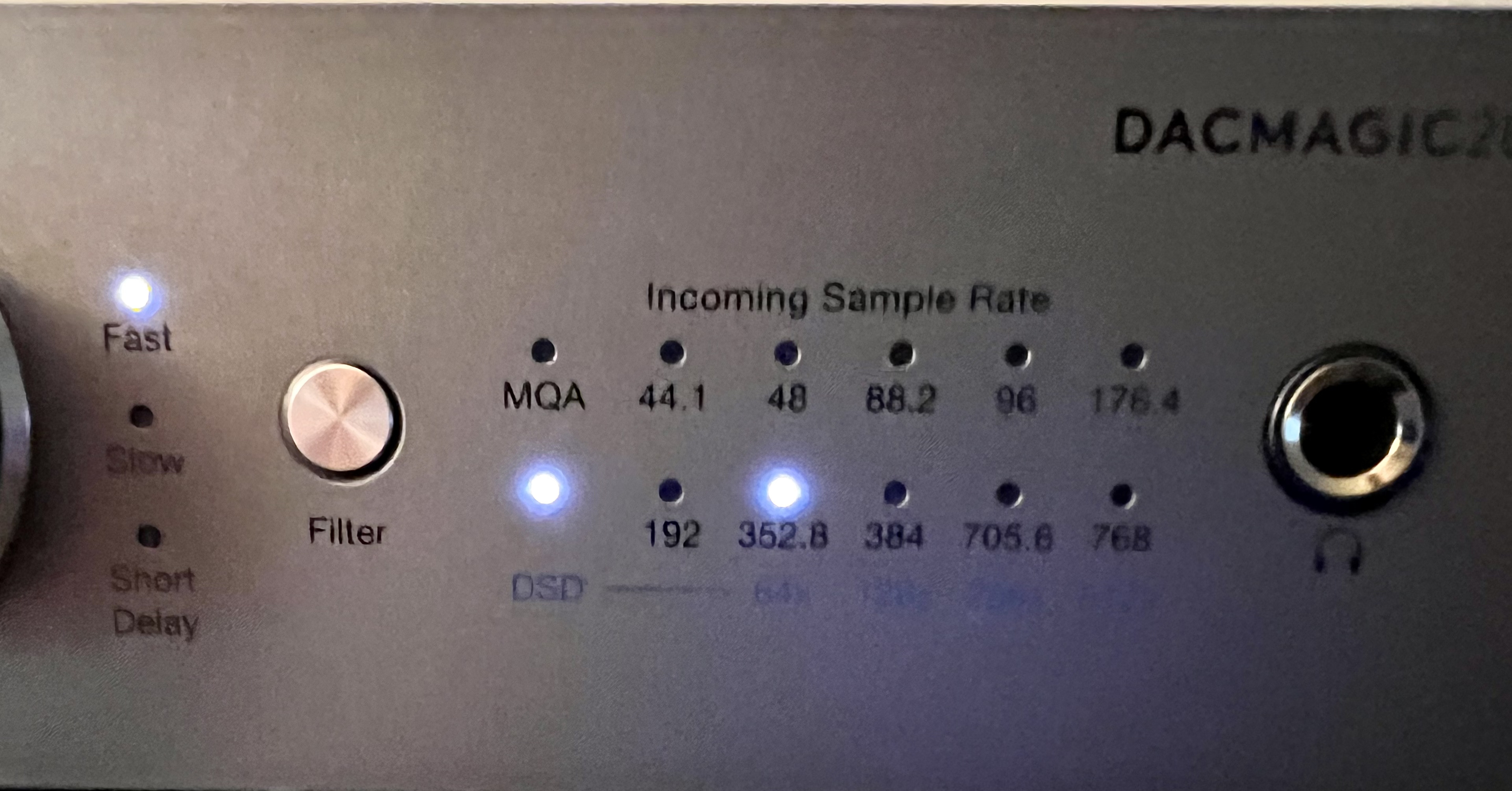

This definitely appears to be the case. My eyes and ears tell me the native file is coming through. The sound difference is obvious. There is no DSD handling option in the CXNv2 because it converts everything to PCM and upsamples everything to 386 Hz. This is what always shows in the Roon signal path (see attached). I have also attached an image of the Dacmagic showing the actual MQA file as passing through.
You are correct Ben. It was a DSD 512 file but the Dacmagic was showing only 64. Since the CXNv2 does not seem to have a USB out to go to the USB in on the Dacmagic that is the current limit. I think your explanation fits my theory, however, in that Roon has no way of knowing the true endpoint.

You didn’t post a DSD source.
What’s interesting with the images you posted is that the Dacmagic has received MQA signalling and the original sample rate, i.e., MQA 48 kHz.
Surely, this implies that the S/PDIF output of the CXN bypasses the internal DAC, and therefore any upsampling.
That is the case , The CXN will report back to Roon what it is doing in the DAC/Analogue outputs hence the 48=>384 up-sample this is standard in CA DAC’s. We have seen many instances of that here. All CA DAC’s have done this for years back to the original DAC Magic 100.
The CXN’s Coax and Optical Outputs are NOT adjusted in any way , what goes in comes out. So no up-sampling.even though Roon reports it as that signal will be fed to the DAC as well, even if not output to analogue.
