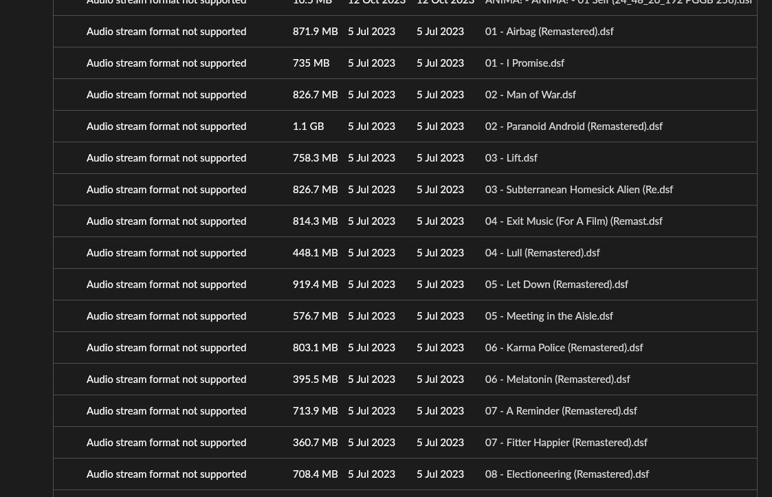

I was trying to load some DSD files into my library last night. They are all in .dsf format. I put them in their own folder so I could easily find them. After pointing roon at that folder I noticed they weren’t showing up in my library. I found they were actually skipped under the skipped files section and it shows audio stream format not supported. I don’t know what could cause this.

Does this happen with DSF files are just these new ones you added?
Those DSF files are ridiculously large per track. They appear to run ~25 Mbps, thus are not DSD64. On the other hand, they are not large enough to be DSD1024, which is not supported. Perhaps they are DSD256x48, which I believe also is not supported.
AJ
Even on SACD conversions from ISO to DSF its the same
