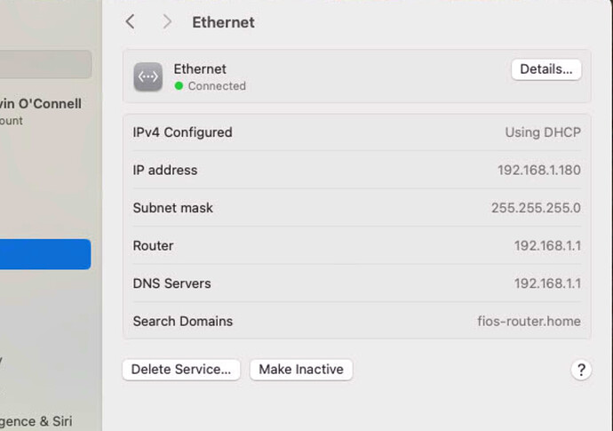

What @connor is asking you to do here is change the settings on your computer to only use 1 ethernet port. To open these settings, choose Apple menu > System Settings, then click Network in the sidebar. (You may need to scroll down.) That page will show you a list of your active network interfaces. You can switch off an interface by clicking it and switching off the toggle. Do that for all of them except an ethernet interface.
That takes care of the single ethernet connection part. Now let’s address subnet. For this you will need to go to your router settings. Compare the IP addresses of your Roon server machine and your client controllers. Ensure that the second to last number is the same for all of them (as an example let’s say an IP address takes the form of AAA.BBB.C.DDD you want to make sure that the C is the same in all of the addresses). If it isn’t you will need to change your router settings under DHCP and set an address range that is all within the same subnet.
I hope that this explanation clears things up for you. If it doesn’t please let us know and we will continue to help you out.
Hi Daniel,
As I understand this, I have switched off Wi-Fi on the Mini, and am still connected to the Linn DSM via the ethernet/splitter connected to my Airport Express. All of the IP addresses appear to have .1. as the second last numeral.
My control devices are iPhone, iPad and MacBook Pro. The phone appears to be able to access my Library, Qobuz and Roon Radio.
I will give this a try in a bit.
Thanks for the guidance.
Best,
Kevin

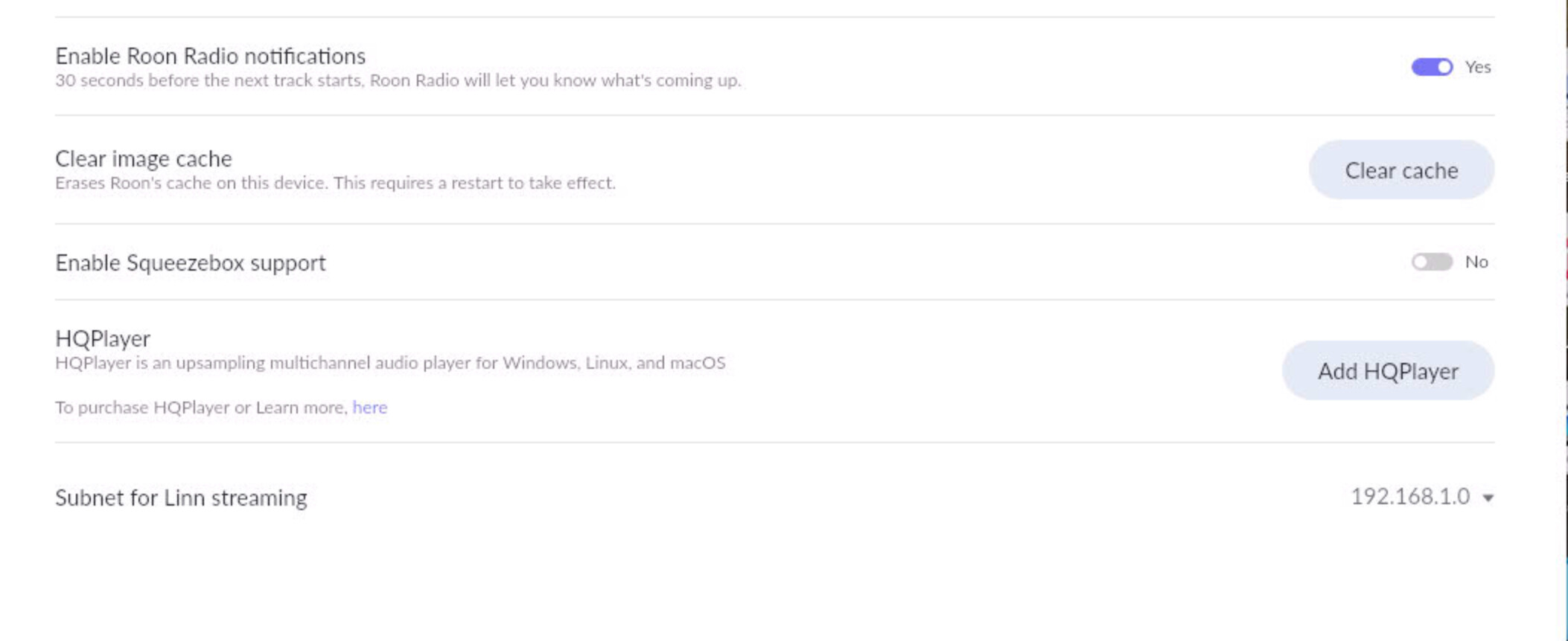

Hi Benjamin,
Roon has been running pretty smoothly until yesterday’s update. It has changed the Linn Subnet from 192.168.1.0 to 127.0.0.0. As soon as I tried after updating, it failed to find my streamer.
It seems to me that I should be able to type in the Linn IP address to direct Roon.
EVERYTHING IS OK!
I fixed it by switching everything off/on and restarting the Core Mac Mini. Thanks.
