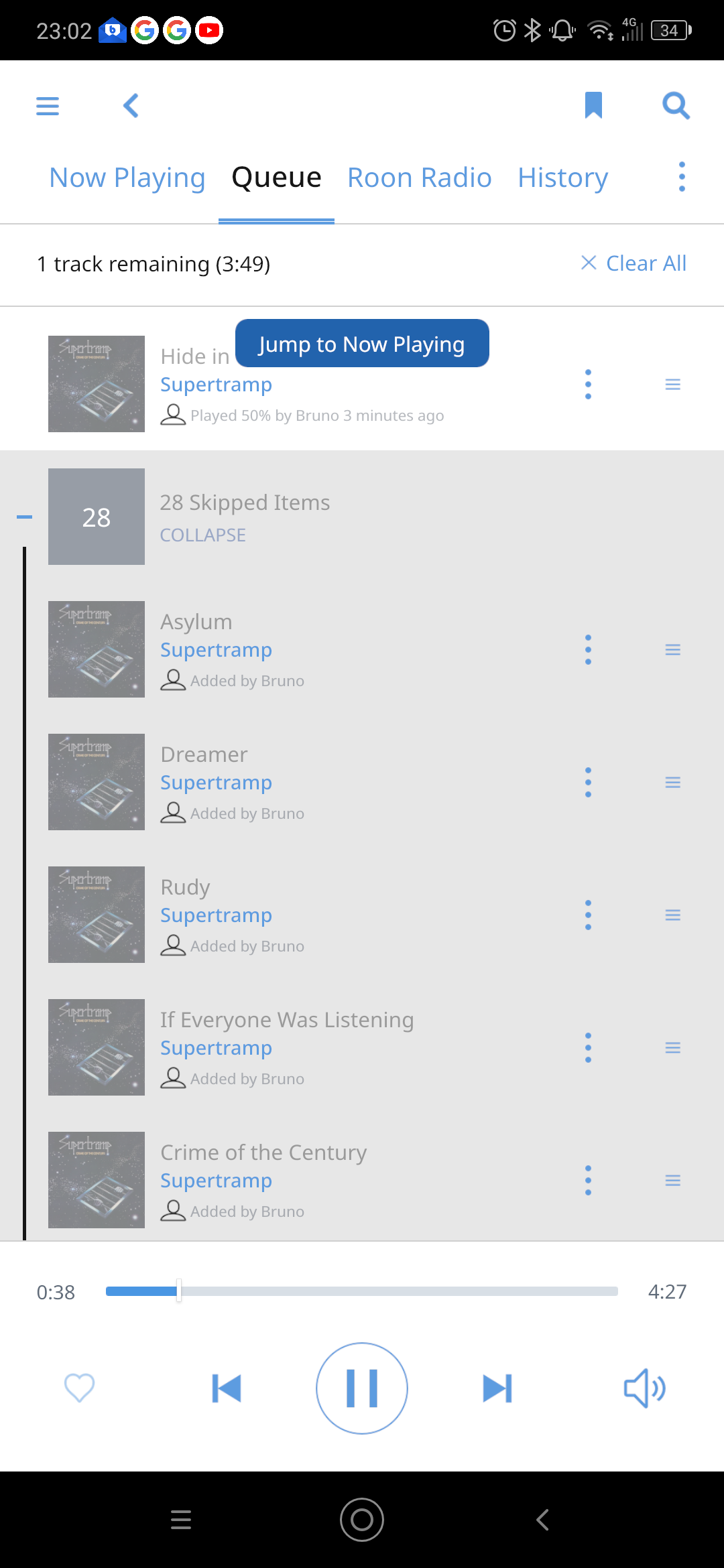

Just installed and setup Roon Core in my Windows 10 PC. Same problem after 2 tracks. It took 28 skipped tracks to be able to play another track.
