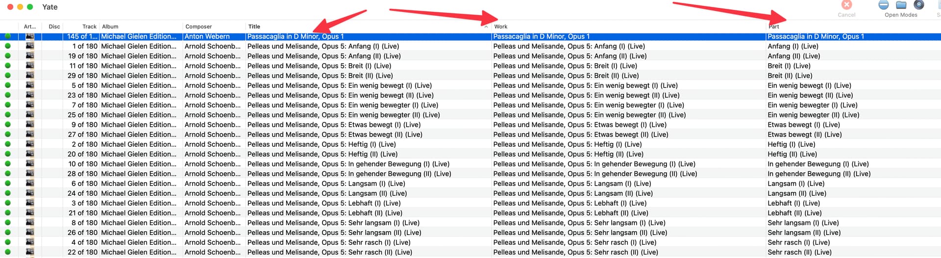

Hmmm. This is how they look in Yate before import:
I did also set the Genre field to ‘Classical’.
But all to no avail by the looks of it. Any idea where I’m going wrong, please?

Your WORK tag is incorrect. It is the part before the colon in the TITLE tag. So it is simply:
Pelleas und Melisande, Opus 5.
All track items referring to this WORK should be identical. Roon will try and match it with the canonical form on allmusic. So normally I just paste that in to save a lot of bother:
Pelleas und Melisande, symphonic poem, Op. 5

You have 22 recordings from roon’s perspective because it is treating each track as a WORK, not as a PART. There must be something wrong with your work/part edits. The display on the album page should be hierarchical like this. What do you see? I have highlighted where the Classical tag should appear:

And of course as soon as I re-edited to get Work as you said it should be, it was:

Your composition is still not identified properly. Roon was not able to match your composition with the allmusic canonical form. You should be seeing +/- 70 performances from your streaming partner, not 4. If you click on the library or disk icons you should land on this page:

The quickest fix is just to use the allmusic canonical form for the WORK tag as I suggested. None of your 4 compositions are properly identified.

This is not rocket science. Just cut and paste the canonical form into all 11 WORK tags in Yate.
