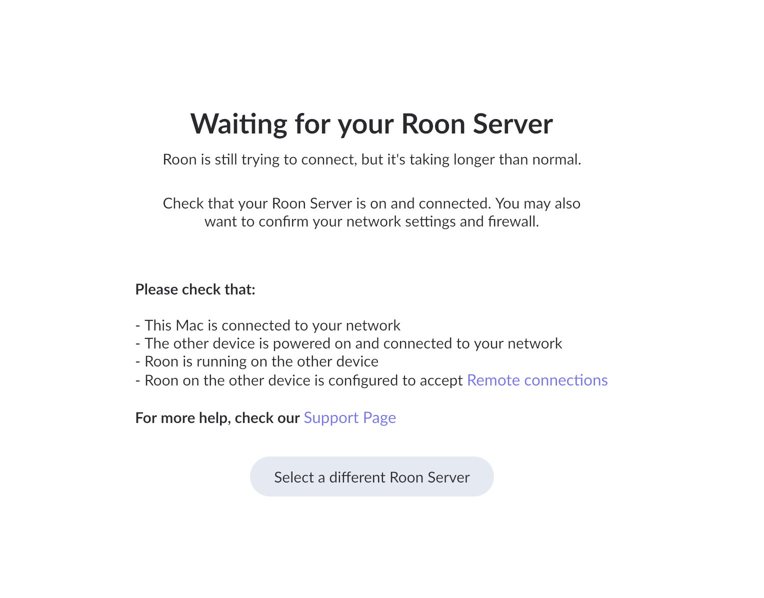

First my Sonos audio devices kept dropping off. Now, I've restarted my laptop (Macbook Pro) 4x and Roon won't even start up. all I get is this message: "Roon is still trying to connect but it's taking longer than normal..."

Are you using the same MacBook as the Roon server? Could you please confirm whether the Roon icon appears in your system taskbar?
Also, have you tried clicking on “Select a different Roon Server”? If so, do you see any available servers listed there?
Let us know — we’re here to help!

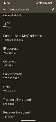

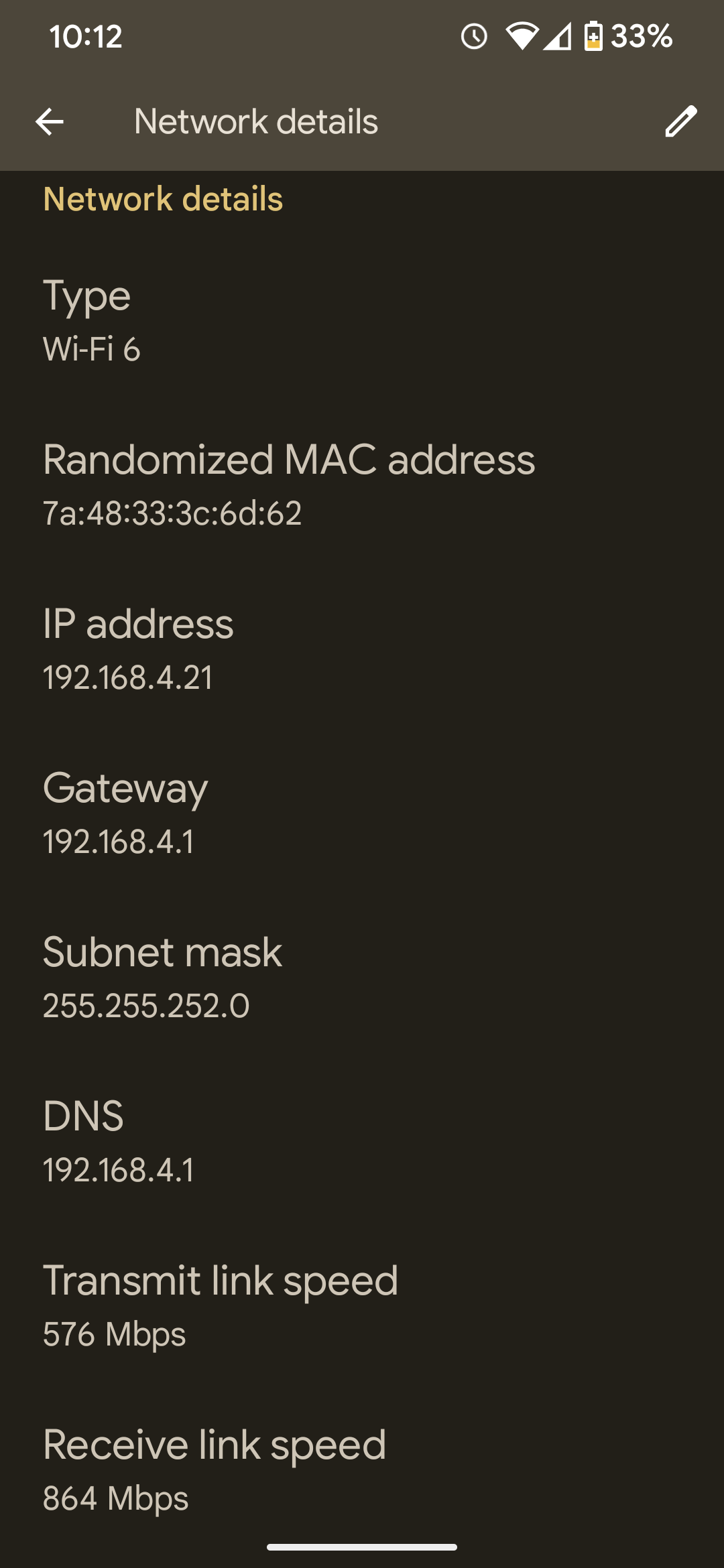

Hello @Noelle_Cleary,
Thank you for providing the screenshot from your Android device.
To better assist you, it would be helpful to review your router’s configuration. Could you please share more details about your current network setup (e.g., router model, how your devices are connected — wired or wireless, any switches or access points used)? This will allow us to guide you on exactly what should be checked or adjusted.
Looking forward to your response!

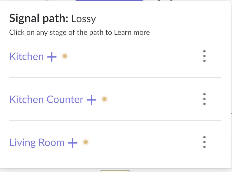

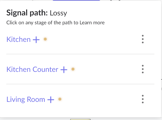

I don’t see the other network. How can I figure out what that is? Also this is new;
The “other network” doesn’t necessarily refer to a separate WiFi network — it could also be a wired connection coming from your ISP’s router, a mesh system, or any other part of your local network infrastructure that might be segmenting devices.
Regarding the “new” icon you’ve noticed, this is part of Roon’s Signal Path feature, which provides insight into the path your audio is taking from source to output. You can find more information about how this works in our documentation here:
:link: Signal Path – Roon Help Center

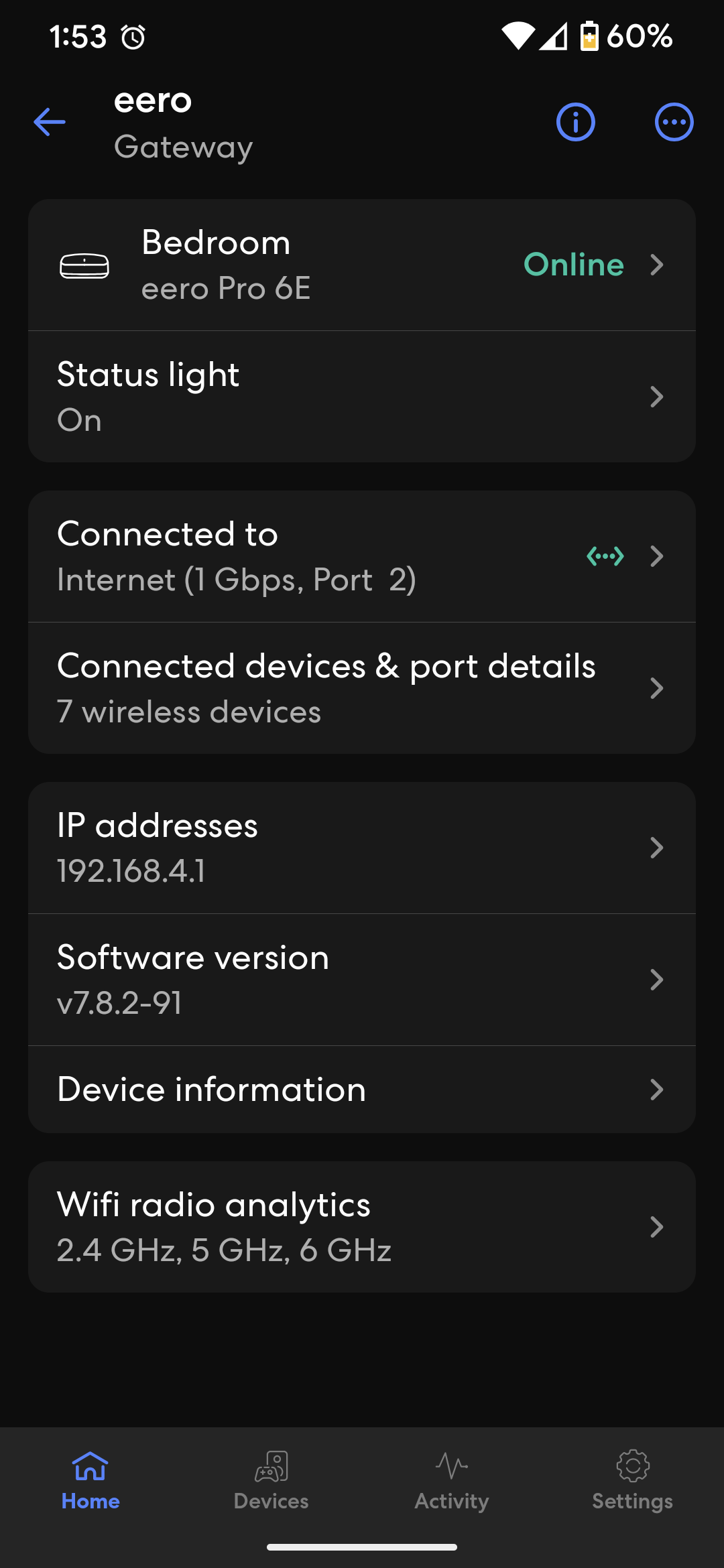

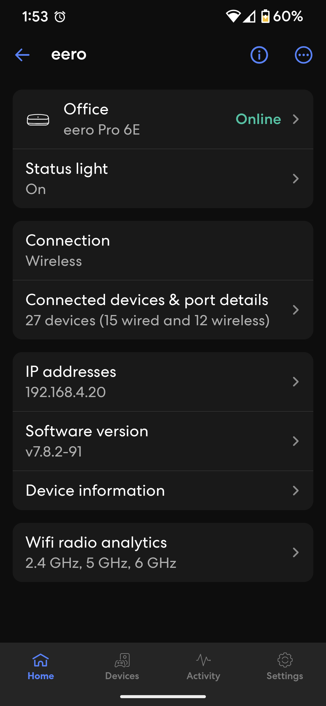

Here’s the info on both routers from eero app:
Hi @Noelle_Cleary ,
For eero routers specifically, I’ve noticed reports in the past where they created separate subnets for some reason, different than the needed subnet to ensure that all devices for Roon can communicate properly. One workaround which I’ve seen is for clients to set up reserved IPs for the Roon Server and audio devices, to ensure that everything is on the same subnet. Are you by any chance able to set this up on your end, and if so, does it help solve the issue?
I can do anything with specific instructions. But if I have to figure it out on my own, probably not. What do you suggest?
Hi @Noelle_Cleary,
This article will show you how to set a reserved IP address in eero. You’ll need to make sure your server and audio devices are in the same subnet range. If you want to know more about how subnets you can check out this article.
OK I reserved the IP address for my Roon Server in eero app. The speakers continue to regularly drop off/stop playing. what else can we do?
