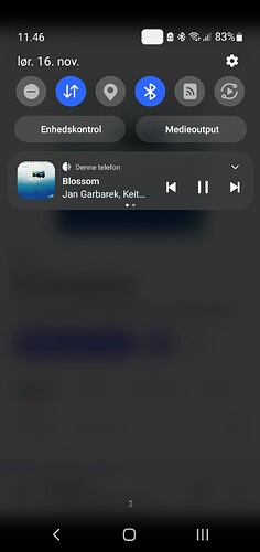

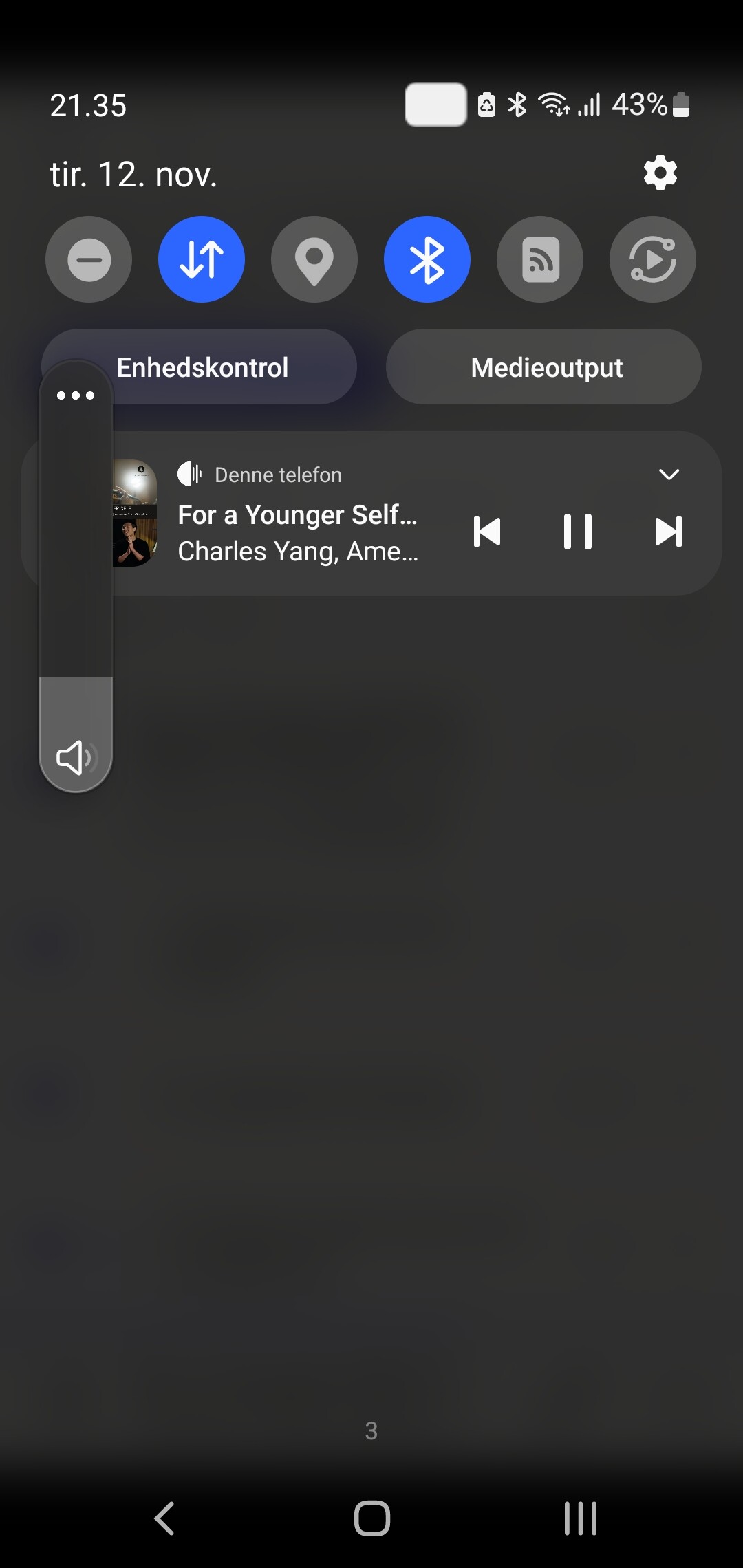

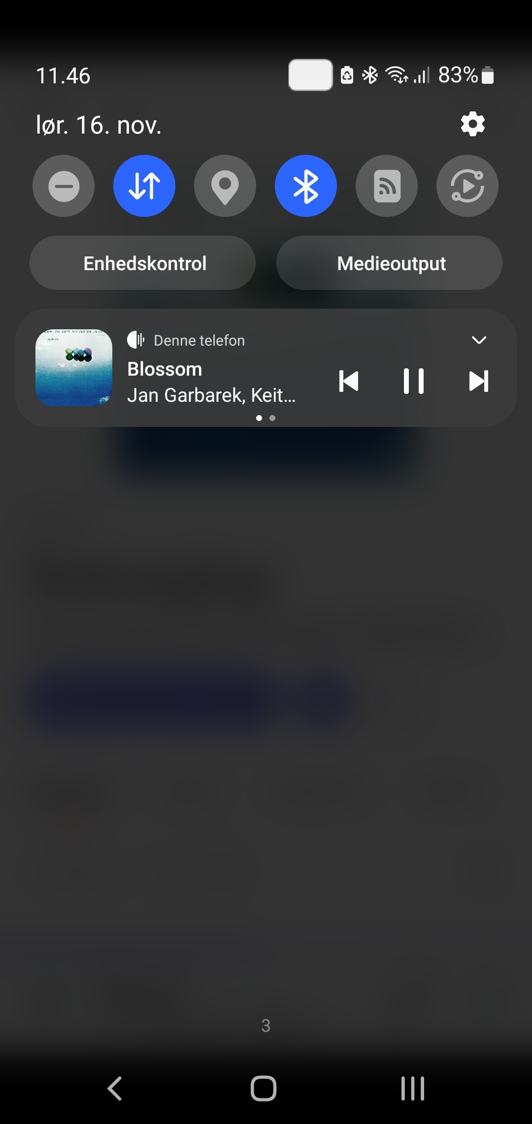

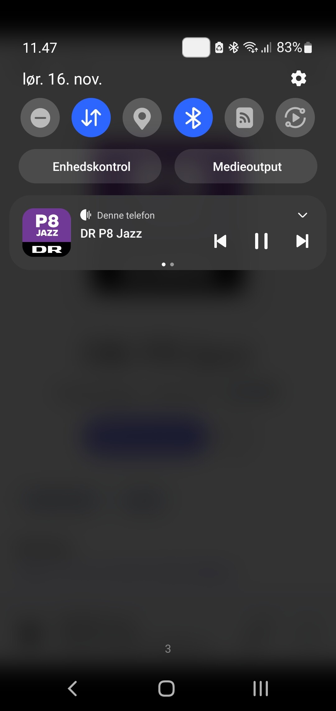

Can you share a screenshot of your lock screen controls for Roon?
You mean like this?
Hi @kassoe,
Thant’s the picture we needed thanks. We verified in our diagnostics that the pause command is being sent to your endpoints correctly. So the question now is why the Digi+ isn’t handling it the way you are expecting. You should bring that question to Hifiberry or the Tinkering section on community.
Hi @Daniel. I realize now that this is probably more a “it’s a feature, not a bug” issue. I assumed wrongly I was pressing a stop button in the drop down window, and - as you write - it is not, it is a pause button. In that sense, the behavior of the Digi+ is probably what can be expected. But why do you, in the Roon app’s drop down window, provide a pause button instead of a stop button? And which difference in functionality is there between the Roon stop and Roon pause buttons? And where else is the pause button to be found? I do not see it inside the app’s UX.

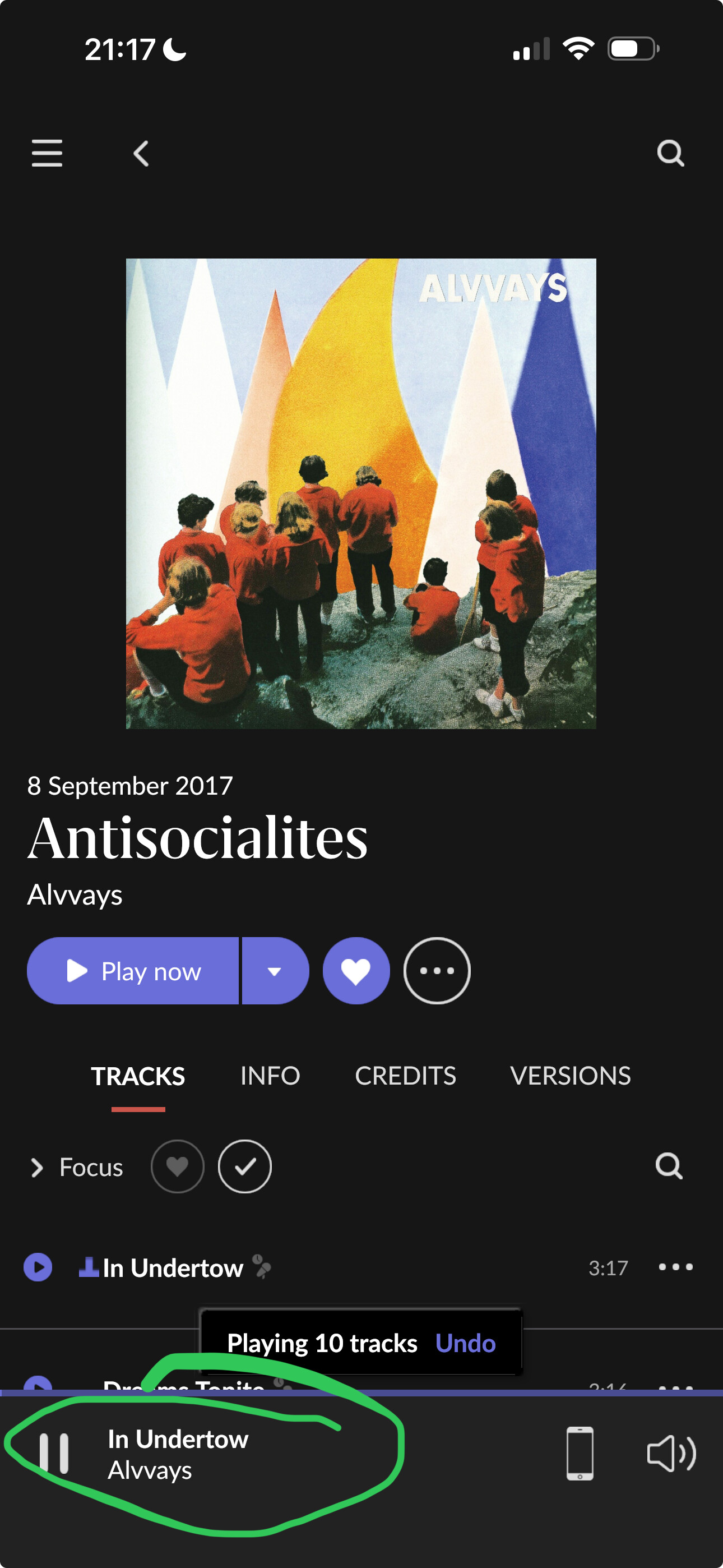

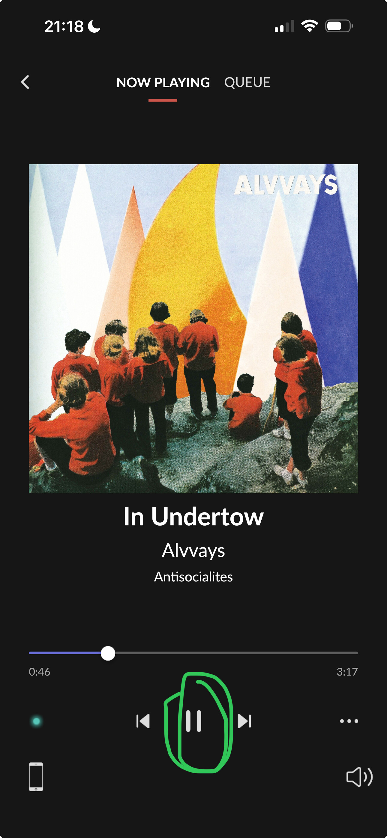

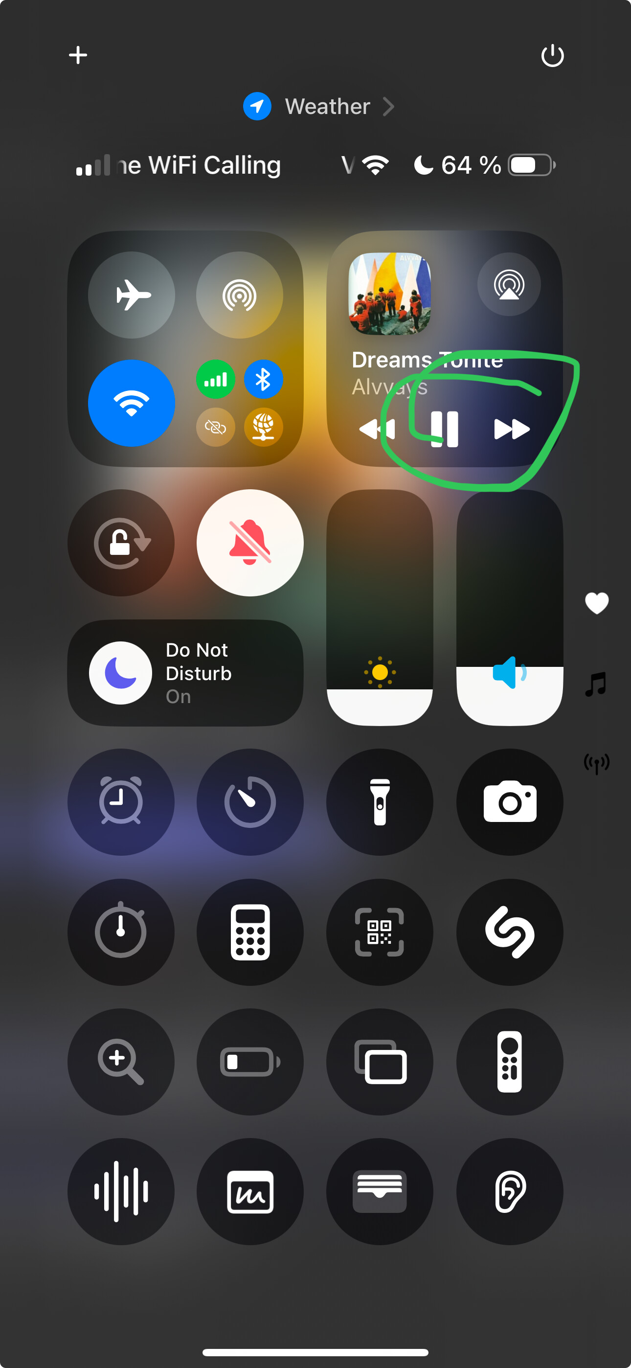

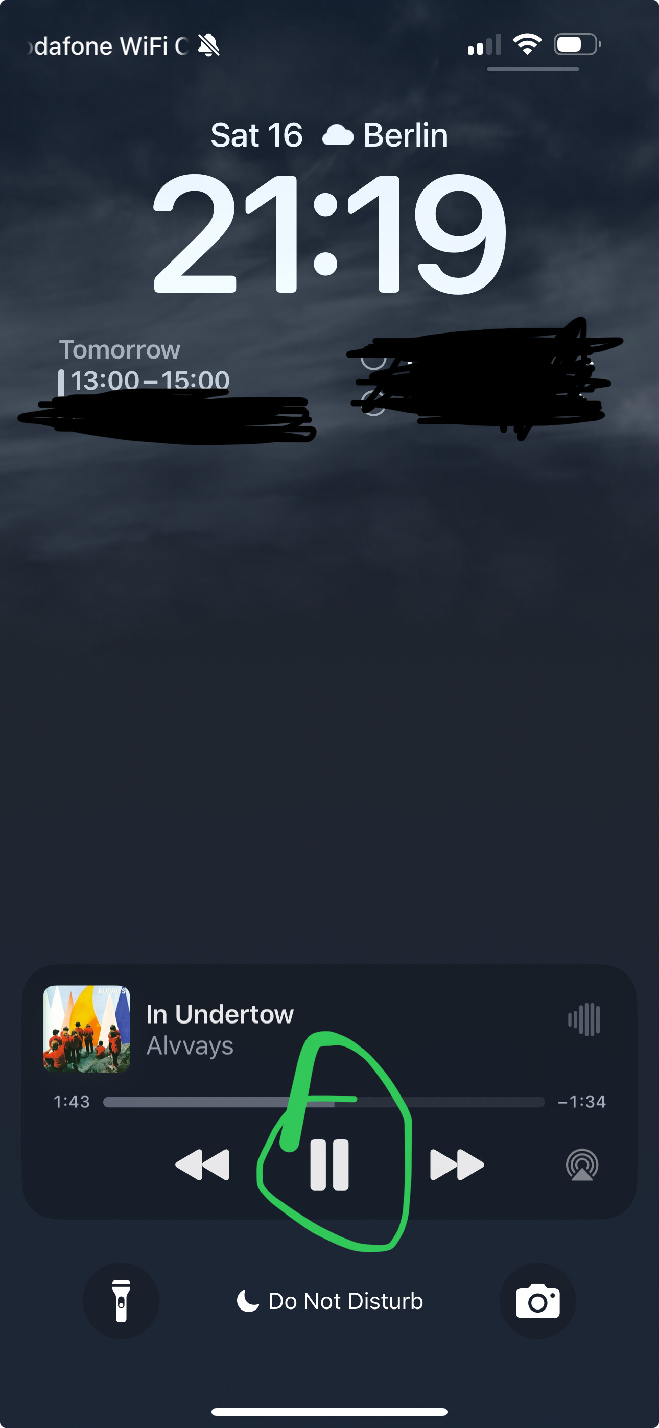

I don’t see a stop button anywhere in Roon, only pause buttons when a track is playing. E.g., in the play bar:
Now Playing:
On the iPhone Lock Screen:
In iOS itself, in the Control Center:

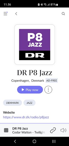

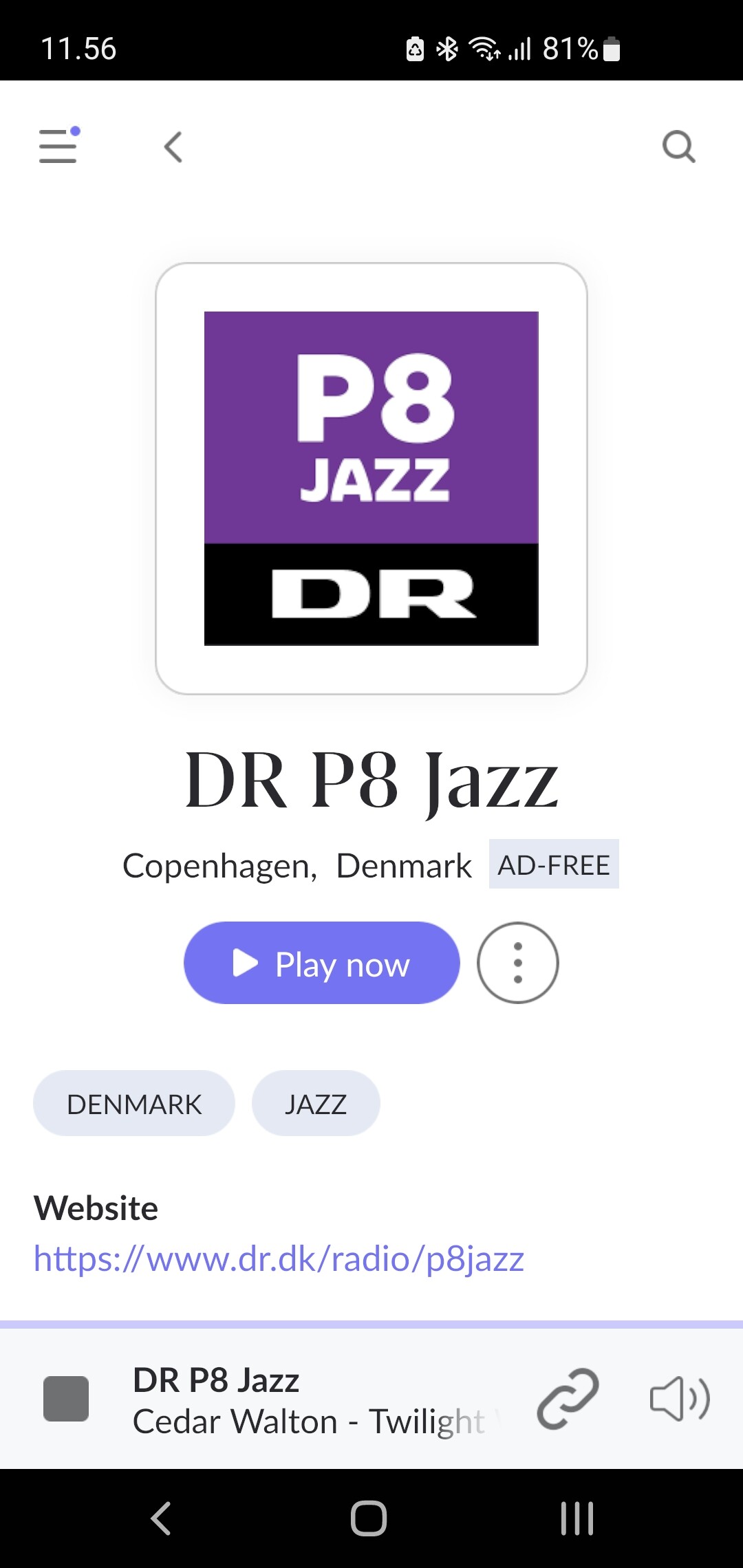

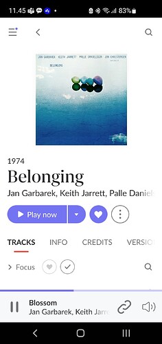

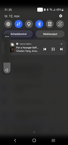

@Suedkiez, thanks - while tempting to say that “pause” and “stop” is the same these digital days, I’m not sure that corresponds to what actually happens in the Roon app. And I do have a “stop” button inside the Roon app when the source is a streamed radio station. Below I show for screen shots, only one of which has a “stop” button (the DR P8 Jazz inside the app), the three others have “pause” buttons. This does, however, not explain the difference in behavior of my optical output.
@Daniel, testing again I think I now pinpointed the difference in behavior:
  • When the source playing is a local file or an album from Qobuz, the app’s pull-down pause button does indeed stop the optical output properly.
  • When the source is an internet radio station (I have tested with DR P8 Jazz and BBC 3), the pause in the app’s pull-down menu does not properly stop my optical output (it stays alive instead of letting my amp go to sleep as described initially).
