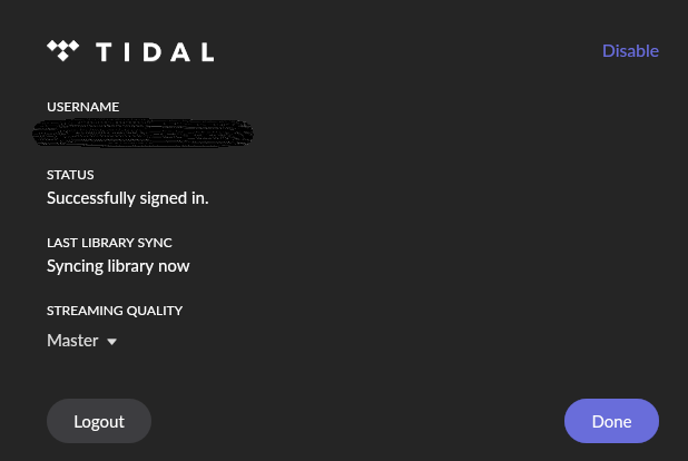

Roon keeps saying it’s syncing Tidal:

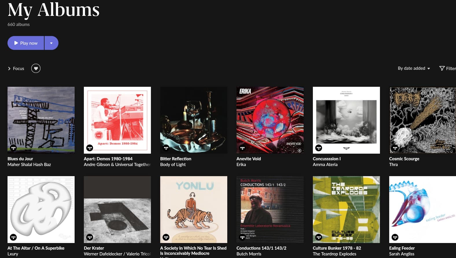

Albums counter stopped at 660 (should be around 2.6K)

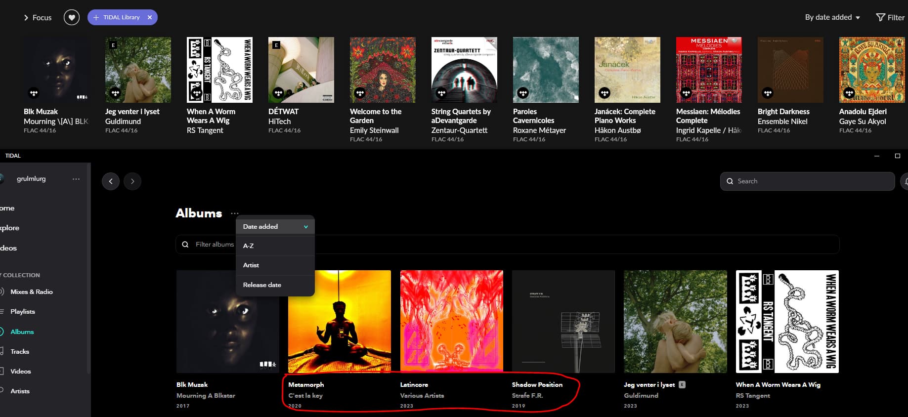

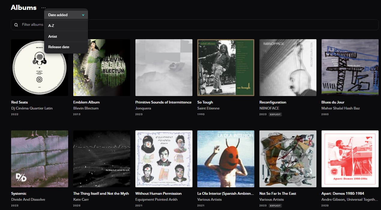

Tidal favs in Tidal app still != Tidal favs in Roon. See sorted by latest additions (Roon vs. Tidal):

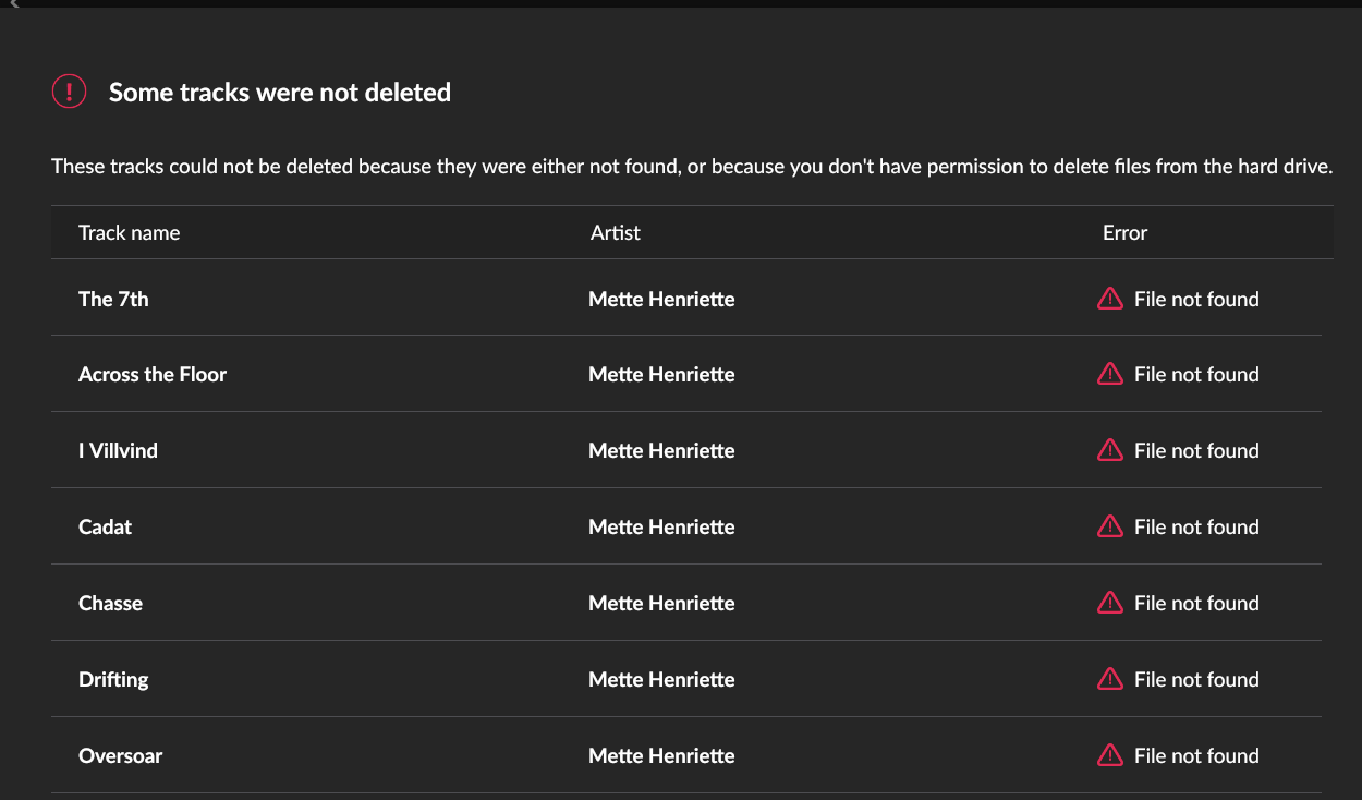

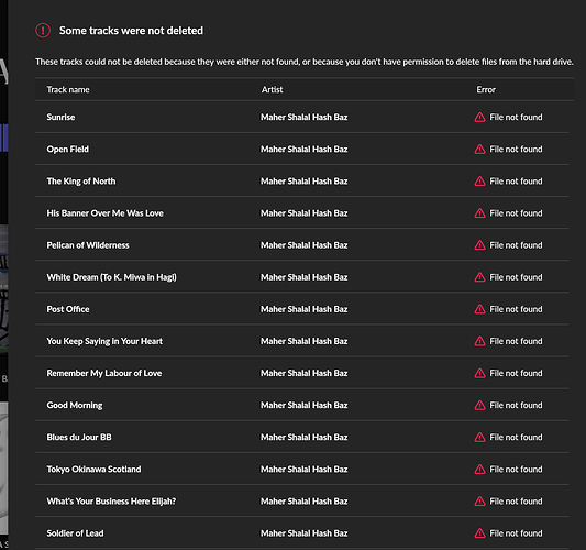

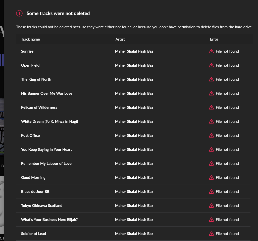

When trying to delete a Tidal album using Roon:
(it is currently in my Tidal favs and I can unfavorite it using Tidal desktop without issues). -

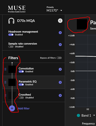

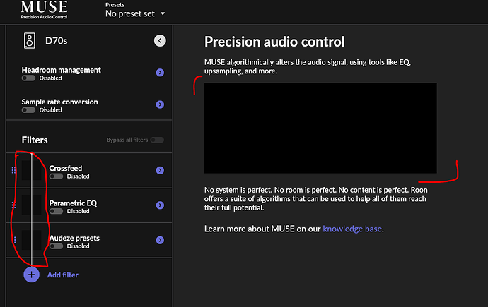

Finally, the icons in the DSP page did not come back:
To sum up, all that was broken remains broken. Looking forward to your assistance.

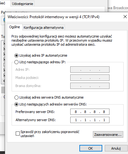

With that, have you tested out changing your DNS settings to Google (8.8.8.8) or Cloudflair (1.1.1.1)?
DNS changed:

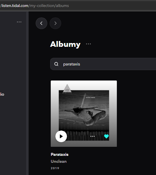

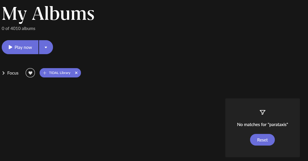

Favs still out of sync. This is in my TIDAL library (added months ago):
Not found in Roon:

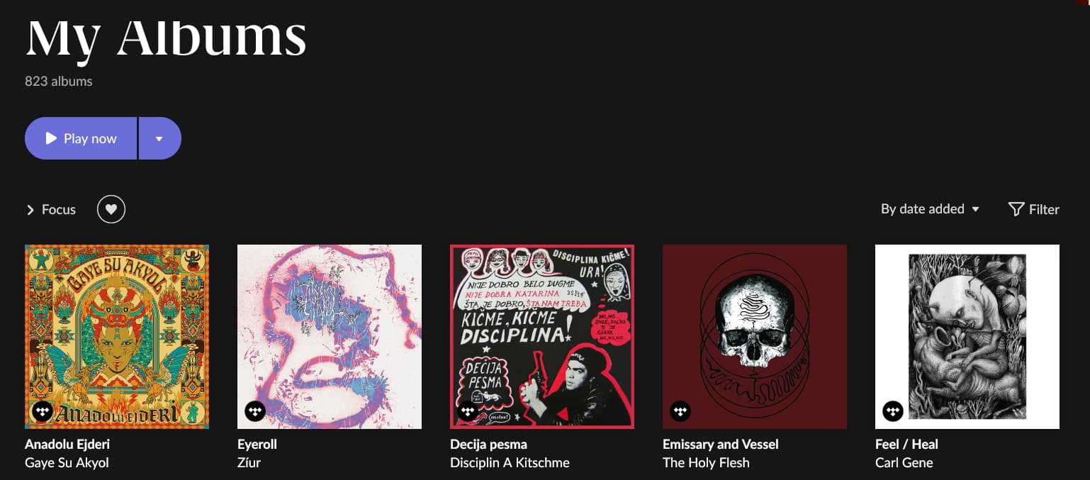

Yes, tried that, not much improvement. Moved the core a to a PC that’s connected via LAN, left in online for ~10 hours. Roon managed to sync 823 albums and the counter stopped:
Trying to remove an album that was in my Tidal favs at that moment would still produce the ‘File not found’ errors:
The cache refresh didn’t help either, the sync is still spotty. See latest additions side by side, notice how Roon misses the ones I circled in red:

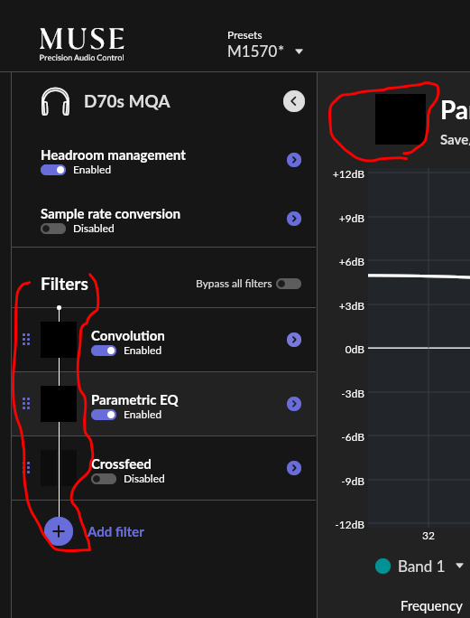

Only thing that didn’t start working are the DSP icons:
You have my extreme apologies for the long delay in responding to your last comment. I’m glad to hear you’ve since been able to sync your Tidal collection properly!
Are you still experiencing issues with Muse icons? Does this happen no matter the remote device?

Wrt icons, let me check on my other PC and report back.
