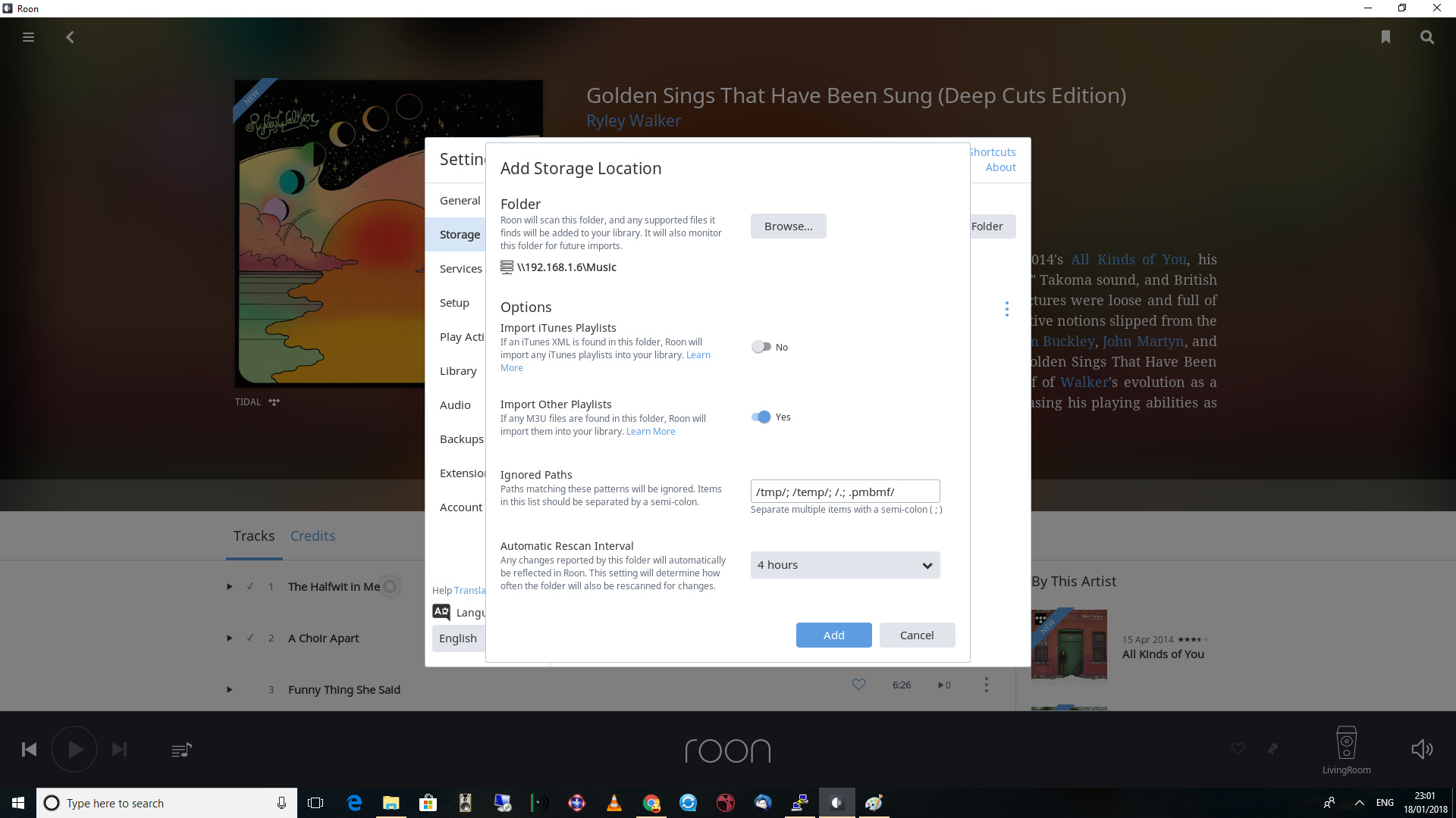

How do I change the frequency of the rescan period.
thanks @RBM
Hmmm, That box only appears when adding a brand new folder, it does not appear when I edit the existing storage location. That means i would loose my current library and have to completely rescan or restore it.
Are you sure? I made the screenshot when editing a network share that was already present and active
100% no scroll bar to reveal it either.
add a fresh one as if by magic.
Your first one looks like storage local to your Core, the second one is a network share. I believe auto rescan intervals are only available for the latter.
It’s not actually on the core, it’s the Nas mounted by the filesystem not Roon. That explains why it does not show up then if it’s purely for network mounts via Roon. As I said this always worked until the latest update so it’s odd it doesn’t now and nothing changed.
You aren’t getting that option since current folder was added as a ‘local’ watched folder. You can try adding same folder as a network watched folder (Roon will be handling communication with the NAS).
