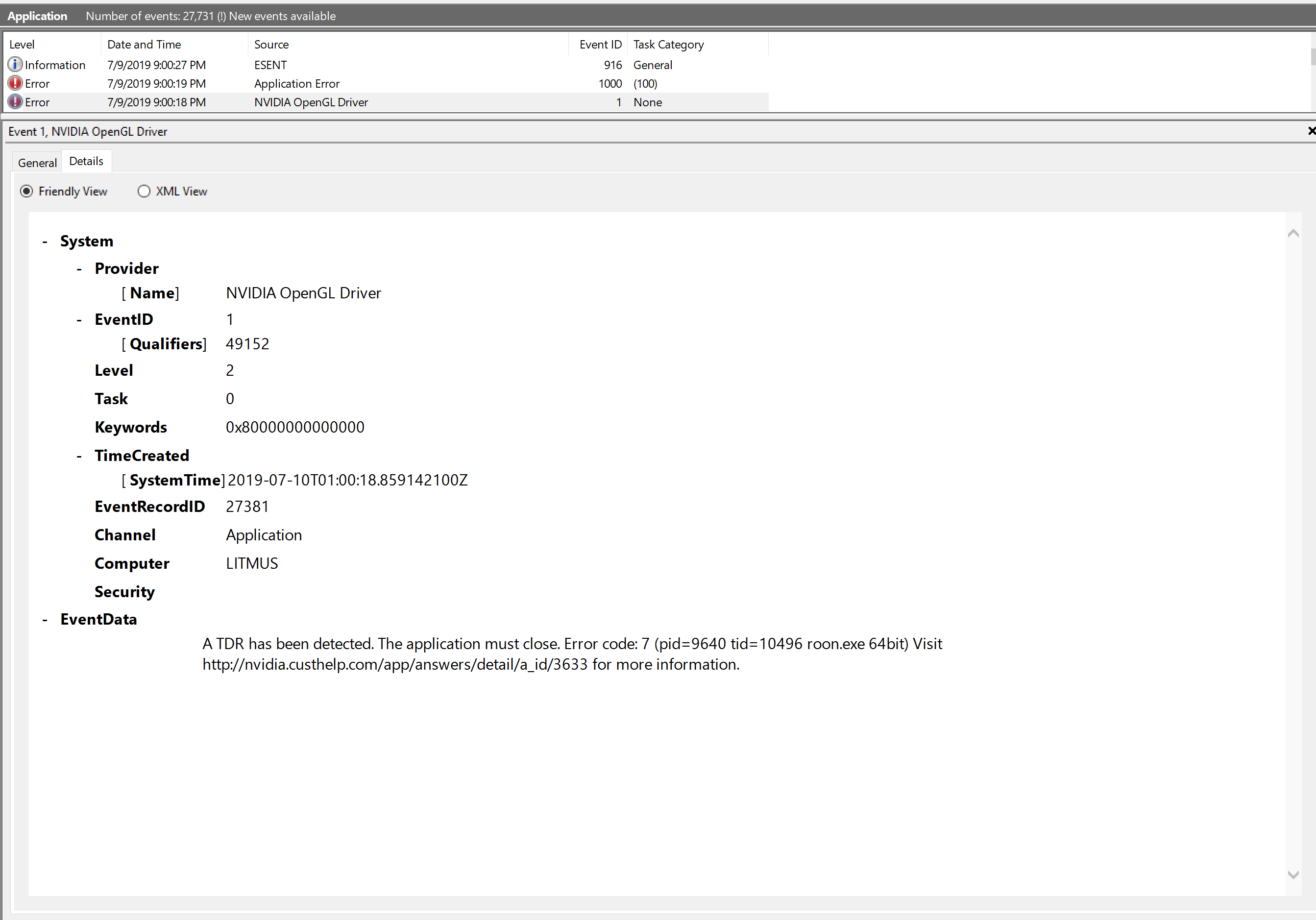

Our next step here would be to check Windows Event Viewer to see if there are perhaps any clues in that regard. Can you please check for any application errors related to Roon on the 9PM July 9th crash and if there are, can you share a screenshot by using these instructions?
I have attached two screenshots showing the two errors that occurred within 1 second of each other.
Hi @David_Robinson,
From the application error you posted, this issue appears to be related to your graphics card.
