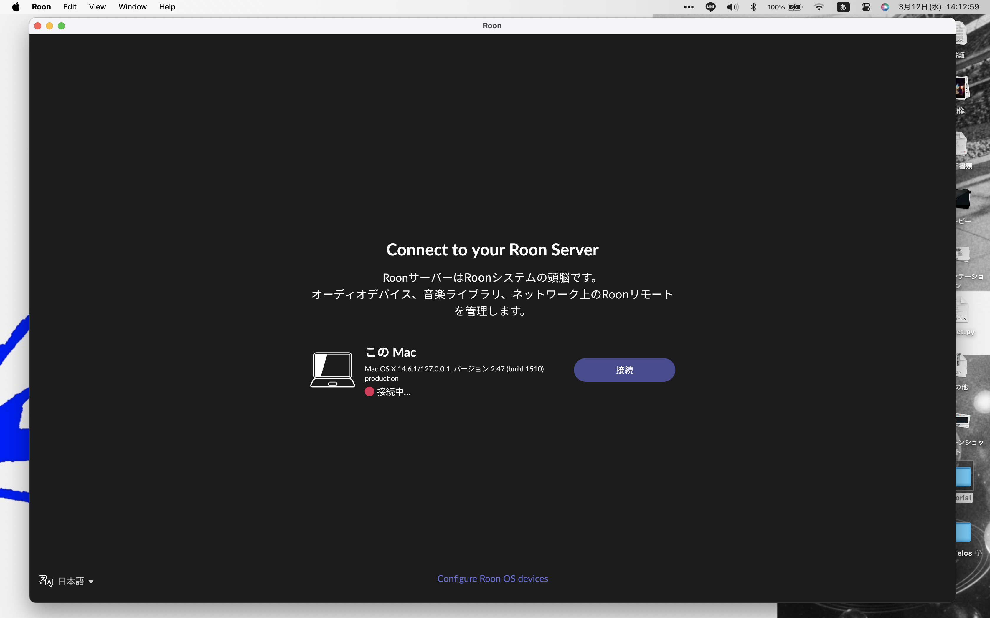

Roon stuck in 'connecting' state with red mark on startup (ref#I914ET)
Is Roon Server running?
As soon as it starts up, it stays in the 'connecting' state, with a red mark constantly showing, and I can't press the connect button.
I don't know the details. This problem occurred after the free trial period ended.

As a first step in troubleshooting - I see you’r running both Roon and Roon Server on a Mac, can you verify your Mac firewall settings have listed Roon as a proper exception? An easy and quick way to test this can be to temporarily disable your mac firewall, reboot Roon and Roon Server and see if you can connect.

In your original screenshot, RoonServer itself doesn’t appear to be running as a background process in the Menu Bar, but it might be listed in the dropdown. Can you confirm that RoonServer itself, and not just the GUI, is open? Check in the Activity Monitor (Applications > Utilities > Activity Monitor).
On an all-in-one device hosting both Roon and RoonServer, you’ll still need both applications running. Roon connects to RoonServer on the same device as if it were a remote.
Additionally verify that Roon has local network access in your Privacy & Security settings on MacOS.

Thank you for your support. Following your advice, I restarted my Mac and checked RoonServer, and it’s now working properly. I’ve also granted Roon local network access permission in the macOS Privacy & Security settings.
