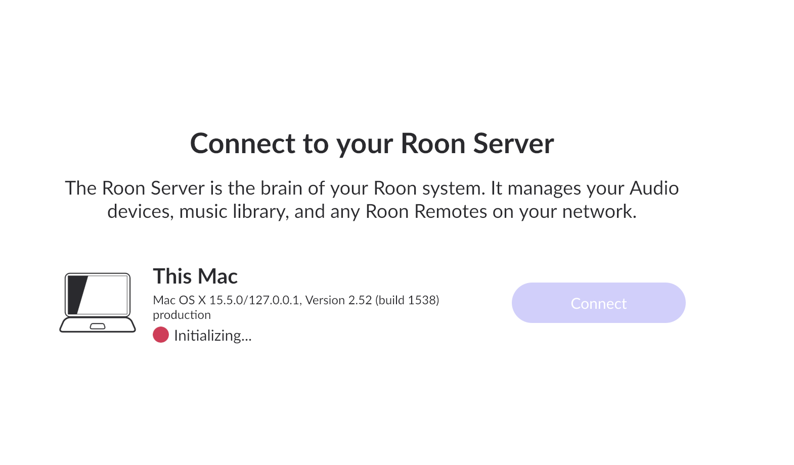

Roon stuck in startup after restoring backup from QNAP to macOS (ref#NEME16)
after restoring a backup made on QNAP on a macos device, roon stuck in startup

rebooted and re-installed roon on the mac a couple of times this used to work perfectly when running on the qnap device - i just need to sunset this one.
